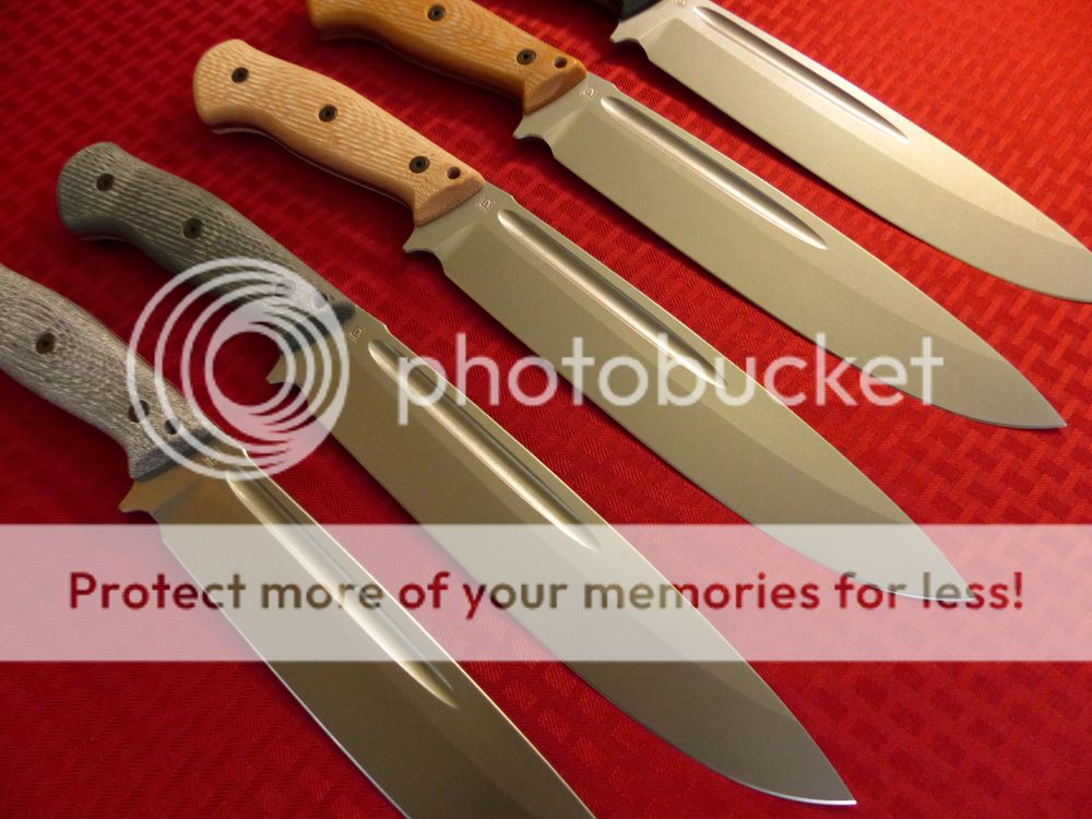

The Light Chopper was a collaboration with Lorien Arnold. It is an exercise in geometry, weight distribution and ergonomics to make a light weight well balanced chopper that hits well above its weight. It's a large woods knife, with a ~10" blade that weighs 17.1 oz that is somewhere between a machete and a camp knife. It's light enough to be carried on a long hike without weighing you down and it's engineered for performance when you go to use it.
It's made of CPM 3V at HRC 60.5 with the newest heat treat for 3V that I (Nathan) believe is the finest heat treat for this material available anywhere. The performance is phenomenal with a combination of toughness, edge durability and edge retention that will blow your mind. A lot of R&D went into developing this heat treat, it is truly different and better.
With that in mind Nathan gave it a relatively thin cutting geometry designed for cutting performance. This is not some overbuilt pry bar, it cuts like a demon, but it is very durable, see 2nd video.
It's light enough and long enough to develop tip speed to cut thinner vegetation that heavy choppers struggle with. But when you put it to work in the big stuff you'll find that it hits hard and bites deep and it won't wear you out. The grip and aspects of the cutting geometry were designed in collaboration with Dan Keffeler.
The hand grip works great as a camp knife when held towards the front with good balance and dexterity. When held towards the back it fully fills the hand and offers control and reduced hand and forearm fatigue for extended hard work.
It has a forward lanyard hole (as used in competition cuts) and a hidden rear lanyard hole.
These are available in natural or black micarta. Nathan normally buffs the scales, but some people prefer the feel of the scale in matte because it has more grip and the fuzz works better with hand sweat. Unbuffed scales darken from hand oils pretty quickly. Buyer specifies which finish and colour they want.
These are also available in TeroTuf. This material is on the competition cutters that are winning championships. It isn't especially pretty or even as dimensionally stable as other synthetics, but nothing else offers a grip quite like it. If you're out there cutting for extended time and your hands are sweaty and slippery you'll appreciate the grip and feel. I have laminated it to black micarta with black Acraglas for dimensional stability.
Be aware, the unbuffed materials aren't about pretty. They will get a little funky looking before they break in but will even out with use.

Buffed Micarta:
Matte Micarta:
TeroTuf:
