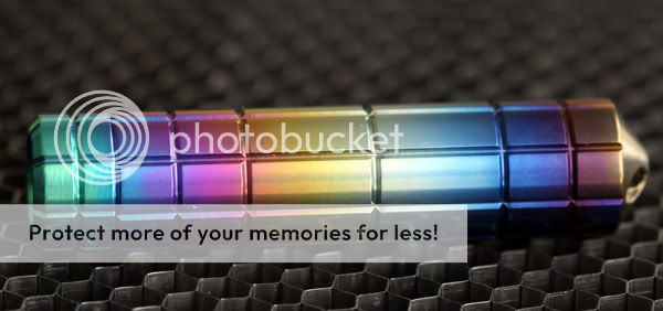

is there anyone out there that does custom anodizing? i have a benchmade 630 and i want to get the titanium scales reanodized a dark green. is this possible?
I could help you out...but "dark" green isn't really an option with Ti. This piece has the full spectrum of colors available for Ti:
~Chip
The only green that's possible on Ti is at the left end of the piece shown above.
~Chip
