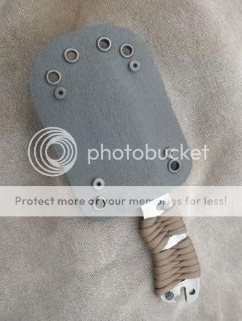

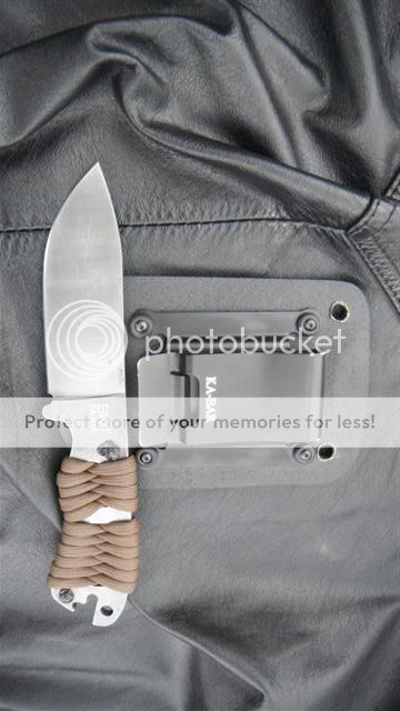

Hey guys. I just (kinda) finished my BK11 project. There are still some things I'm thinking of doing, but it's done for the most part. I'd still like to replace the TDI clip screws with phillips heads, and possibly add some sort of patina.
And before anyone says anything, I know the screw on the clip are on the wrong way.
Overall, I'm really happy how this turned out. I wanted to make a nice EDC fixed blade set up, and I think this fits the bill.
The sheath:

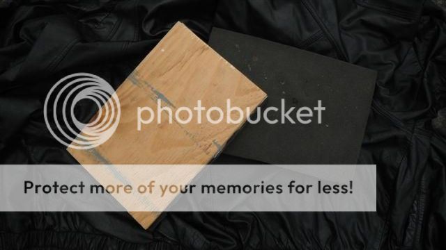

Made a basic kydex press out of two planks, some random foam, and some double sided tape
Molded my own sheath by pressing down on the press myself (I used .06 thickness kydex)
Threw on some 1/4 and 3/16 eyelets (set with drill bit, the bald head of a screw, and a hammer) :rolleyes:
Put on a KaBar TDI belt clip
The knife:
Stripped off the original black finish
Buffed it up a little on a buffing wheel
Put on a paracord wrap
(sorry for the odd angles, photobucket messed them up for some reason)
Just thought I'd share and see what you guys thought.

I've hesitated on bending my own kydex because "proper" foam is kinda pricey and I don't have any lying around. Good to know it isn't necessary!

Looks like a really nice set-up you've got there! Nice sheath and clip, and the brown of the paracord looks good on the naked steel. Nice job!
Looks great, my Indiawood Handles for my BK9 should be coming in any day now!
I'm thinking of stripping the coating and blueing it, what did you use if you mind me asking?
The 11 and 14 are terrific knives in a small package. You did a nice wrap and the kydex is first rate.

I think that as long as the foam is about 1"-1 1/2" in thickness and is soft enough to conform to the sheath reasonably well, it will work just fine. I doubt it's an exact science. By the way, if you do mold your own sheath, don't be afraid to reheat and try again. It took me about 10-15 tries before I was completely happy with the results. The blade retention is pretty good. I used one layer of scotch tape on the blade when molding the sheath and probably should have used more. It snaps in and out well enough, though, and I have no worries of it falling out.

Proper foam is like 12 bucks for a 12x12 slab. cut in half and add some scrap wood, and you got yourself a Kydex press. Now, a heat gun and toaster oven, a decent eyelet setter, those can start to run some clams, but it's still not too expensive, IMO.

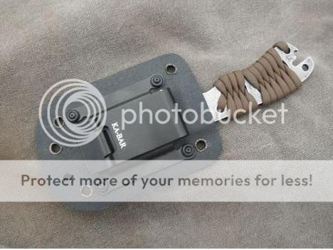

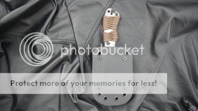

Thought I'd throw up some new, better-ish pictures. I'm seriously thinking of giving it a patina.
Again, sorry for the weird angles. Photobucket messes up the pictures for some reason.
Also, this is the press I used.
