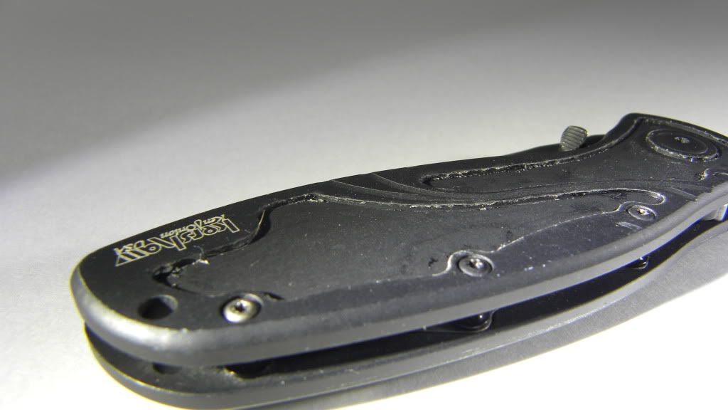

could you anodize a blur to purple for me? and how much would it cost? its black atm

If you strip the knife to the scales and remove the grip tape...its about $65 for a lot charge to do purple. If you're not in a rush...I can run it with one of my overseas customers billet racing clutch covers and it'd only cost you $10.

Yeah so long as I'm not the one stripping it.I don't want to strip it. My blast cabinet is terrible for leaks and blasts powder all over so I only use it when I have to. With clips its not so bad but big jobs mean big powder mess in my shop. While this should not be a big job I've found that blasting aluminum after anodizing can be frustrating. I was asked to clean up a knife once a few years back that was hard anodized aluminum handles. I passed over that thing once or twice knowing it was all cleaned up ( I can't see through my glass anymore and got tired of buying those clear covers so its all by feel with my blasting). Damned if it wasn't just the same looking as when it went in. I could barely tell I had blasted it at all! In my experience if the aluminum is already a color by hard anodizing it may be stubborn about gettting it off there as not all just blast right off. What should be a job that can be done in good time could end up taking a lot longer just to blast one scale. I had a Kabar hard anodized Dozier designed Thorn 4061 model here and it was the anodized black color and I was like to never get that off there and I had another one also a Kabar that had the hard anodized khaki like color on the #4050 model and it was also a long ass job just to strip it down to bare aluminum and I mean I had my compressor kicking at 120psi on average not really doing much with it using glass beads #80.
You may end up paying as much to have it stripped as to recolor it.
STR

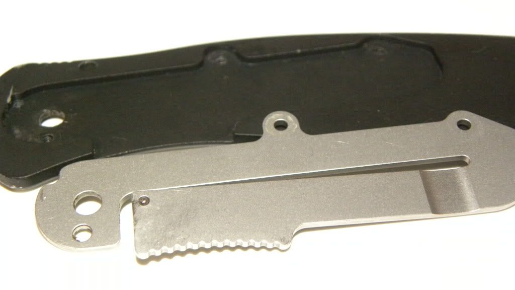

I was looking into removing the anodizing and I saw where a guy used a heavy duty de-greaser and it took it all off pretty well judging by the pics. Maybe an industrial paint stripper? Dont know if that would actually work or not. And would getting the liner lock out and back in be a problem? I believe it is pressed in.

The liner lock is held in by the standoffs and the pivot.

Would there be any way to preserve or restore the Kershaw Ken Onion USA logo on the corner of the scale?
