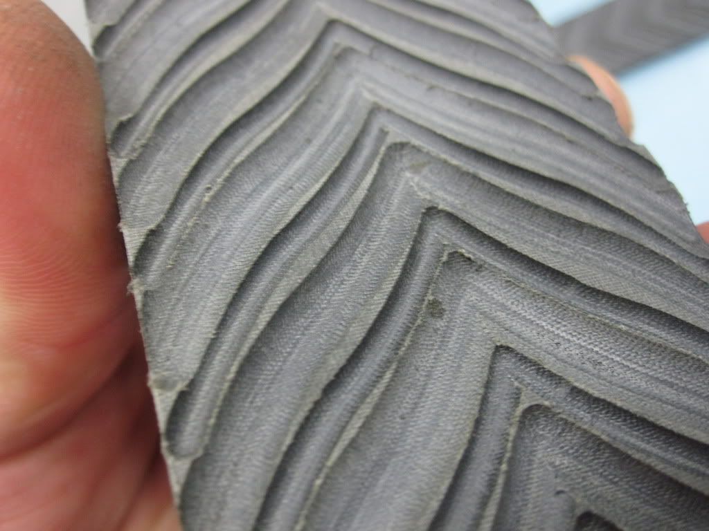

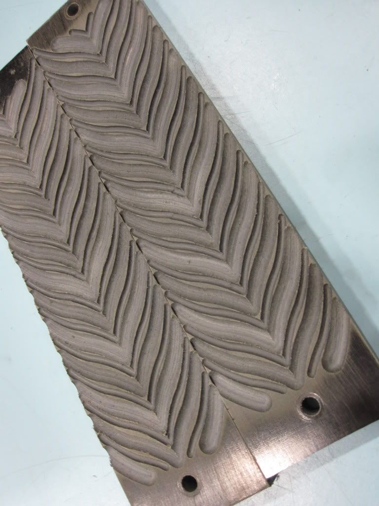

I have been working alot of overtime and while one machine is running, i have been playing around with another.
I am working on a knive for my cousin who is a SEAL and deployed overseas. It is a big combate knife and i wanted something fun for the handles. i really like the texture on Busse Combat knifes so i thought i would give something like that a try.

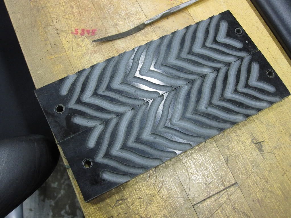

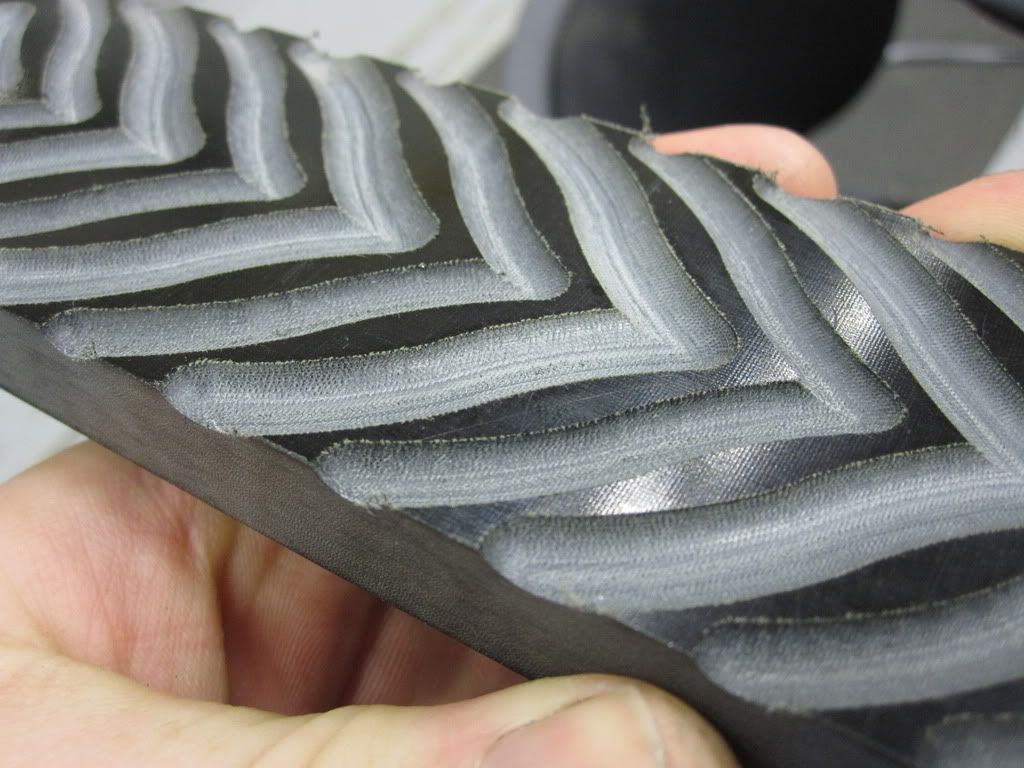

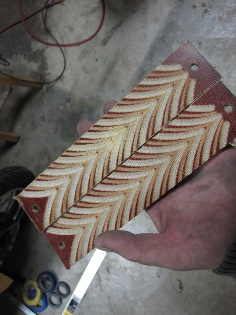

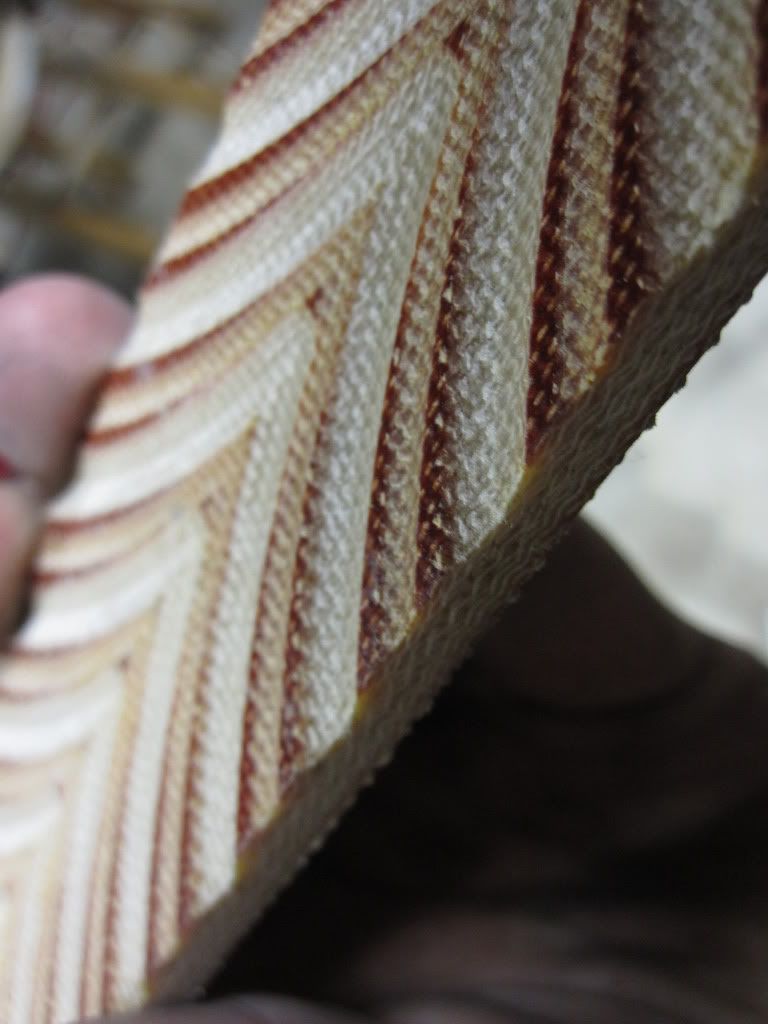

Here is what i came up with. I have these scales in two patterns, a "feather" style pattern and then in a bolder pattern. The scales a 8"x2.5" by 1/2" black linen micarta 3/8" black synthetic 1/4" natural canvas micarta, 1/4" natural G10 and 1/8" linen micarta.
1/4" natural canvas with the "Feather"
1/2" Black Linen with the bold pattern
thanks for looking!

Question, did you do the texturing of the scales freehand with something like a Dremel? The textures look really great, but don't look like they were CNC'd.

thanks! I am curious though, what makes you say they weren't CNC'd? i made them on a CNC lathe set up as a rotary milling machine. i used three sizes of endmills on them for varying widths and depths. 3/8", 1/4" and 1/8"
By saying they didn't look CNC'd I wasn't implying that they didn't look good, my friend! The groove lines just seemed to me like they had just a bit too much wave and artistic beauty to have been done by a CNC. I really thought they had been done by hand with a dremel or rotary tool. Either way, they are amazing looking scales and I think when they're finished on the knife it will be a really good look!!:thumbup:
