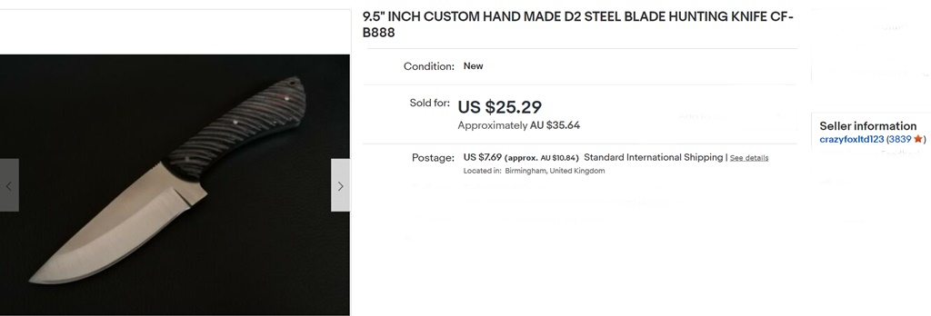

This is not my first knife from CF , . ( Glutton for punishment )
This be my 2nd knife from crazyfoxltd123 ... My first being a 1095 that blew chunks .
That first knife was soft ..
This knife ordered , is supposedly D2 .... Still SOFT !
Yes the blade steel is buttery soft !
ANd I have to wonder if any attempt at all was made to harden the steel ? It's just that soft ...
I think the seller sells some really nice looking knives , but when form trumps function ?
Yeah , this knife might be as useful as a rusty nail ...
I sharpened it and in doing so , suffered a major case of buyers remorse . ( Sooooooffft )
Just how badly can you get it wrong ?
So after two knives , I am assuming these knives might be less a heat treat !
Oh well , slicing paper ...

It's a great looking knife , even feels ok in the hand .. Sheath seems well made ! Just a shame the knife does not actually fit . ...... Yeah !
So on my little bench grinder we go and make some corrections .. Now the knife fits the sheath .
It really look great ( the knife ) for a dried up dog left over ! ( I am making assumptions ) .

I think (?) Pakistan - If not ...... Then India ...
I have tested the edge retention , and for the Price .... I got what I paid for ... Video Soon .

Factory bevel - resharpened !
You could call it a 50 fail or a 100 fail - ill let you decide .
Reground :
The steel is soft , regrinding was quick and easy !
Factory bevel was bad ! With decently hard steel , I would have been grinding for at least 30 minutes if not more .
Butt ... and it's a huge butt !
5 Minutes of grinding , and all the bad juju was gone = ????? Hu !
Yeah , that's some soft D2 ( if it's D2 ) .
Anyways , that 220 grit ground edge returned a 200 Fail .
For the price I paid , I got me a average knife for a average amount of money ( edge reground ) .

So ............ No I will not recommend the seller or his wares if you are seeking a knife to use ......... How ever !!!
He does have some very nice .... Looking ... knives , that might look really good in a display case / wall / or in some form of ornamental fashion .
I tried his 1095 and it was not good . Now I have tried his D2 and it's not good D2 .
