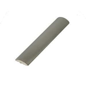

Would DMT's be hard to cut? I'd like some narrower stones, like a 1/2 inch or so for recurves.
I don't sharpen recurves on an EP. But if I did, I'd just use a rounded DMT like this one.
http://www.edgeproinc.com/Sharpening-Stones-c5/
You can purchase normal Edge Pro stones cut to 1/2 inch widths and I have read people having good results with them on recurves. I have also seen someone custom cutting Shapton and Naniwa stones down to half inch widths for mounting on Edge Pro blanks but they're not widely available cut down like that. I assume someone with a nice tile or stone cutter could do it?
I have used the normal 1 inch stones on recurves, slight recurves like a ZT350 and a Kershaw Tyrade, and it sharpens well but it does round the edges of the stones and I can see where I would benefit from a narrower stone. However, I would like to try that curved stone mounted on an Edge Pro blank. It is too bad that it only comes in one grit.
