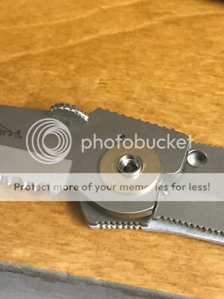

So I made some parts from stainless, titanium and ampco 45, for those of you that have not Hurd of ampco 45 here is a link

The washers make a major difference and I’ll be making 1/2 a dozen of them, the ampco and titanium pivots also make a smooth opening difference also

I currently have in my 7-b the washers and a titanium pivot I made and it feels (this could be in my head) really solid, I am running every thing dry with no lube and it’s every bit as smooth as factory washers and pivot pin
Bottom line, it’s really cool to have them but if it’s not broke don’t fix it

PS: try drilling some small holes in the washers to perforate them for lubricant retention (like CRK). See if that makes a difference.

Actually I find the earlier sebenza Regulars with solid washers are smoother than the perforated ones on the new 21's.. I owned several of both and I sold all my 21's and kept all my regulars for that reason alone.
still using the parts, I have an easy 50 opens and closes with the dry parts, how ever tonight I will ( or tomorrow ) take the knife apart and put a little "super lube" grease on both sides of the washers and on the pivot pin, will let you all know if that's any better or no change at all. As of now though I feel like these are 10-15% smoother and they make the knife feel 30-50% more ridged.

I figured they would after wearing in and the knife will feel smoother as it wears in. Personally I would do about 400-500 opening before adding grease.
But I am still coveting your washers. I wish there was a place to get these and we could just sand them down to desired thickness and viol'a.
not going to lie, its nice having these bushings, but my friends emerson with factory bushings feels just as smooth, my bushings are .035 thick and his are .029, I might sand mine down a bit
