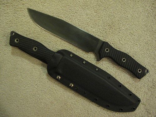

I saw a blued chopper posted once on the forum but can't recall who did it. I remember it looked very nice from what I recall.
Might have been my 711, Super. I'll see if I can drag up a picture in a bit.
Blued 711
With some friends
oooh! Pretty 711!
