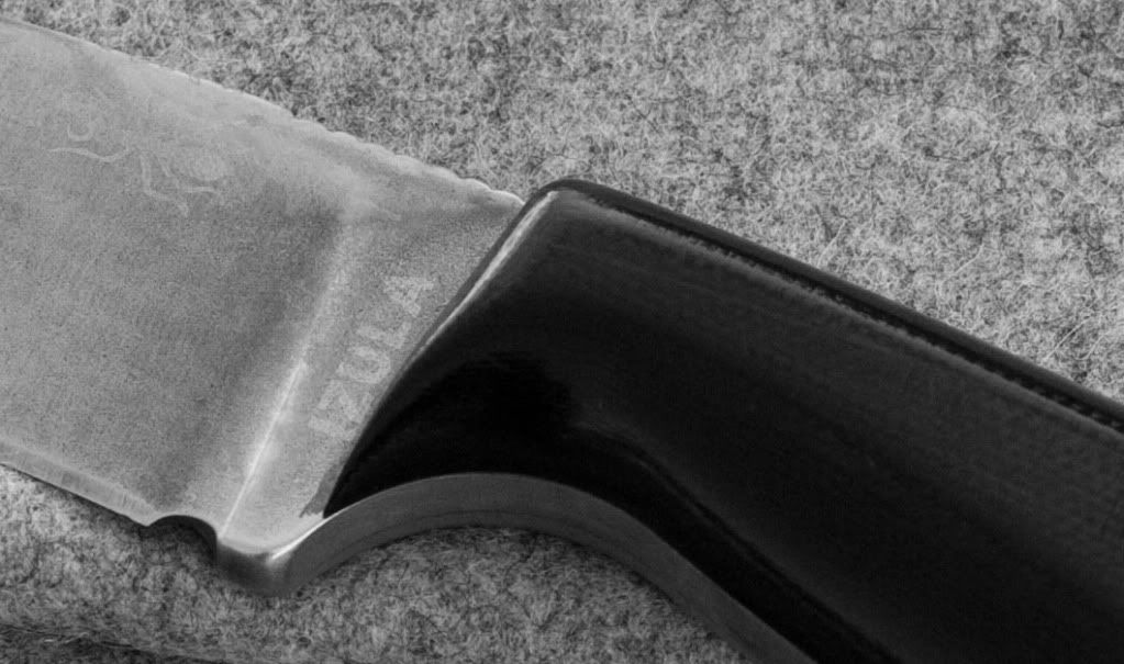

Its a fun project. Did my Izula
God bless,
Adam

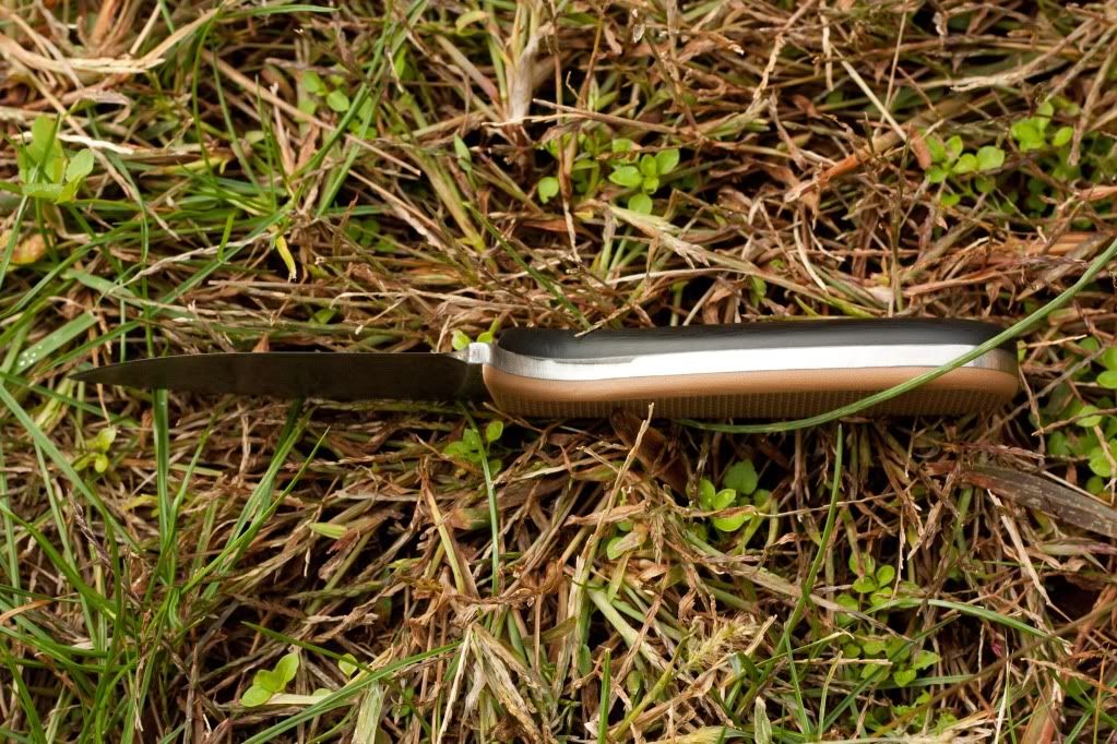

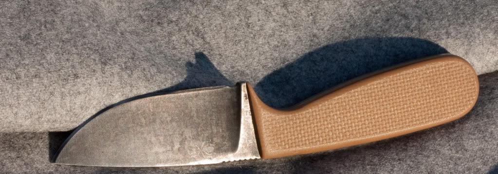

Here's a couple more shots. The handles are asymmetric so they look goofy, but I love the way it handles. Also you may note the two side don't line up the same... I'll figure out a better way to line them up next run (probably on an Izy II.)

Thank you much, jumpmonkey. I'm not seeing any fastners - are you relying on glue to secure the scales? If so, epoxy or some other adhesive ?
