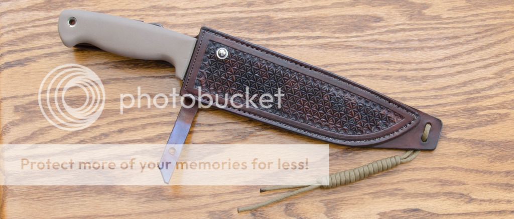

Got this one done for my friend in Norway's Basic 8.
Thanks for looking!
Mark
Removable dangler, removable retention strap, fully lined. Brown with beeswax finish.

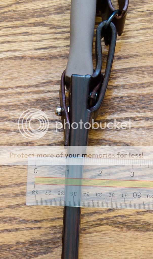

Any pics of the edge showing how thick it is?
I checked out your site recently, I really like your work. I'm trying to resist the LE version of the ASHBM. If I fail, you're making the sheath. ;)
Thanks guys!
Will, the edge is about 7/16", and just under 5/8" at the mouth (I used a double welt first inch or so).

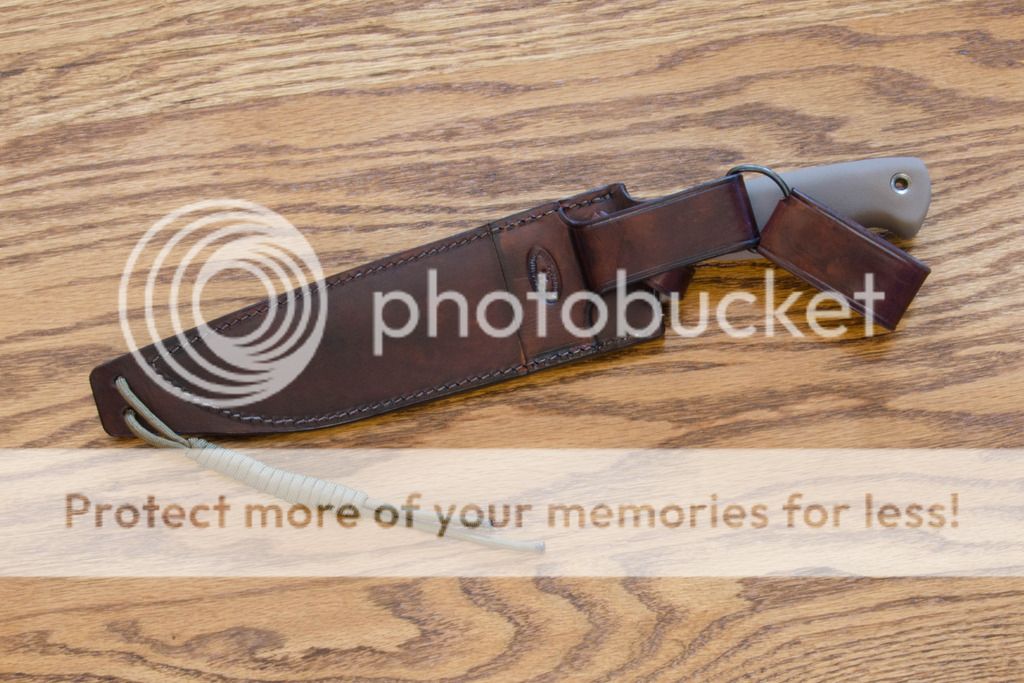

Is that keeper strap on a pivot pin at the back, or is it a snap? Removable?
Will, thanks! That's a snap. Retention strap is removable, and also will rotate on the snap and pivot out of the way when used.
There is enough retention without the strap that I can lightly shake it upside down and the knife won't fall out. I'll post up a pic in a bit.

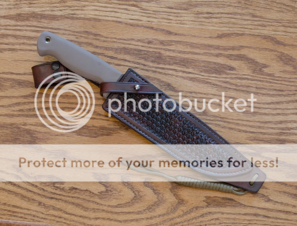

here's a couple pics of the strap removed/rotated.
Note the retention strap is also lined on the back side (as is the dangler loop)...
