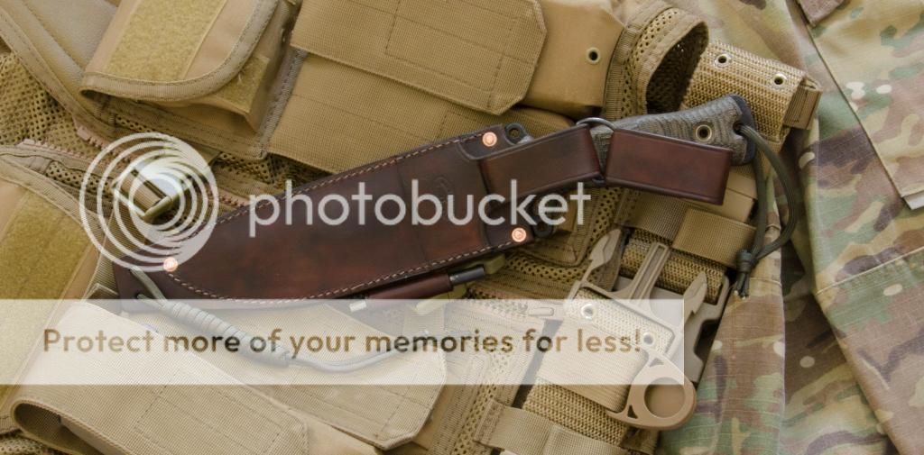

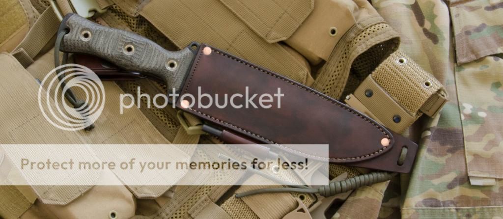

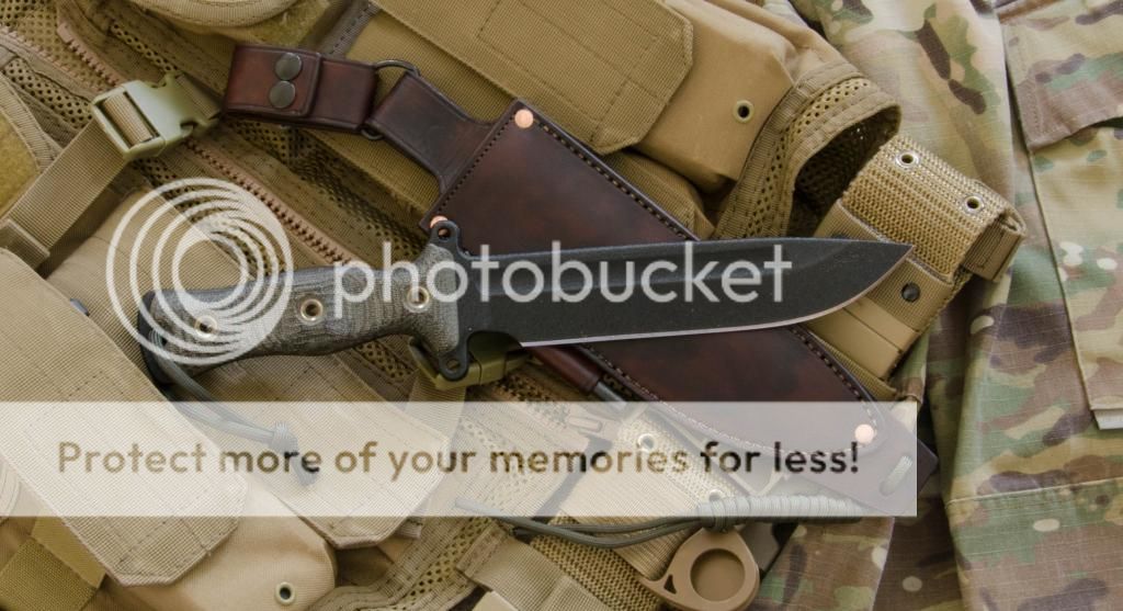

Finished up my Team Gemini LB sheath, in dark brown.
Normally I'd put a removable retention strap on this style, left it off this one for grins.
- Made from 7-8oz Wickett & Craig leather with 2-3oz leather lining
- Fully lined interior
- Removable dangler loop - Lined as well
- Military grade, US made black hardware
- Copper rivets at high stress points
- 5/16" Fire steel with bungee retention cord
- 100% natural Beeswax/oil finish
- No rivets or belt loop stitching on inside of sheath
- Integral leg tie-down
Thanks for looking!

Awesome sheath! I like the belt loop for the ring so you can also make it a dangler. And I wish my stitching look as good as yours.
Will that work for a regular TG as well,or only the Light Brigade version ?
I have been looking for a leather sheath and that looks real nice.
Excellent work, that sheath looks very well built. This is just what I'm looking for for the TGLB Garth edition I have on order.
Thanks guys!
The leather is drum-dyed Wicket & Craig, which is a very even brown. The beeswax finish gives it that mottled look, which I really like, kinda 'antiqued'.
Trijicog, not sure if it will fit the regular TG. If the blade profile is the same, it will. I can modify the welt thickness to account for different blade thickness if needed.

The color does stand out. Perfect for my tiger hide TG. Quick someone send him a TG so we can place our orders
