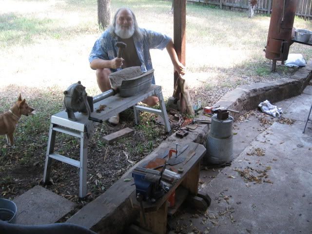

Here's what Tim Lively was using to make knives before he retired:
I'm curious about the forge, is the fire built in the cavity above the line of holes?
As you can tell it is a very new thing for me, so I am trying to learn how things are done.
Yep. Personally, I use a gas forge I made using a Larry Zoeller burner kit. If you're just starting out and are looking at forging as the way to go, Tim Lively's "Knifemaking Unplugged" video is one that I recommend to my students. Lots of good data and good inspiration. Heck, if you've been forging a while the video is still inspirational!
