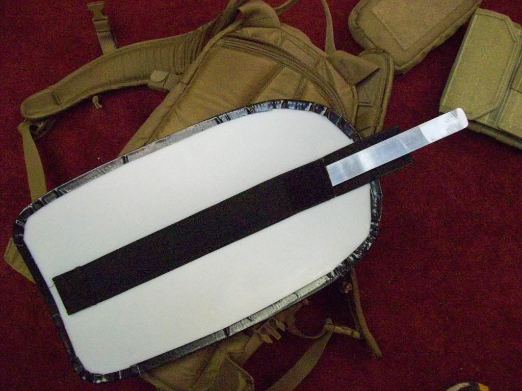

There is an abnormal amount of flex in this pack where the horizontal crease is between the lower padding and the two side or upper pads. These elevated parts have thicker padding though entire back panel is padded.
This is the ATS frame sheet which I cut to fit into the hydration compartment. It also has an aluminum stay for increased rigidity. A full 3L reservoir still fits in the pocket. I used 1" Gorilla tape for binding around the edges. I have found it to be much more comfortable with the frame sheet as there is an uncommon flex close to the center of this pack that causes the top portion to sag and it doesn't ride close or to the contour of the back unless the shoulder straps are pulled very tight. This made it ride too high and was still uncomfortable. It's almost like a joint or elbow the amount of flex in the pack. It may have been designed this way on purpose to fit over body armor but for me it's a lot better with the frame sheet.

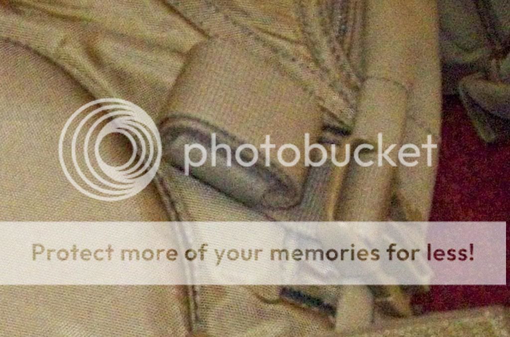

Thx! I'll have more pics with the Hawg attached to my EMR as soon as it arrives in the mail (about one month). The Long Pockets I ordered from Kifaru will also fit on the Hawg. I will have to replace one side of the buckles on the pockets to get it to fit right. The buckles in the pic are the female auto lock (National Molding) with the quick attach male counterpart. This will be used when attaching to the main bag. But the female buckle will mount directly to the male portion of the compression strap buckle on the Hawg. I have used the strap keeper to keep the male buckle secured by rolling the strap as tight as possible. The buckle cannot slide past. I have also tested this and found I could not feel any contact point from the strap while wearing the pack in this configuration.

Places where strap is rolled and secured with Velcro fastener seem would make uncomfortable contact point on back. But after testing I could not feel any contact from bunched up strap.
