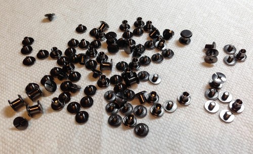

if you've got a a pancake sheath, use the tek loks this won't be for you but if you have a taco sheath this may be worth your while. Sure you could just opt for a pancake sheath but for those
of us invested in the taco already, cheap alternative. It's solid and it works. Very thin profile. Have done this on 4 sheaths with blades ranging 5 to 8 inches in length. Any longer than that I'm not sure
you'll need
blackhawk serpa strike platform
DLP tactical molle clips
flat back chicago screws
cut the wings off serpa platform, should look like this (you can round off the edges and dehorn per your preference)
use 2 sets of chicago screws w/ spacers that came with DLP tactical clips and one DLP clip to achieve following:

use 1 set of flatback chicago screw to achieve following
https://flic.kr/p/2m4QELH
https://flic.kr/p/2m4V4kj
use other DLP clip and 3 sets of flatback chicago screws to achieve the following:

use 2 male screws that came with DLP clip to attach the platform to the sheath:
