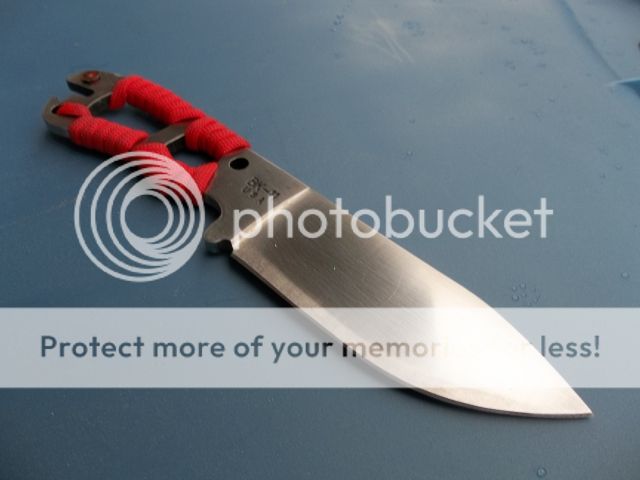

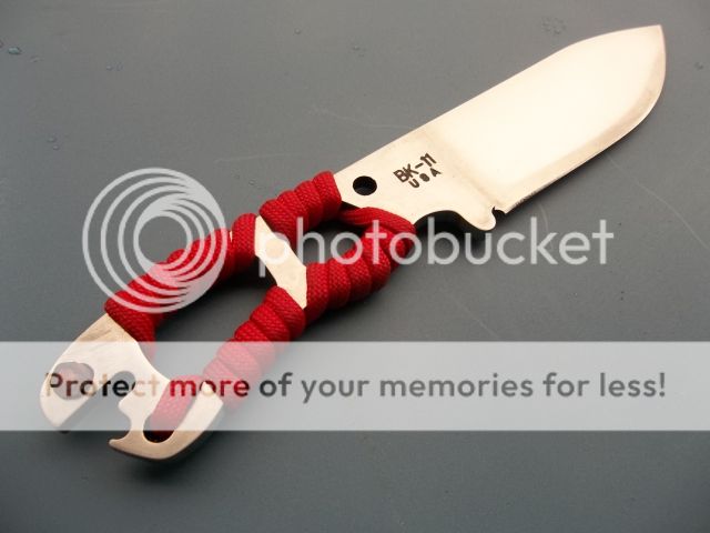

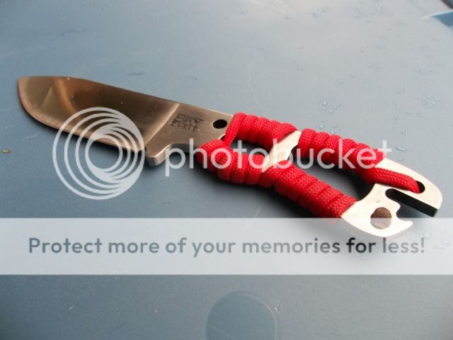

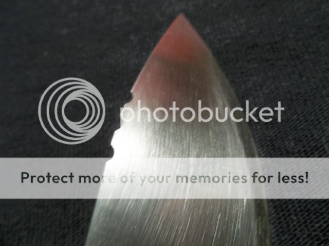

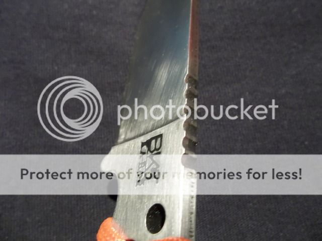

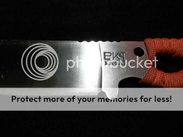

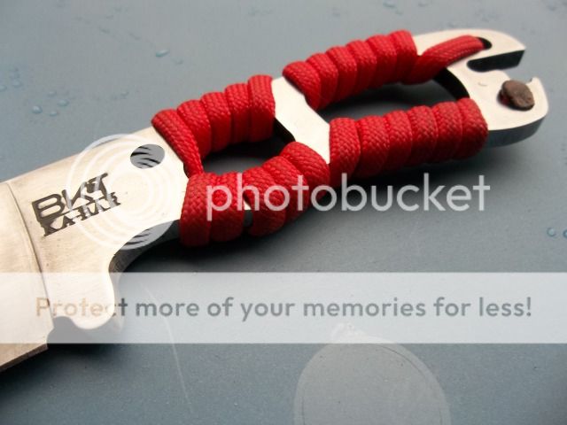

So got the 11 in yesterday, after doing some fishin I got on it last night, stripped and did a lil polishing.
started at 100, then 150, 220, 250, 800, 1,000 and 000 steelwool
Not ''perfect'' mirror but she wants it ''shiny''...I think this is good compromise level between pretty-shiny/USER and mirror-polish/SAFE QUEEN
JIMPING-
still got a long way to go, pink micarta, kydex, lanyard, ??? who knows
*did the handle first as ''practice'' for the blade...all polished up, but all that time/work is gonna be covered up by the scales soon LOL
thoughts? critiques?
Looks great,as usual your going to put us all back to work from Becker envy lol. Really does look sweet!!
Ballin' with the Benjamin In the reflection. I'd have a Lincoln and some change in mine. Liking the shine man. Do you plan on putting any compound on it?

Looks good man! I like the red on shiny look.
TY, me too, if this was mine it would stay just the way it is LOL, buuut micarta she wants micarta she gets

doing it by hand is sure time consuming huh...
yeah...time-consuming, Very. I have a couple hours or so in it. Would hate to polish up a 9 that way! would take forever LOL
Nice, it took me a while to get my 14 that shiny, but it sure looks nice afterwards!

LOL, It's what the owner wanted...''Shiny and Pink'' are the only two requests she had, everything else is up to my imagination. Doing jimping right now, took a ''hand break'' ;)

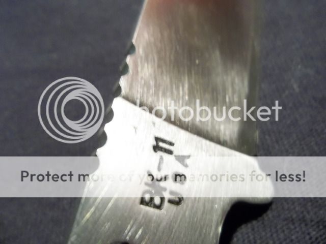

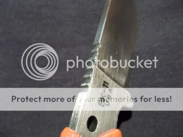

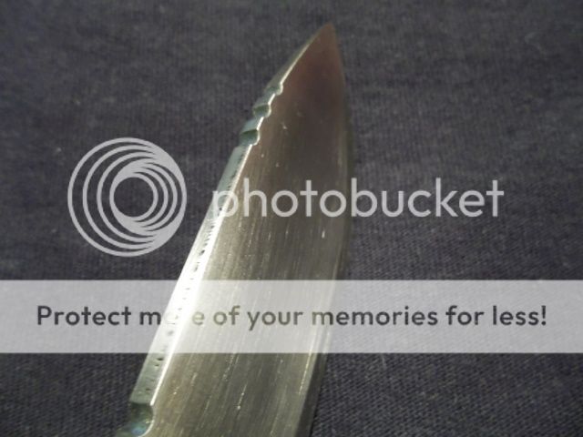

finished the Jimping....pics added to OP

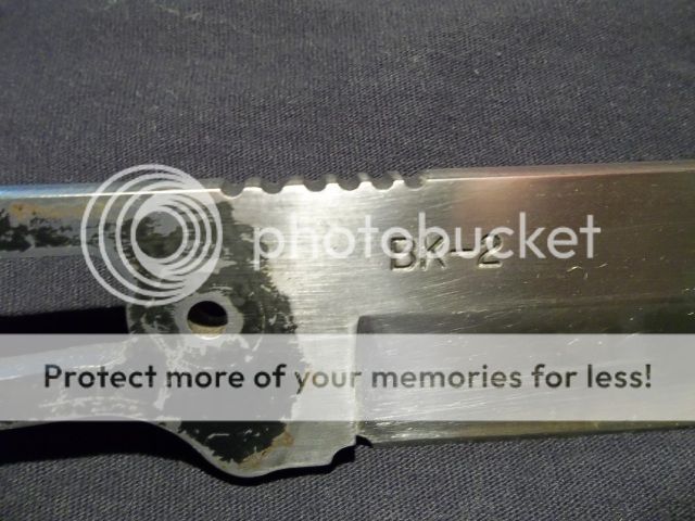

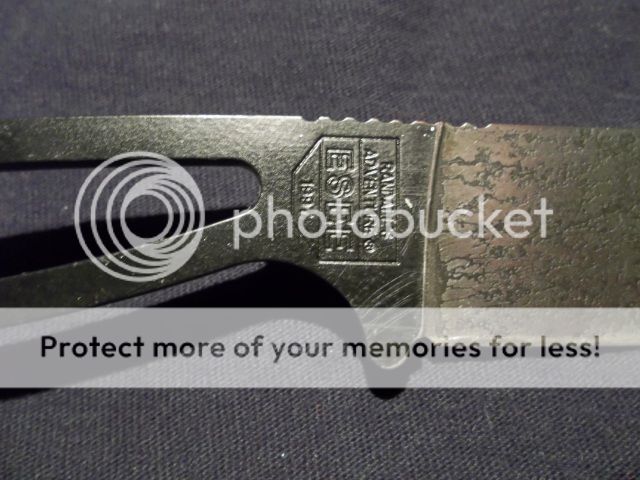

Did my 2 first as a practice run...dremel screwed up the first notch so I went to hand filing from then on, did my 14 next, to get my scale/pattern down for the 11.
