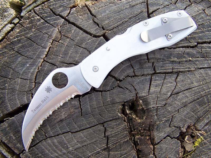

Steve Ketchen does great work, but I'm not sure if he'd want to tackle a Tasman. I think finding someone to make scales for one is going to be tough. It involves cutting the knife apart so you can use the handle slabs and built in backspacer as patterns, then fabricating a replacement backspacer, scales, and possibly liners. It can be done, (STR, for one, use to do it) but it's going to be more complex, and thus more expensive, than just replacing the scales on a model with a separate backspacer and full liners.
Here's a Tasman Steve Rice (STR) did some years back...
