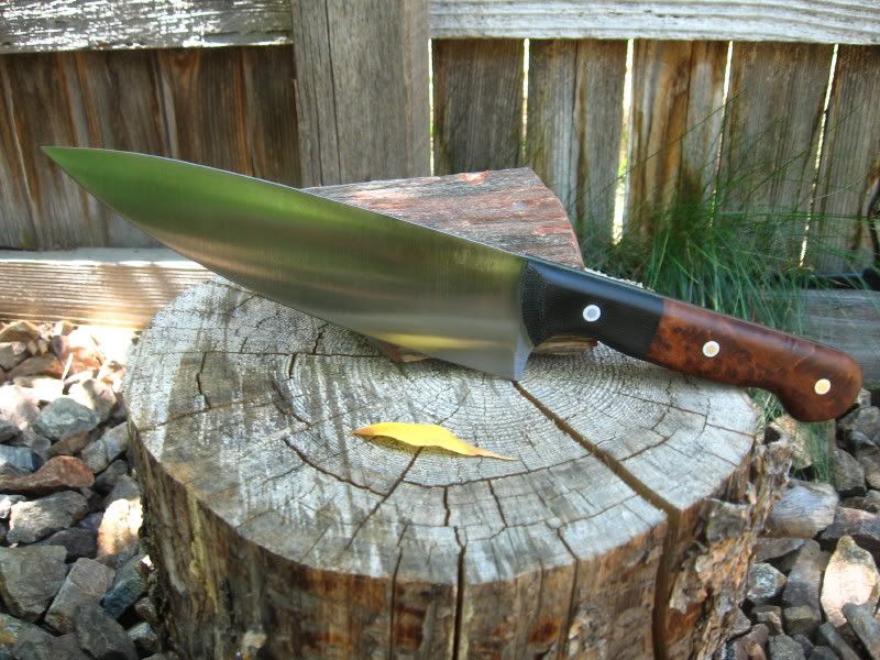

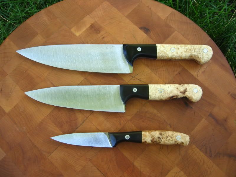

Hey Fellas, here is a custom set I finished recently. Done in 3/32" CPM 3V. Black ivory and box elder burl handles.

Another large chef's knife with a convex saber grind on 3/32" stock.

Fantastic knives. I must ask because I wish to learn. What is the rationale for not bringing the edge all the way to the heel of the blade? On the chef knives anyway? I see so many fine knives that do and probably an equal number that do not.

My thoughts as well. They are some fine looking blades. Tough to sharpen the full length of the edge however. Unless the "bolster" is ground off they are going to end up with a recurve to them.

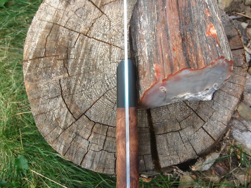

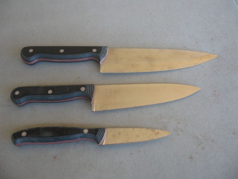

I think it's a lot of personal preference. The trend right now is to bring it back. Most of the traditional european chef blades have a guard, and many of the Asian models do not. If you look closely at the burlwood blades I grind the guard up a touch above the edge. When flat on the cutting board the guard does not contact the board. Same effect as no guard. Either is easily done and since all blades are hand cut and shaped by me, that is an easy mod for me to do. Thanks for the comments. I have people ask about the 3V. I have a customer who sends his set throught the dishwasher. about 20 trips has done this.
Amazingly stain resistant.
The g-10 handles have gotten the worst of it. Still are solid as can be. For those who demand stainless, S35VN and Elmax are available.

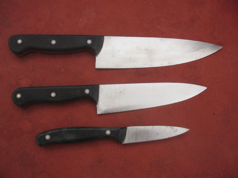

Had a couple questions about Geometry. This is for comparison only. The CPM 3V I have been using for the last year has performed great. It has proven to be very stain resistant and can be given a thin geometry and still be plenty tough. here are a couple pics.
Here is my full size chef with a full height Convex grind.
Here it is next to a Henkels for general comparison.

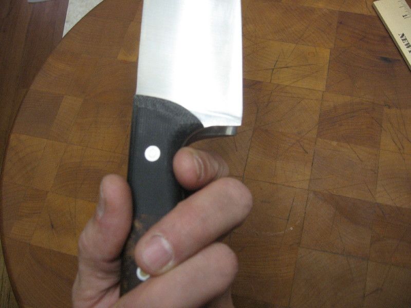

Both knives positioned at first finger.
You can see how much further forward my C3 handle goes, allowing for great hand positioning.
The 3/32" stock of CPM 3V is perfect and you can see the improved geometry of my blade on the right.
Everything is done 100% free hand with no guides or scribes of any type. Thanks for lookin.
