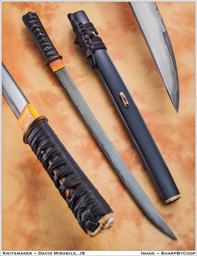

A 12 inch blade will be a Tanto not a Wak
This is a Wak
Ok. I said that in the last discussion thread and was told the opposite. Either way it is what it is.
Joe is correct, at 12" it is a tanto.
And I would go with a real guard if I were you.
