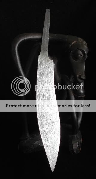

E-Nep is a traditional Thai blade tool.
The problem is, generally the native smith is lacking of the heat-treating know-how.
Devilki (one of BFC Member) has spent months supervised them. And finally came up a high quality blade that I'm goinh to post the test pics later.

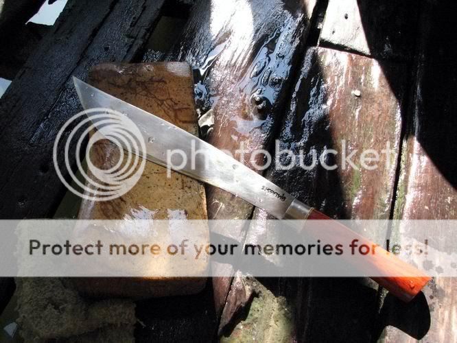

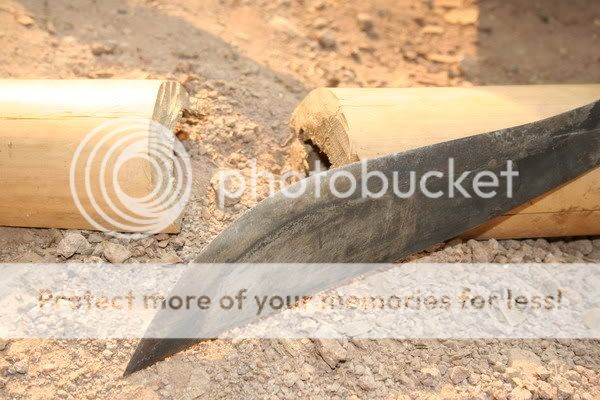

First off is to try a joint (which is the hardest part) of a big 'n' old bamboo.
Then some cattle's bones
:D
A flex test . . .
That's the most the guy could do before the blade bend back to true. ;)
NOTE: PLEASE DONT DO THAT AT HOME, IT'S DANGEROUS.
That's should be more than enough for a general utility blade for us.

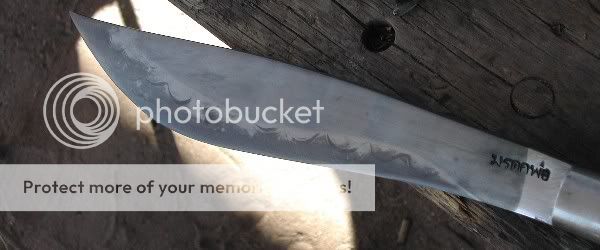

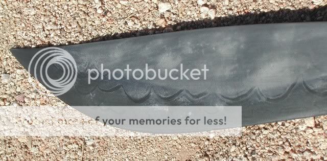

I noticed some figuring in the blade, so I decided to give it a quick dip in some ferric chloride (acid enchant) and look what popped up. It's a wonderful quench line (hamon)! I would like to find out more about the heat treating that was used. Did he learn this from his father?
I will study the knives some more. I plan to re-sharpen them and test the full length of the edges. So far though,... the heat treating seems O.K

Tai Goo said:
Did the smith use clay along the back? Here's another shot of the "hamon". I've showed it to another smith and we never saw anything like it!

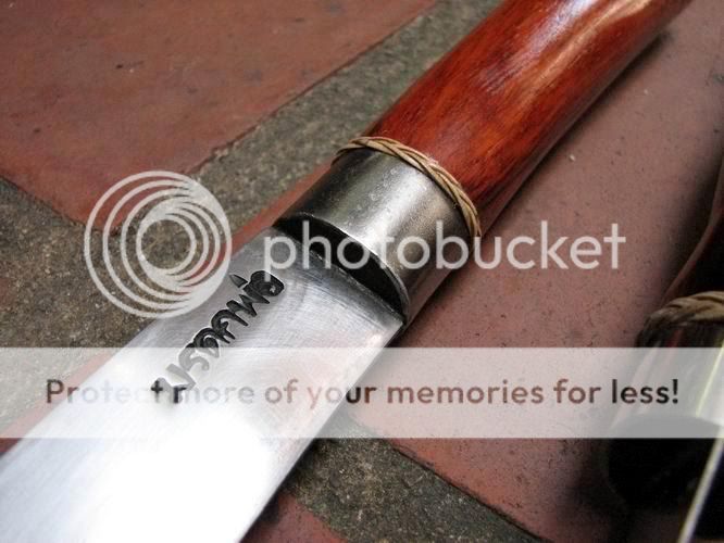

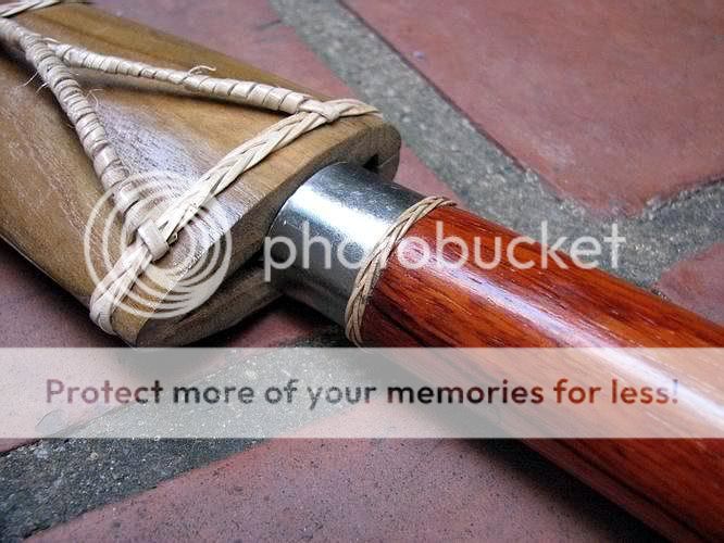

Here's the new after development of Handle.
We had a few issues with the handle to work out, but nothing serious. I did a little pimping to it and it was just dandy! A bit of epoxy here and there, a quick dip in some acid to show the quench line, a pin through the tang and some wrapping to cover it up, that's all. That's seasoned ironwood I tested it out on!
