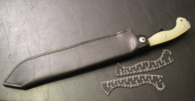

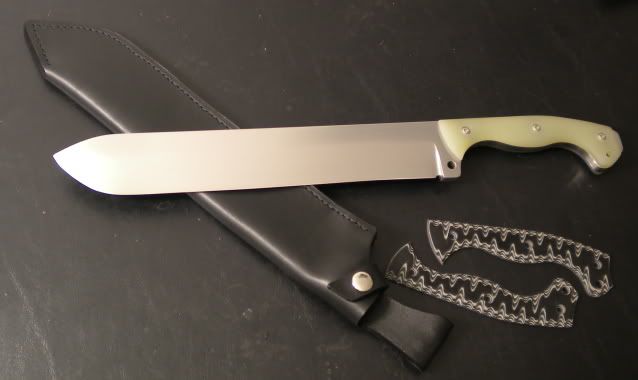

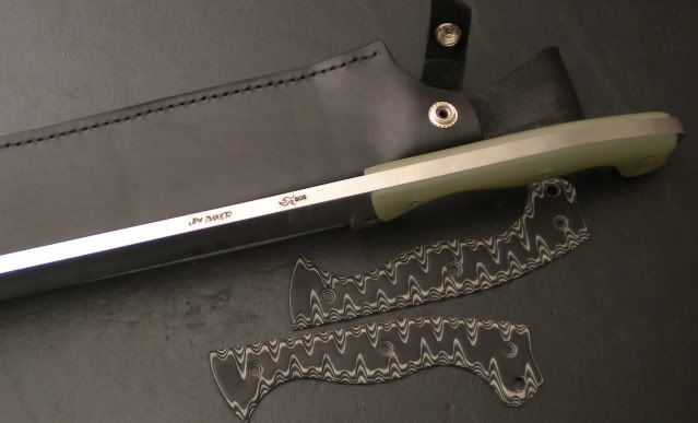

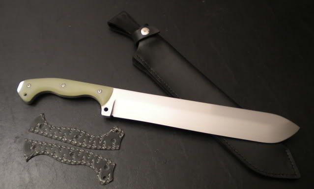

Off to it's new home shortly, here's one of my heavy choppers built to order.
This knife comes with both Jade green and sculpted black/grey G-10 scales, secured with Torx fasteners. The handle bolts thread into replaceable threaded inserts, so if a thread is damaged the insert can be replaced.
This is a beast, but still handles well for its size. The tall flat grind is built for work, and it has a nice sharp edge!

- 5/16" thick A2 tool steel blade, full tang build
- Paul Bos heat treat/ cryo to 60-61 rc hardness
- 18" overall, 12" blade, 2" wide
- Weight 35.2 oz.
- Flat ground bevel and edge
- Jade G-10 and black/grey G-10 scale sets, interchangeable
- 8-32 torx handle fasteners, threaded into replaceable steel threaded inserts
- Exposed pommel tip
- Black leather belt sheath, hand stitched with keeper strap, 9oz. leather

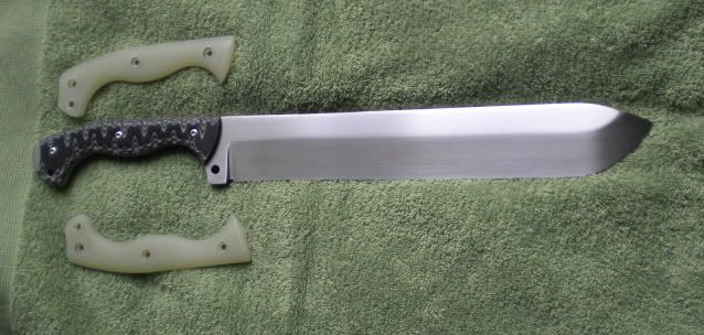

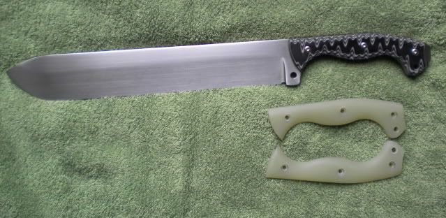

Here's a few in progress pics, with the black/grey scales attached:
