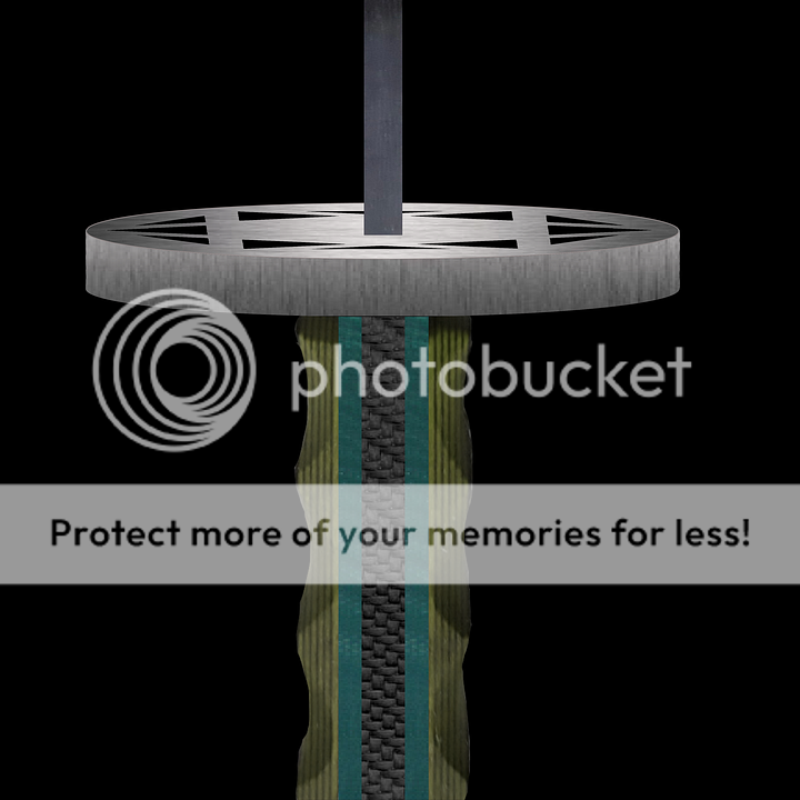

This final image shows a particular aspect of the handle that I hope to have done. I don't like the idea that part of the tang in the handle is exposed to the sweat and moisture of a hand during use, as I know that will lead to rust or will require oil, which will make for a slippery grip. The solution I hope to have overcome this is to have the tang wrapped in carbon fiber and epoxied in place before the forest green g10 spacers and the od green & black handle scales are installed and sanded.
Let me know what you think of this, as I am not an expert in this area and don't know if there is something that would make this a bad idea.

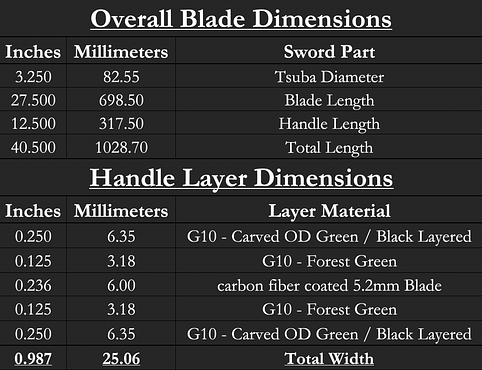

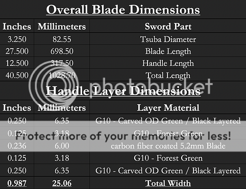

Here are the dimensions / specs in more detail:
Interested to hear your thoughts.
