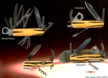

I've posted some pics of my customized SAKs in The Gallery section -
Customized SAKs
Here's the overview shot:
The other post has the details.
Anyone else with SAKs that have been customized, and care to share with us, please?

Thank you so much for the kind words.
The details and additional close up pics are in the thread I posted in The Gallery section - here's the direct url:
http://www.bladeforums.com/forums/showthread.php?s=&threadid=257987
To summarize - I had these done by KJ Lewis of SC - he was featured in one of Ken Warner's Knives 'XX books (unfortunately KJ no longer does this work)
My EDC Scientist #1 was the first he did with tools inlet in the handles, and the Scientist #2 along with the SwissChamp and Waiter were the last ones he said he was doing.

You have to bear in mind that Victorinox SAKs are such good value (I mean the all singing SwissChamp can be had low priced at under $40) so these customed handles cost more than the knives themselves.
It might be cheaper and more satisfying to try to make one's own custom handles by studying the standard handles.
Inletting the tools in the handle can be a real challange though.

Ive done some in the past. Some in buffalo horn, bone, stag, osage orange (wood), african walnut, ect.
Sorry unknown, I would like to, but the knives that received the scales are long gone. I havent seen one of them in over 15 years (I believe). They reside with whoever their current owners are (?). At that time I did not keep pics of the knives I worked on.
If you want to customize these your self, its fairly easy, an afternoon project. You pull the handles of an sak (use a small flat head screwdriver, be careful not to dent the liner). Use the old handles (scales) as a template. Cut out, sand finish, ect. You countersink the new scales where the pins fron the knife liners slightly portrude (where the knife liners will eventually meet the new scales). You then glue then handles on with duro two ton waterproof epoxy.
I've done a few following the steps tha have been outlined in other emails. you jut have to take your time, be willing to sacrifice the original handles and be careful with the epoxy!
