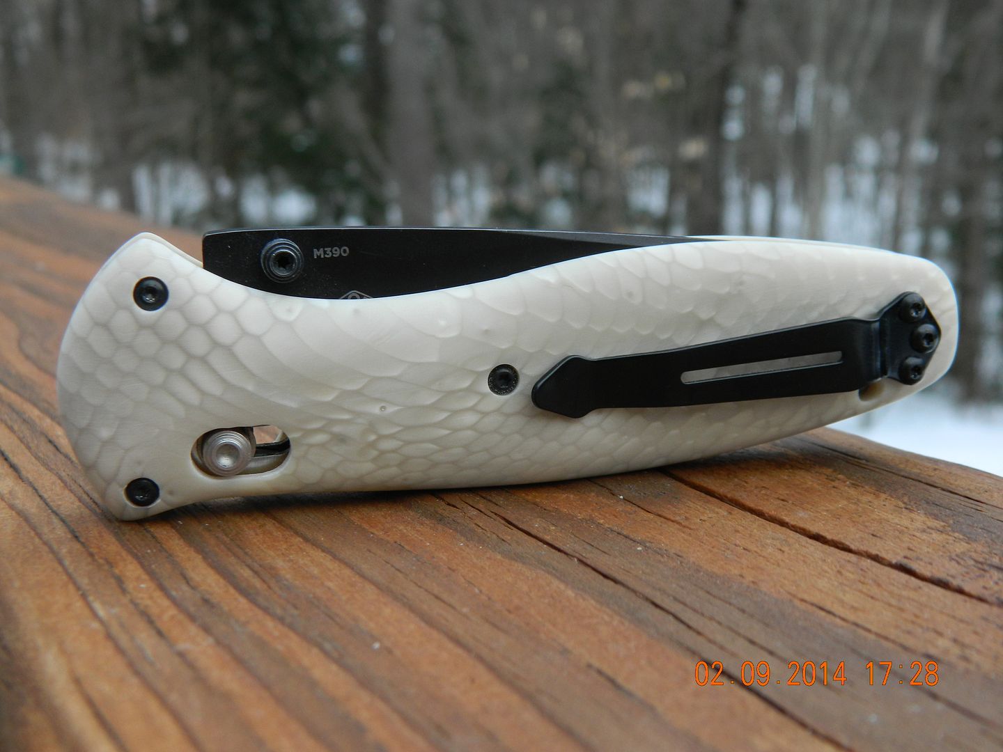

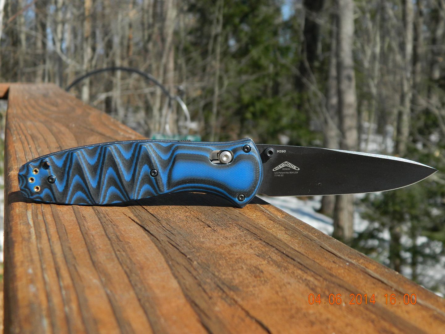

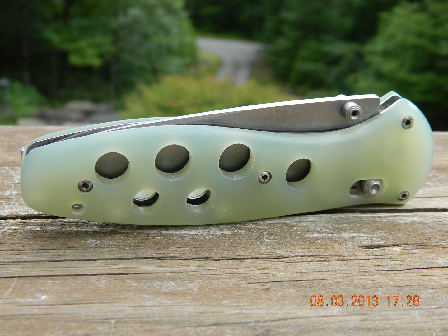

Also does anyone know about solid g10 scales for for the barrage 580 I seen a pic of one that looked like g10 but have not
Found any info on it. It would be a big improvement over the valox scales which imo it should have.
Does anyone make custom scales for the barrage.

While I haven't seen any custom scales on the barrage series, I would think one of the scale makers on this forum could make you a set.
Converting the Barrage to auto is nigh impossible. Sadly it is just not made to do it. The scales are much more doable, but have an issue. The scales are heavily milled to give room for both sides of the pivot and all the screws, and that would not be easy to get done right. Many scale makers here can do it, but it will be pretty expensive/hasslesome to accomplish.
That makes sense. I have not taken of the scales to check underneath but I can see that without the right tools to do the milling it would be tricky to do the scales are not that thick to begin with so there wouldn't de a lot of meat to work with unless you went with thick scales and who wants that.
The 581 barrage shouldn't be to hard to make custom scales as long as you leave the aluminum bolsters maby some red and black g10 with a
