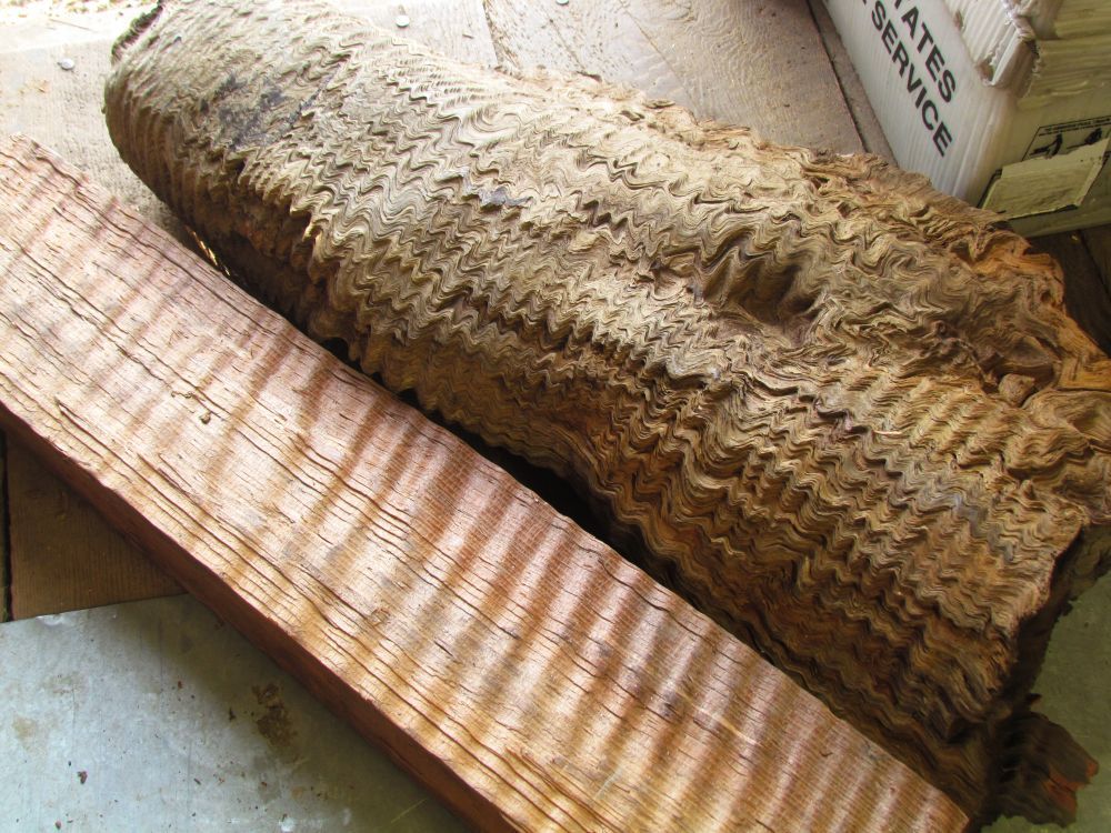

Friday a woodworker who buys burl from us brought in a couple pieces of Redwood that he thought I would like. He always wants to see what unusual wood I have for handle material. I had asked him to keep his eyes open for really unusual stuff in his wanderings. When he came in this time he told Lin and Larry to find me because he had some good stuff for the knife handle guy.
Not knowing what to expect I wandered over to his van to see what he had for me.

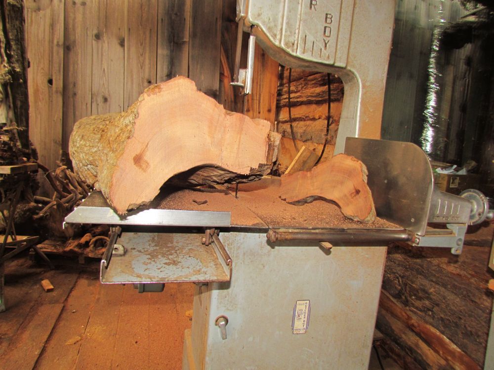

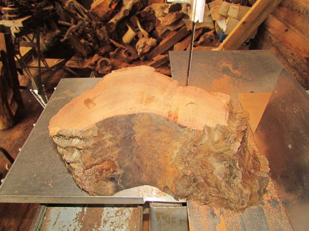

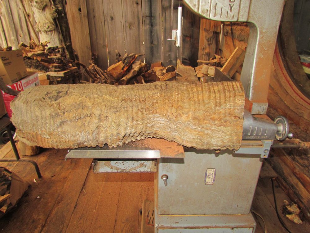

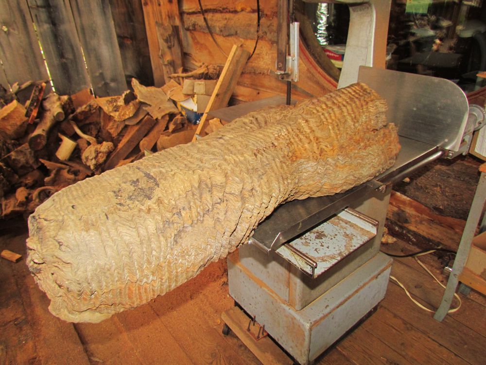

The rectangle piece is a good chunk of Old Growth Curly or Flamed Redwood. The weird looking piece is an unusual growth that can happen on the trunk of an old growth Redwood that has very curly figure. This grows like a layer that is against the trunk but not physically part of the wood. Not sure if I am making sense here. It grows against the trunk like bark but it is a separate layer from the trunk that is mutated wood. Usually these layers are thin or full of pitch. I got lucky with this piece. No pitch, thick and solid.

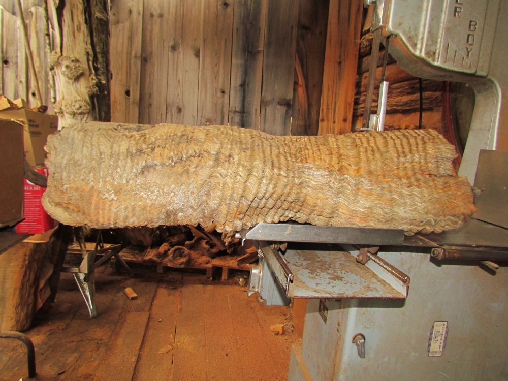

Here I have the chunk on one of our bigger bandsaws.

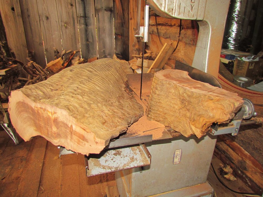

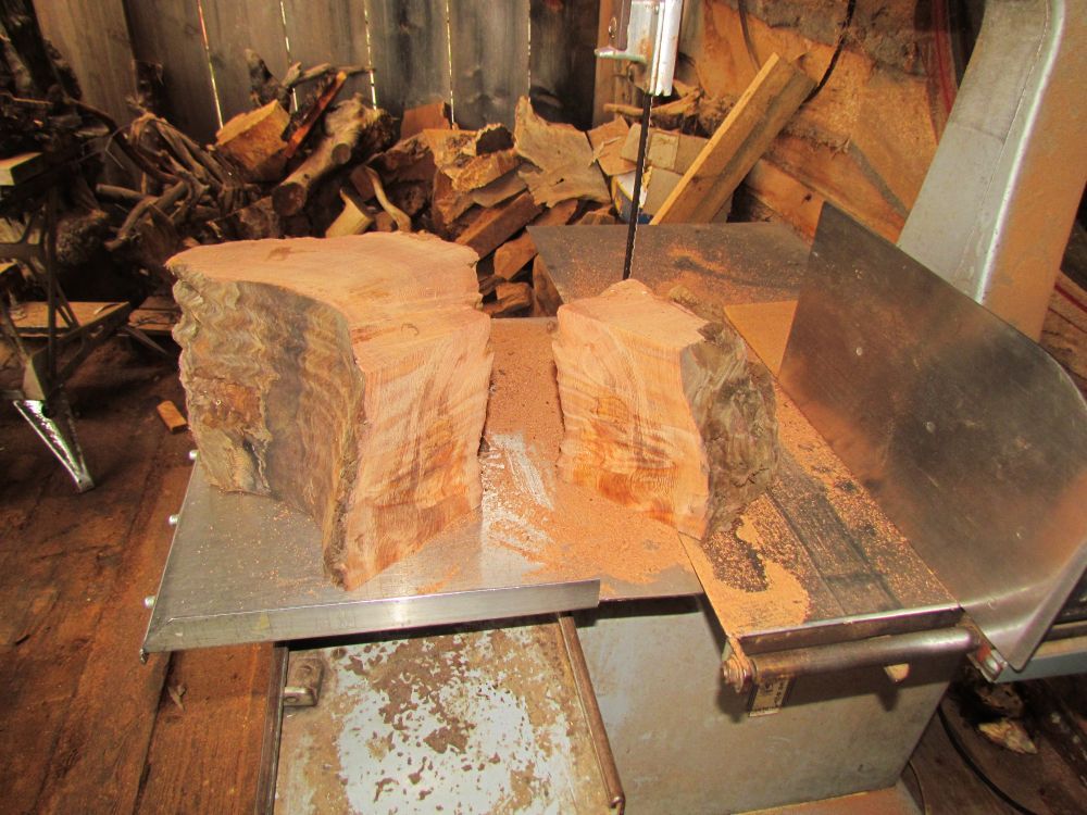

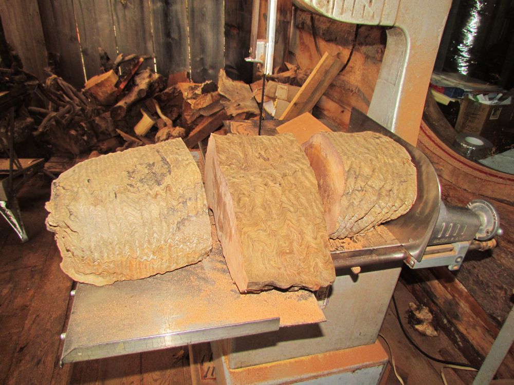

I cut off the end that had the least amount of figure. I wanted to get an idea what the inside of the wood was like. I thought if it was not solid or if it was pitchy I could still use it to make a lamp or something.
Looked good inside so now to cut off a chunk to cut into blocks.

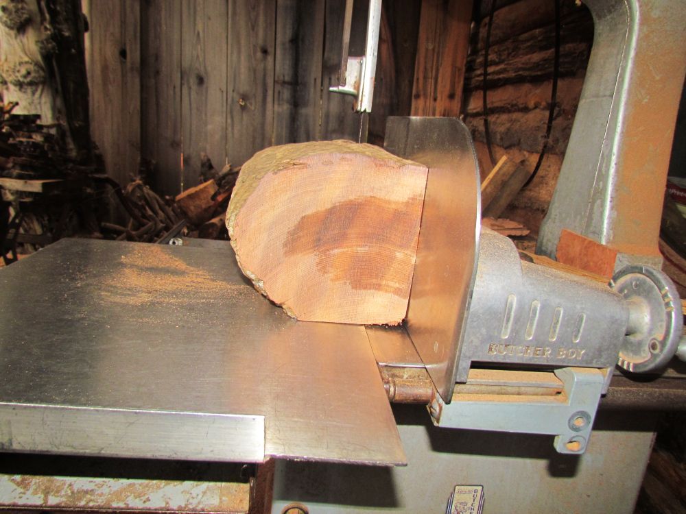

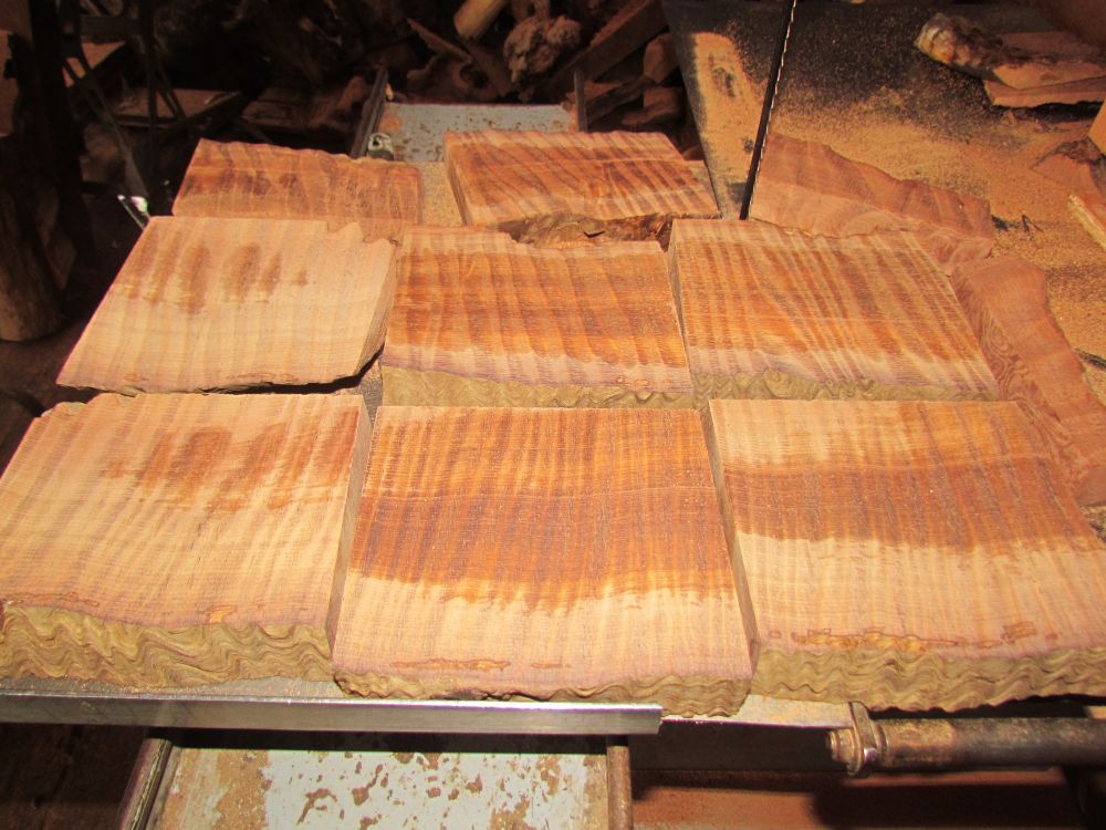

Now I wanted to see how to cut for the best figure. With curly wood you usually want to be as close as possible to quarter sawn to show off the figure best. But on the weird stuff you just don't know until you start cutting.
After cutting some flat sawn, some quarter sawn and some at an angle, I found it looked good no matter what. But the figure was boldest with the pieces that were close to being quarter sawn. So that was what I would aim for when cutting up the rest.

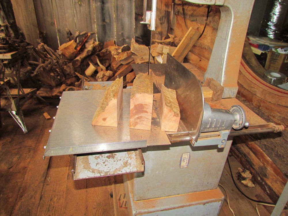

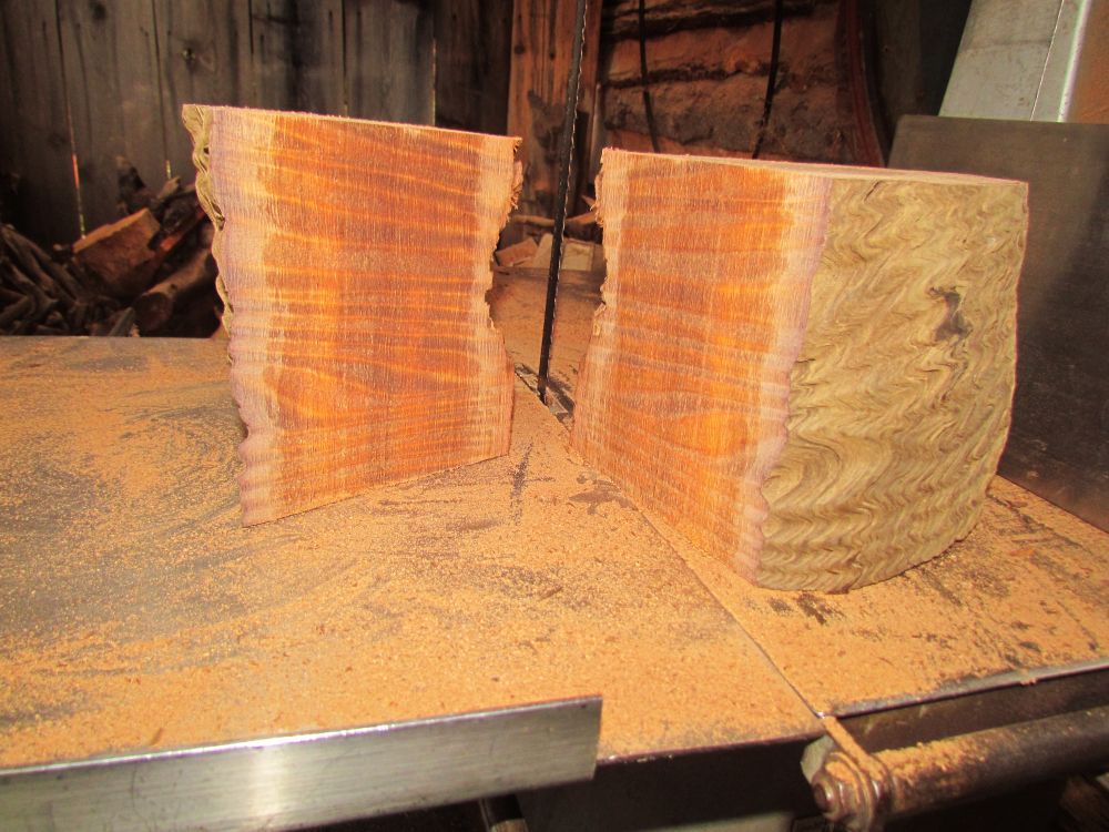

Now I cut the rest of the chunk into manageable pieces.
Then I cut a flat to go against the fence so I can cut slabs to cut blocks from.

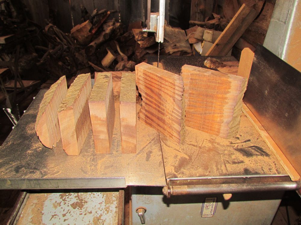

You can see that the saw blade is at a right angle to the outer surface of the wood. Positioning the wood this way makes a cut that is at a right angle to the growth rings in the wood. That is how you cut wood to be quarter sawn.

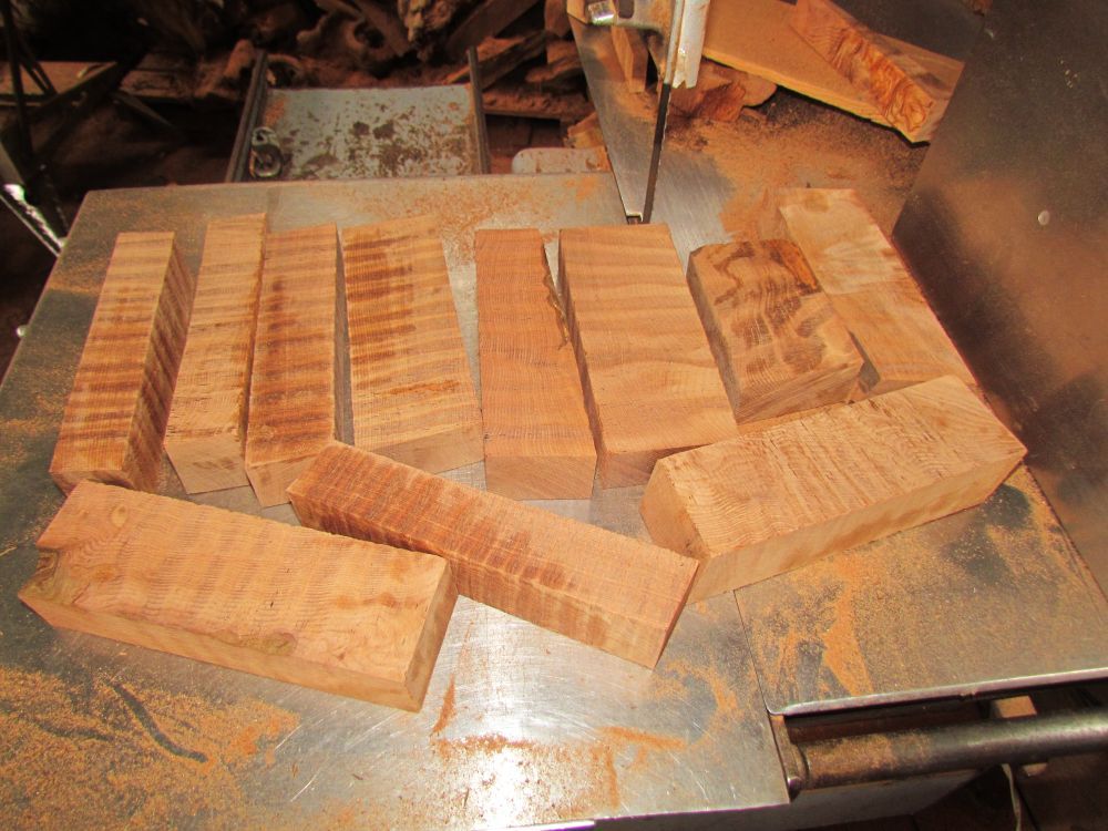

Now the slabs are cut. Most are quarter sawn or very close to it. The figure in these pieces is going to be some of the boldest figured Redwood that I have seen.
Now, hopefully I will be able to dry it without it cracking up on me.
Only time will tell.
