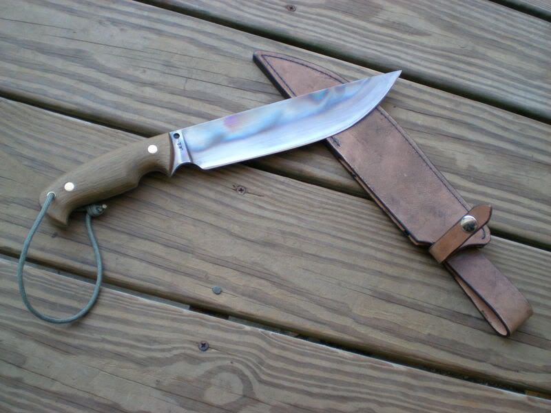

Here's a snap of my cutter. 52100 brass and canvas micarta

The cutting comp knives are HUGE!!! They use MUCH thicker stock tan you would use for a JS or MS test knife of similar maximum dimensions. As previously mentioned, they tend to lack the normal ABS style sital taper and are heavy out front. The skill of the cutter plays the largest part in these contest, but yo do have to have a big honkin' knife to cut through two 2x4's in less than 5 seconds regardless of how good you are...lol.

Chuck thats a sweet knife!
Very reminiscent of a aranyik enep. I like it
