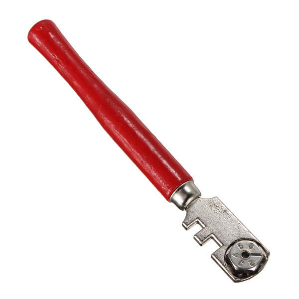

Aside from that, using carbides to score glass is nothing new.
Cutting glass...
Cheap, and works well too! :D;)
