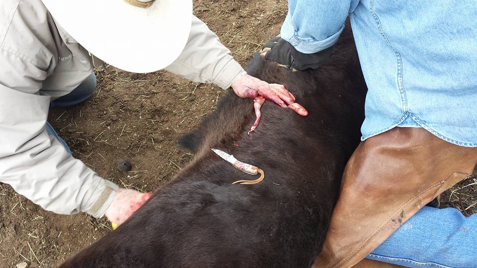

I'm not sure if I'm who Frank is talking about but I do make quite a few users out of mammoth tooth. Well use to, can't anymore since I live in Cali but I use too. These went to working cowboys/horsemen for daily carry:

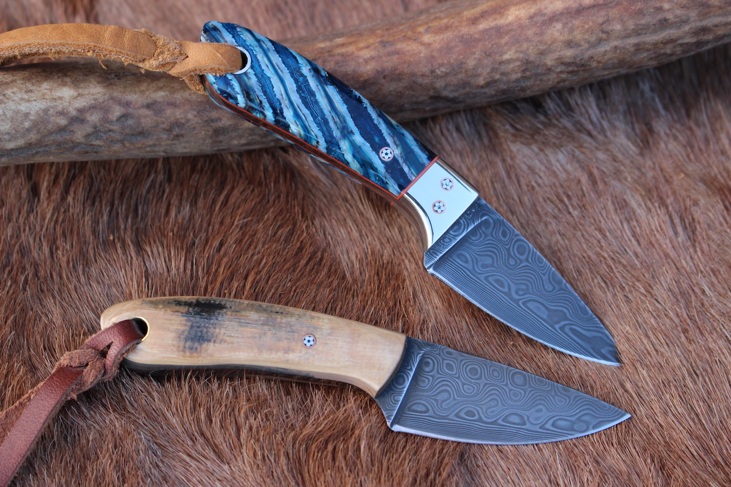

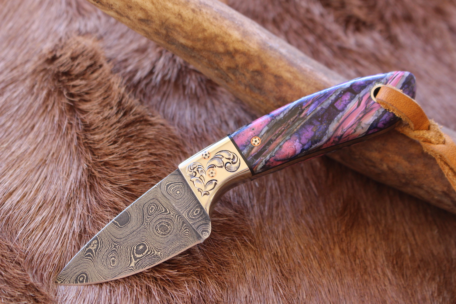

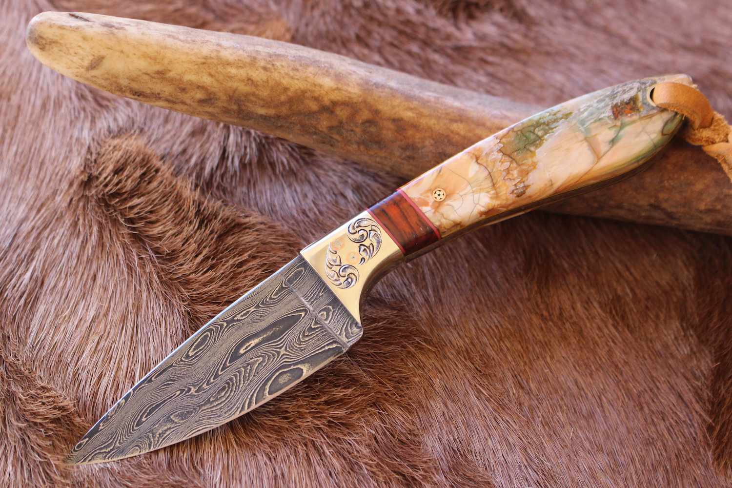

Couple more small EDCs in Damasteel:
