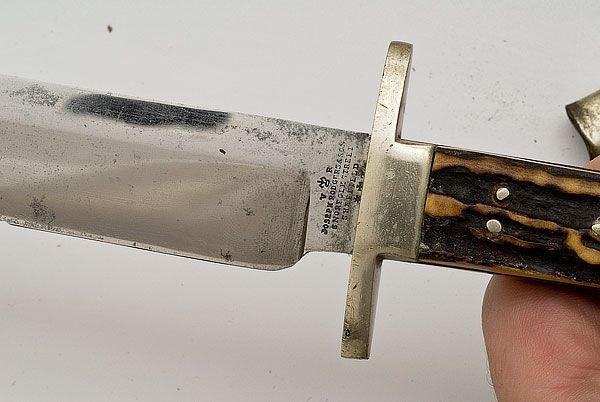

browsing coop's beautiful photographs of best knives, i did notice a widespread tendency to build large ricassos for fixed blades.
Is it serving some purpose? When push cutting generally i prefer to use the nearest to the handle cutting edge portion, considering lever principles (more direct force)... a long ricasso makes for a bad lever...unless you have a very long thumb, but then what is the handle for? :D
Jokes aside, i would like to see what is your thougths about ricassos, i consider interesting design/purposes explanations in custom knives.
- When the ricasso is too long just for soldering, to me it is not a very good reason, as you can do it properly without ruining the heat treatment the same if you do it properly.
Thank you
Stefano
I always understood that a larger ricasso is a place where you can put your indexfinger and grasp around the guard. Like Randalls
Yeah, I was thinking that big ricasso was an ABS thing. Otherwise I think most folks try to fit in as much cutting edge as possible.
One thing about a traditional ricasso is that it leaves a nice thick solid piece of steel right at the junction of blade and tang/handle. This is good for maximum strength.
A larger ricasso is a good place to put a makers mark. :D
Most forging knifemakers stamp their mark... it can be difficult to get a crisp, clear stamp on a surface that's not flat and parallel.
I etch my marks, so I can put them basically anywhere I want, as long as I can wrap a stencil around it. That allows me to do the maximum cutting edge thing.
I often forego the ricasso, completely. I do believe that the original function of the ricasso was to accommodate a forefinger. It also provides a good platform for shouldering guards. The ABS judges you on square ricassos, so it's a good idea to include them if you are testing. Other than that, no biggie.
A lot of our ideas about what a good knife looks like come from what happens almost automatically when you forge a blade out of stock. Ricassos happen where you start forging the cutting edge out of a bar, so it naturally says "forged knife."
It's worth thinking, when designing a knife, what it's going to be like to sharpen, i.e. does the thumb stud of a folding knife get in the way, or is it going to be easier with a bit of ricasso to move the start of the cutting edge to where it's easy to sharpen on a stone without bumping a guard.
I prefer a ricasso long enough to choke up on the blade, my feeling is if you are going to have a ricasso (or any other design feature for that matter) it should be functional and serve a purpose, otherwise, why have one at all? I suspect the primary purposes they serve is to make it easier to fit a guard, to have a parallel surface to stamp or rockwell test, and a convenient way to end a grind... as far as knife use, they are only useful on a larger knife to make it function as a smaller knife, IMO.
