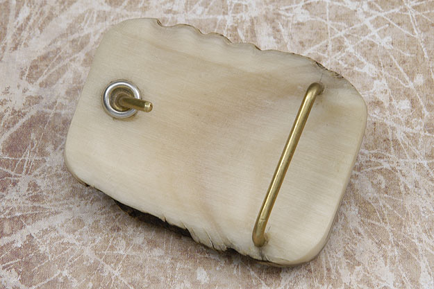

I would do about the same as mark but wouldn't steam the horn to straighten as that adds moisture to the horn and moisture + horn = warped scales in my experience. I also cut the thick outside curl of the horn to make spacers and belt buckles.

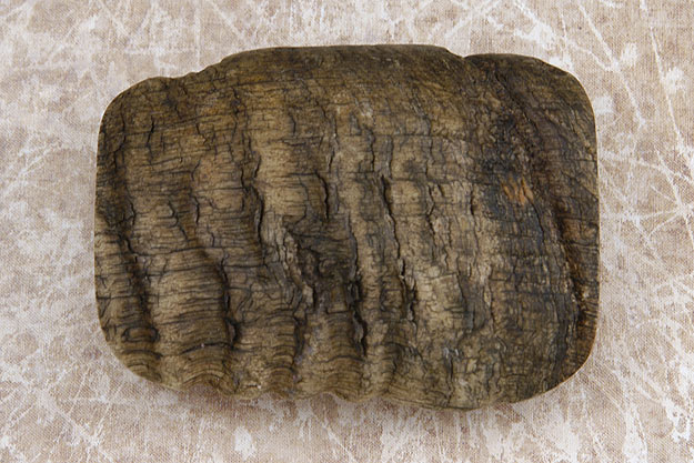

Man that's great looking material.... I have nothing really to add other than this.
