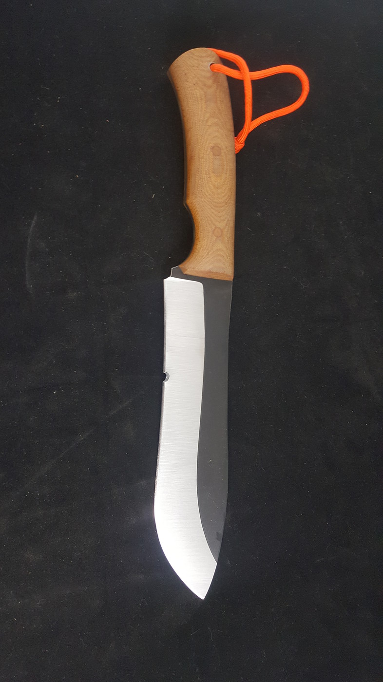

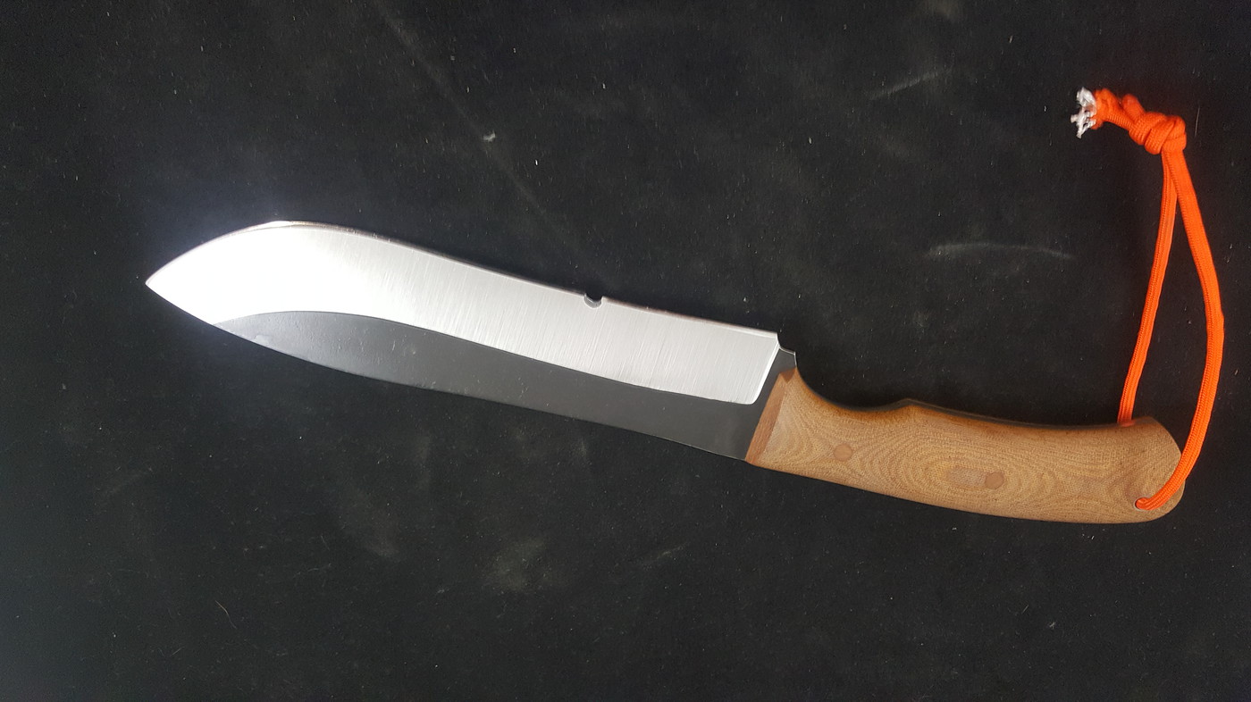

I decided to test out the BOLO inspired prototype I made. I always test out my designs before selling them, This insures the knife performs the way I intended to. It also allows me to see its strengths and weakness first hand. I tend to like to know how far I can take something before its too far or it breaks. This helps me understand the limitations of a design or steel.
Here is what we started with. BOLO inspired it has an 8 1/2' inch blade, 14 1/4" OAL. Steel O1 (.187") weighing 15.40z

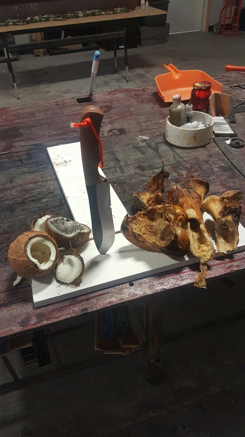

2x4 Cutting test

This next video was a dog bone the size of my thigh, This was not really a real world test. I wanted to see if it could, And it did but with an interesting twist!
[video=youtube;pmTbeB8S1BA]https://www.youtube.com/watch?v=pmTbeB8S1BA[/video]

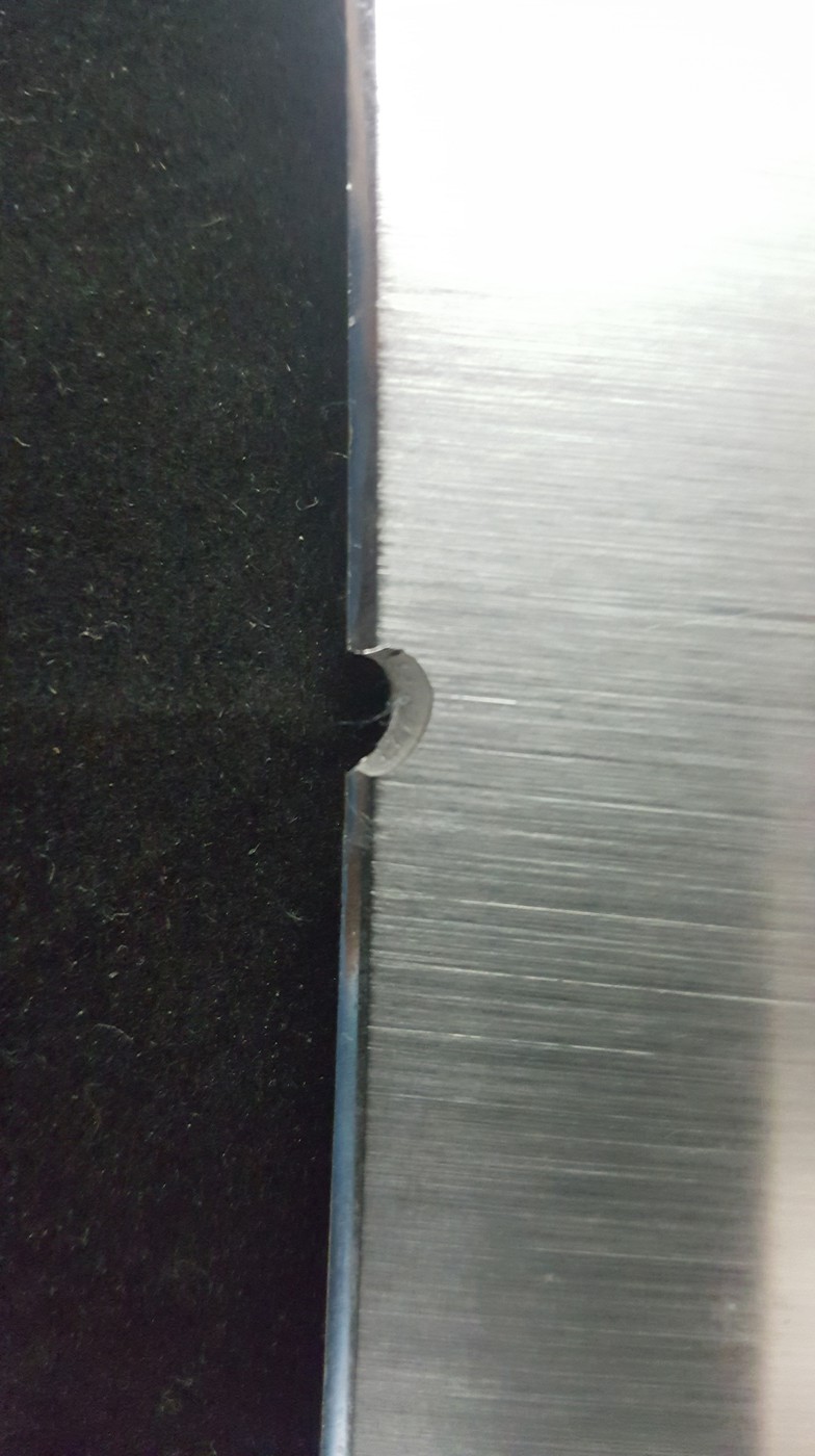

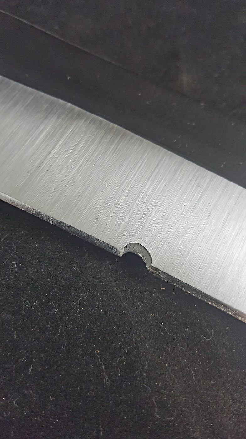

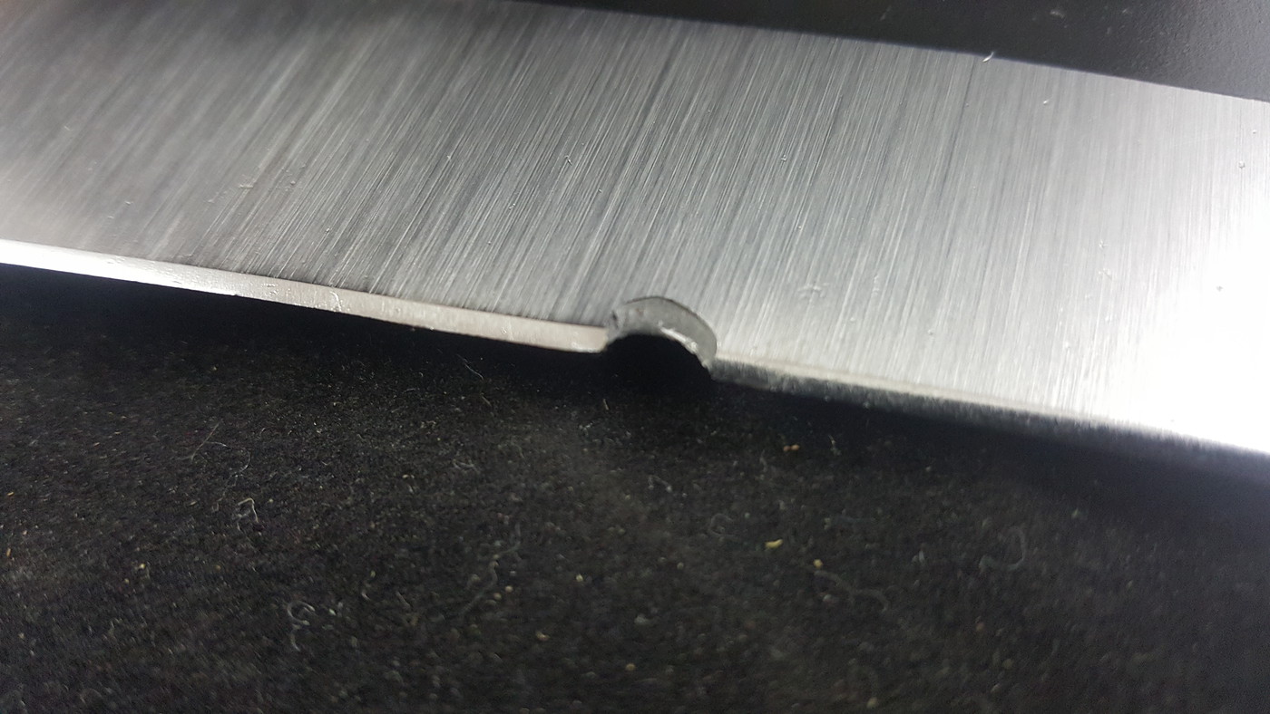

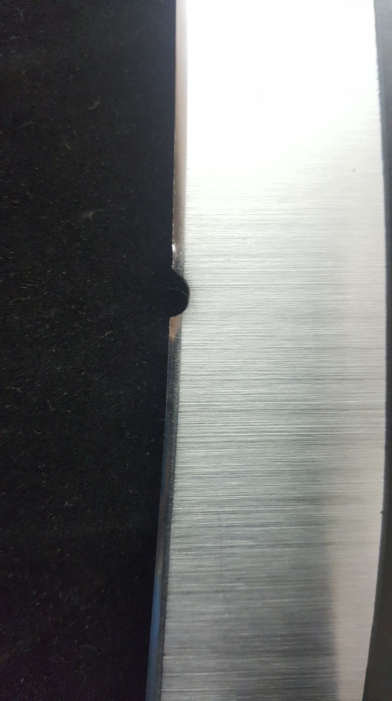

As you could see, I chipped the edge. I am not 100% sure, but from what I can tell I likely hit the metal table. Since I am not absolutley certain this is this case. I am going to build another one and repeat the same test with adjustments in the setup. This is the only way I can know for sure if the blade chipped because of the bone or table.
Since the last test was a little beyond reasonable expectations. I will still consider the testing a complete success for me. I am a little disappointed I chipped the blade because I wanted to do a pass around with it. I was not disappointed in the blades performance though.
The Aftermath!
Hosted on Fotki
Hosted on Fotki

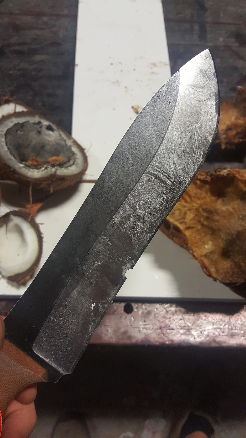

Here are photos of the Blade after the test, As I stated before I am fairly certain I hit the metal table, and after looking at the blade and edge I am further convinced.
Hosted on Fotki
Hosted on Fotki
Here you can see the chip is fairly large but isolated to one area the rest of the edge is in excellent condition and sharp!

What I learned from this test.
I really like the way the knife performed during it's testing. I wouldn't change a thing at this moment design and geometry wise. Felt good and natural in the hand. It was secure, no rolling or twisting, There was also an absence on any hot spots or pressure points. The blade felt natural and secure the handle also allowed me to choke back and still have good control of my swings.
I did however find out quickly that I should have taken more time to prepare in my set-up, This was my first time attempting to chop through a 2x4 with a knife. The 2x4 bounced a lot towards the end as it lost its structural integrity causing a lot of extra work on my part and loss of kinetic energy within the knife. The 2x4 also started to pinch towards the end, and if any of you have use a chain saw or rotar saw knows it will even slow those down in a cut. Solution build a more secure cutting platform. I also reviewed my own videos from different angles to anylize the cuts and performance of the blade. I found that I need to practice my form and execution to make more effective cuts. All this being said I think the second time around I will do better. Even though I am pleased with how the knife performed I know the blade can do better. The limiting factor was me this time.

I am sure Ivy was wondering WTF you were doing with that bone. I can't tell were or how the chipping occurred during the 6 impacts, but I would not be disappointed with the end result of that test.
Thank you for giving your feed back Danny, I will be making a more secure cutting platform next time around. I learned some things from this test. Oscar seemed a little more concerned about the bone. He had been sniffing around it for a few days. I believe the chip happened 2nd to last cut. I heard an audible ping, not sure if it picks up on the audio or not. I wasnt disappointed in the blades performance. I will be looking forward to testing the next one again.
Lol... and should there be a"next time" I'll pay closer attention, although no better place for that blade to be reground than there. I wonder if it does get a regrind If someone might do a follow-up post showing the results.
