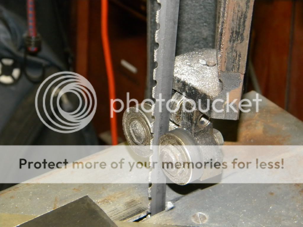

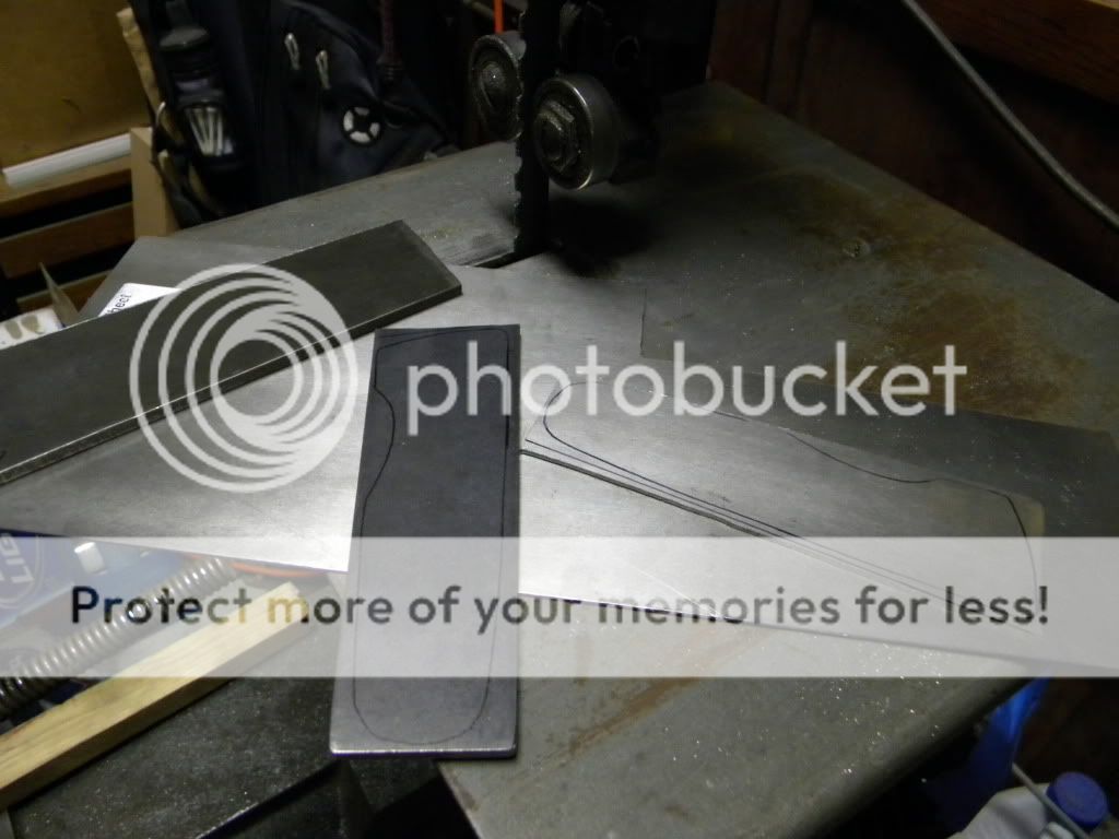

Ok, after chatting for a while with Chuck at Alpha, who cuts way more than his fair share of titanium, I broke down and spent over $100 dollars on a gulleted, carbide coated Lenox band saw blade. It finally arrived today and I got to work cutting out the liner and ti slab for my current folder project. This things goes right through the Ti without any problem using the fastest of the three speeds on my old Dayton 4x6 bandsaw. Seems steep for one saw blade, but if it lasts as long as I'm lead to believe it will be a very good investment.:thumbup:

I would recommend these blades, very cool.
Hey I think I would like to try one of those Johnny. Do you use them on all metals or just the titanium? Frank
