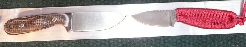

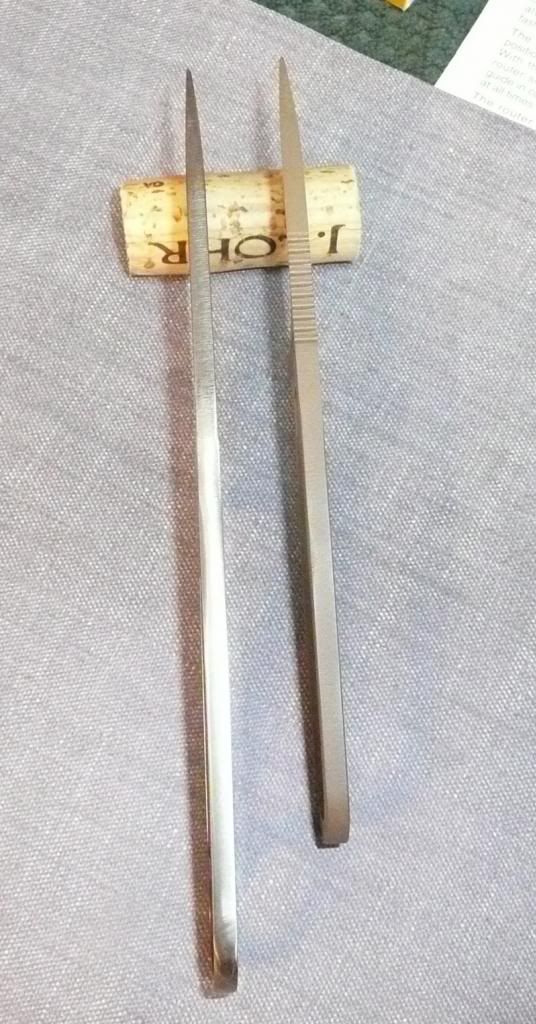

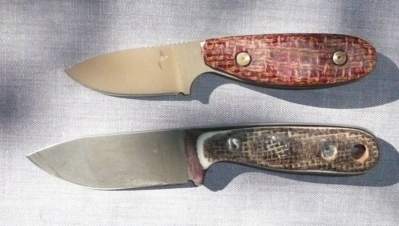

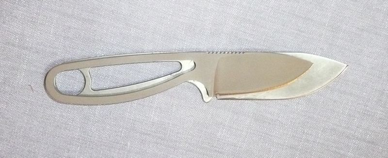

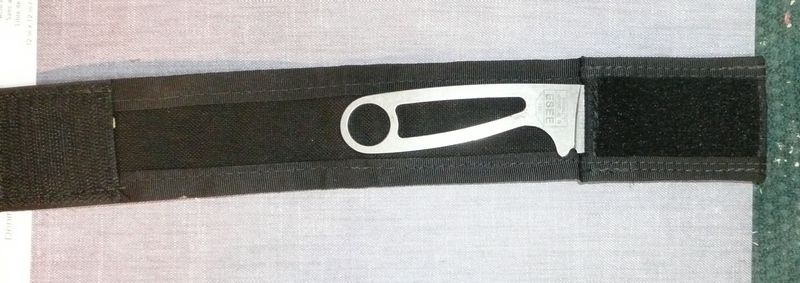

Here are some shots comparing it with my beloved BK24. I took the mycarta scales and paracord wrap off to make comparison easier.

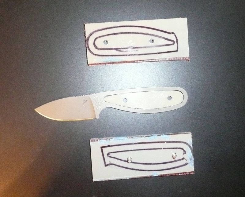

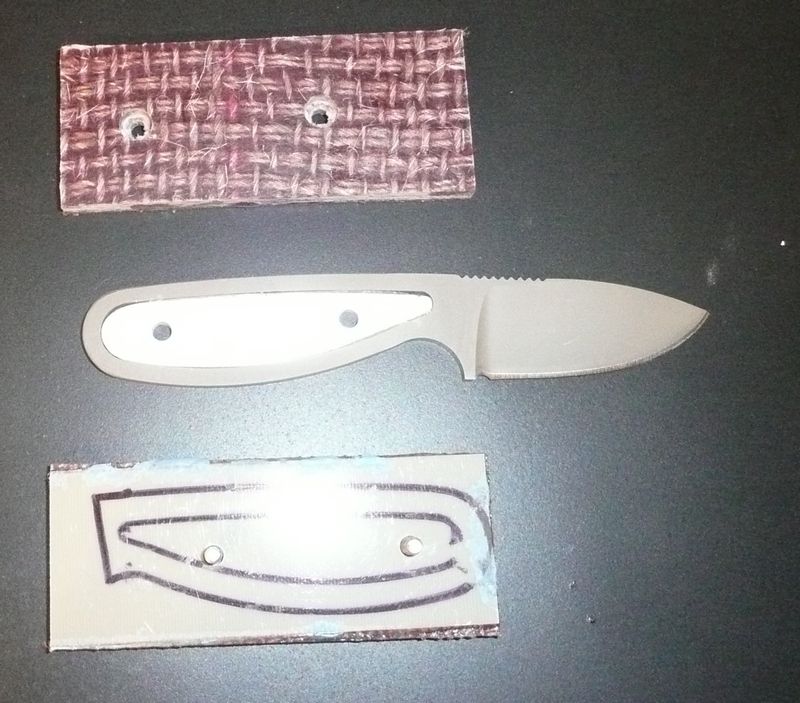

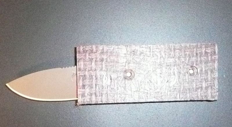

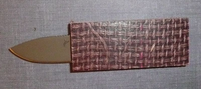

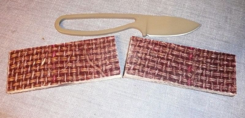

As with the 24, for my big hands and slight clumsiness, I think it needs some scales. Not sure it warrants it, but I've long wanted some Shadetree Drunken Coffeebag Burlap. So I picked some up. Epoxied some tan G10 below because, well, that's just how I roll.

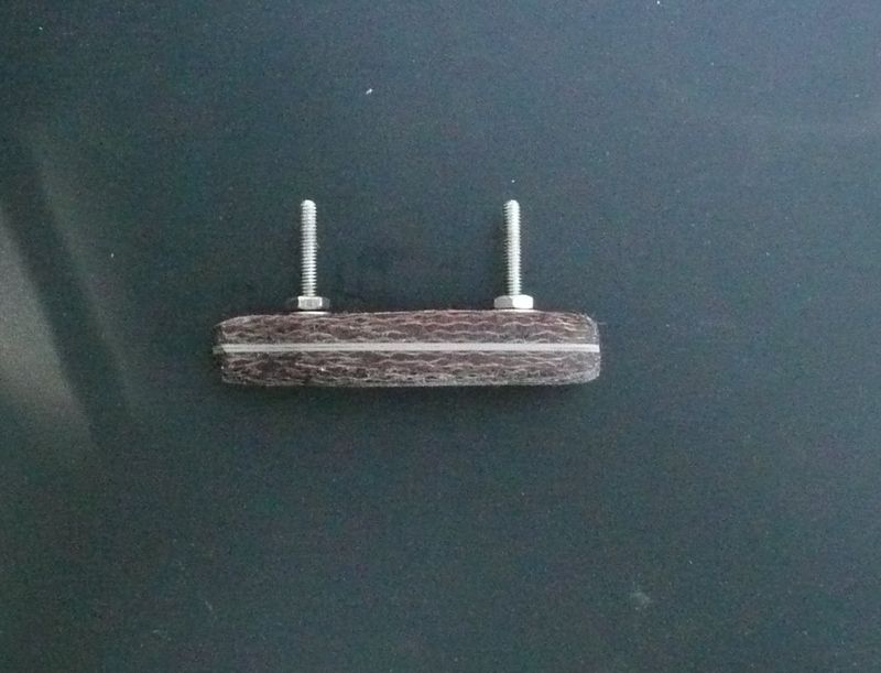

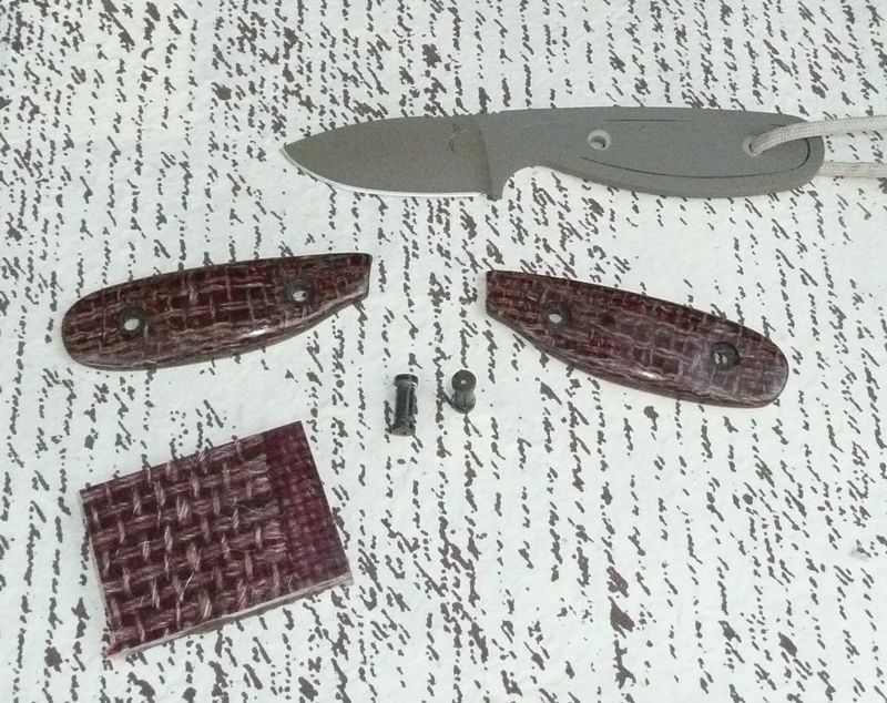

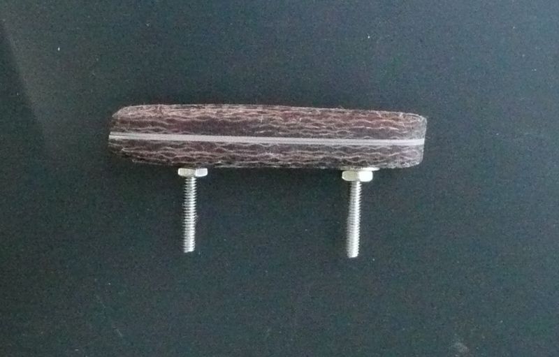

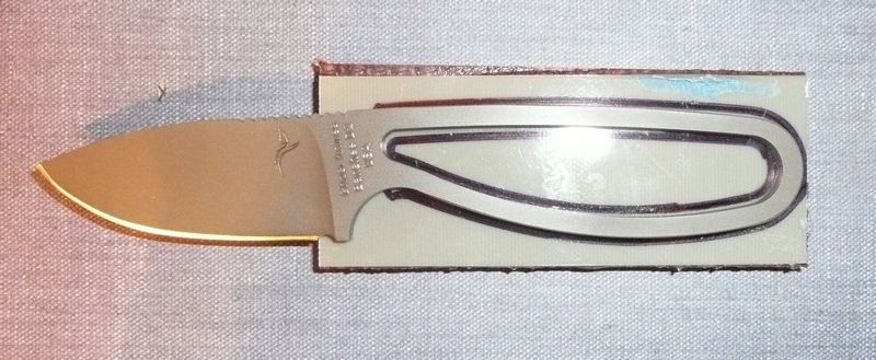

I ordered some hardware, and started the counterbored holes to fit. Rather than the nightmare of grinding an inset in the scales to fit the handle cutout, I trimmed and ground a piece of 1/8 aluminum to fit the cutout. Since it was kinda thin, I bonded a spare piece of .030 G10 onto one side.
Now I need to figure out how to size and shape the scales without grinding off the cerakote. I figure I'll go slightly smaller than the handle, but larger than the insert, like ESEE do with theirs. But that means freehand for me, so who knows how it'll turn out.

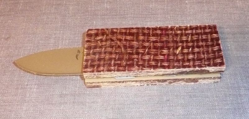

I made a little progress on the scales. Shaped 'em out and cleaned 'em up with mineral spirits.
I think I cut them a hair short, which won't hurt usability but may impact cosmetics slightly.

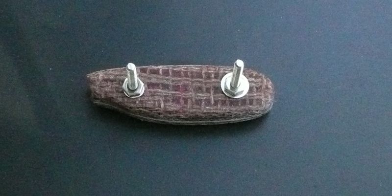

You might want to use some smaller bolts, unless you're going for the "locked finger position" in which case those might work!
Ya think?
Just waiting for some short screws and hidden barrel nuts to show up. Any day now...

Guys,

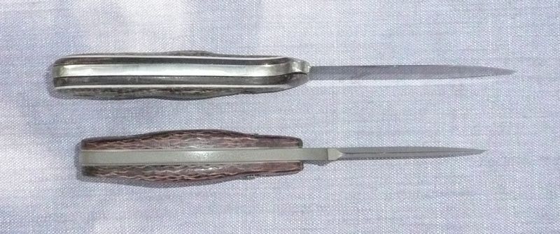

I ground the scales so far back that it exposes about an 1/8 inch of the tang cutout and insert. I know the guy who had it coated, so I think I can match the color okay. But I need to create a smooth transition from the aluminum/G10 insert to the coated steel tang. I don't necessarily need to bond the insert to the tang, but doing so would not hurt.
What can I use as a filler for the gap? Epoxy? Liquid Metal? JB Weld? Other? In doing so, will I need to strip off the cerakote and sand/roughen the inside of the handle? Or can I bond directly to the cerakote?
It presses in there tightly enough to not move on its own, and will be held securely to the tang by the scales when installed. But I need to fill the unsightly gap, at least on the front portion of the cutout. It's aluminum on one side, with G10 epoxied on the other. I'd prefer to use one material to fix both sides, but if they aren't too expensive and the conatainers not too large I'll consider one for the plastic to steel bond and a different one for aluminum to steel.

Here's a quick pick of the exposed insert:

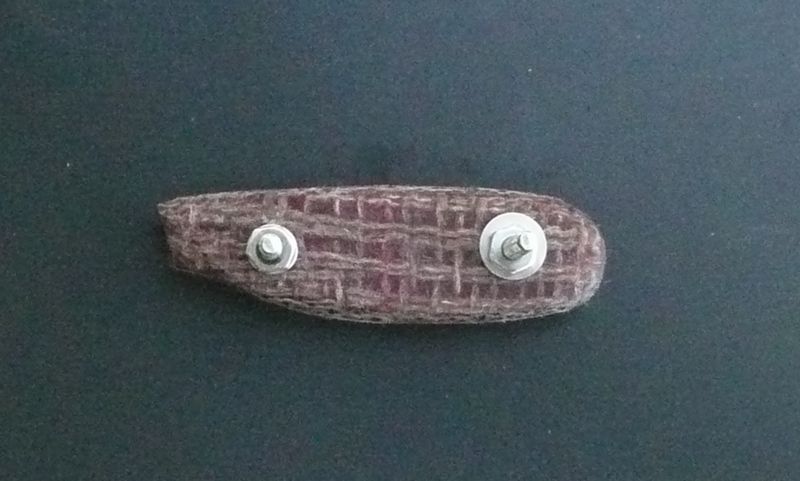

Hand-sanded FOD's finest - the Shadetree drunken burlap - to 2500 grit.
Patched the gap with body filler.

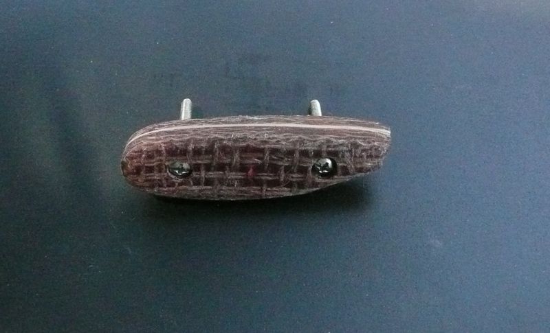

Scales were rather flat. Shaped 'em a bit and re-sanded to 2000 grit. Cleaned with alcohol followed by mineral spirits.
Touched the brass hardware with gun blue - not quite the deep black I had envisioned, but a very dark brown to be sure. It should work.

Pics are back up so maybe I'll get a couple more today after applying a couple coats of BLO to the micarta.
I thought the Cerakote was rough. My lumpy application of AlumaHyde II makes the cerakote feel smooth as glass. The color match is pretty good - the Brownells seems to have a touch more green in it.

Regardless, I know most Beckerheads are visual , so I thought I better add in a pic ;)

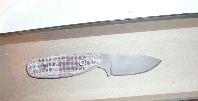

Parts are nearly done; epoxy paint is curing, and scales need 1 last coat of linseed oil. I think I mostly fixed it:
What did you fill the handle with?
Filled the forward gap between the handle and the aluminum insert with auto-body filler (lightweight bondo-like product.)
I didn't use as much as, perhaps, I should have so there's still a slight gap. But I didn't have the right hardener and it was a mess to work with, so I'm calling it good enough. The rest of the gap will be covered by the scales.
The paint may not be completely cured, but it is certainly dry. I get impatient sometimes, so I put the handles on.
They really help lock the knife in place in my hand.
A little chunkier than the ones I did for the 24 - they offer great purchase.
Rather than being ground flush, they're inset a bit like the Izula micarta. Perhaps not the most beautiful things around, but they'll work on a working knife.
I like 'em.
