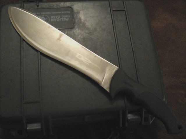

I'm starting to think the outcast has some magical heat treat, I see yours likes abuse too.
I doubt its anything special but with all the talk about chipping and breaking like glass and whatever else has been said, I just don't see it. I have a nice thin convex on the edge too and still no chips, even when I hit rocks.
Woowee, that thing looks sweet! Gotta love Kershaw's innovation and value for money no matter what size blade you're looking for. I think I'll have to put an Outcast on my list.

My Outcast has lived a hard life...it's even thinner now...still holding up like a champ!

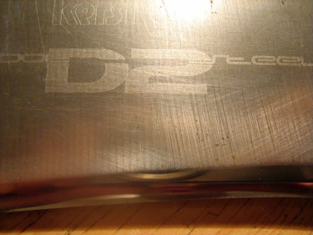

D2 is just shy of stainless and will rust or patina but takes a lot to do so. I have never oiled my outcast and until I took this pic I have never seen rust on it before. D2 is tough but I would still not try and do heavy prying with it, its lateral strenght is not that high and will snap like a twig. I've pryed with my outcast but you can kinda feel in the steel just how far you should and should not go. I would love to see what the blade does under a high speed camera though, it feels like there is a lot of flex to the blade under hard chops. The lateral strength thing still has a big ? that comes with it because the blade geometry can play a big part in the outcome of that.
Nice pic J :)
