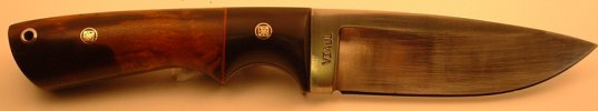

As mentioned inn shop talk I have had a piece of D2 plate cut into 36 blanks by GreatLakes WaterJet. I am starting to get the first batch slowly finished. #1 I took to work and after chopping a 16 penny duplex nail in half with 2 hammer blows and showing no edge damage it was sold before I could get pictures. The heat treat I am using is 30 min+ in stainless foil in digital controlled oven, aluminum plate quench, 2 hr+ at -100f with acetone/dry ice then into the oven at 450f for 2 cycles of 2hrs each. These will take a hair shaving. paper slicing edge and keep it. There will be some in the for sale section soon. Thanks for any comments Jim
Overall is 9 1/2"
sharp edge 3 3/4"
spine is 3/16"
depth is 1 3/8"
Desert Ironwood burl
red spacer
Black paper mycarta
Mosaic pins

Thank you, Yes they do cut you can hold a sheet of paper and with a quick slash cut it completely in half. Don't hit you fingers!

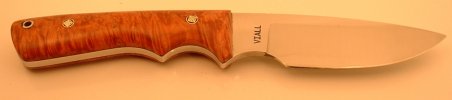

Here is #3
Scales are Miniwax wood hardener stabilized Redwood burl
#4 is ready for the handle sanding and coming up

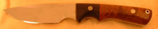

and #4 is done
D2 of course
No finger groove forward of the guard area
Black paper micarta
red spacer
Ironwood
