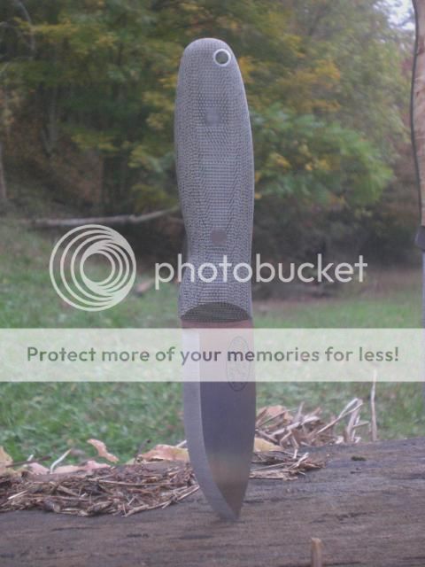

I have a Brian Andrews small knife in D2. I also have a Charlie May. I like both.
I think the key is intended use.
I have cleaned out deer with this little knife and hit bones and stuff w/o any chipping
