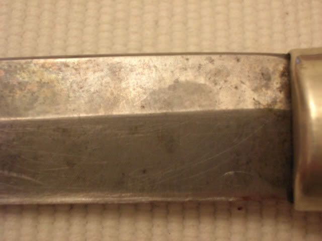

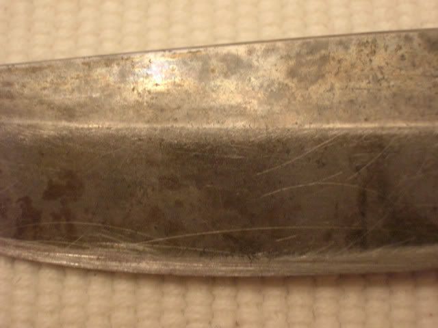

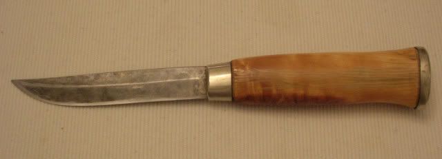

Why worry about patina?
This is my beeter knife, made of non-stainless steel. It is more than 20 years old and survived being my childhood toy. (Boy, was I surprised how ugly the scratches look when magnified like this. The knife needs a new handle, too.)
I have a couple of other carbon knives, e.g. Cold Steel Trailmaster, Peltonen Ranger Puukko. Now and then they get stains and sometimes even mild rust, I just wipe and oil them but let the patina stay. The knives still work as intended.
