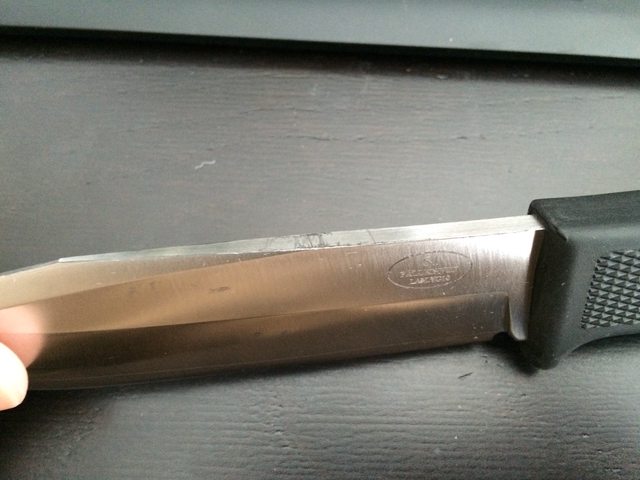

Hi everyone,
I have only recently started using a firesteel (or, "ferrocerium rod" is you prefer). In using it with my knife, I noticed that the firesteel scratches and damages more than I expected the sharpness of the spine of the knife (see pictures below). More than normal because I think that I would have to sharpen the spine with some sandpaper after every 2-3 uses. Is this normal?
By the way, I've observed a similar thing even when using a different knife...

Normal. A lot of the marks wash off. I don't usually get much actual wearing of the blade. There are differences:
- some firesteels are harder than others
- laminated blades have a softer steel on the outer layer, which is what you ate using there
- differences in pressure & angle affect performance.

All good points. The other knife I also noticed the damage was not laminated steel, though (ATS-34), but I guess this might mean that my firesteel is perhaps a harder one...

I used my standard F1 to strike a LMF rod and it left some marks too. In the future I'll probably just use the attached striker instead.
You will damage the top of your knife doing this. Or I guess you could just call it wear. Not much damage to speak of, and mostly cosmetic. The sparks coming off thoe steels are hot. Add in the friction. And as they say, "That's going to leave a mark"
That being said. Like Eric, I just carry the striker. I can always use my knife if I lose the striker in an emergency situation. But that road travels in both directions. It's nice ti have a striker and steel if you lose your knife too.

Especially when I have a few hack saw blades in sections. They are completely flat. Light, and throw good sparks.

If you don't like what it does, just bring a small part of a hacksaw blade with you to strike the ferro rod. Works better than a knife blade anyway.
I use a Blue Hawk carbide knife sharpener (just like a Speedy Sharp but cheaper) that can be found at Lowes as a striker. And before that I was using a piece of a broken off fingernail file as a ferrorod striker. Both work much better IMO than the spine of a knife. Personally I'd rather not muck up the spine on any of my knives with ferrorod burns.
This. The ferro rod that I got came with the little hack saw blade piece.
