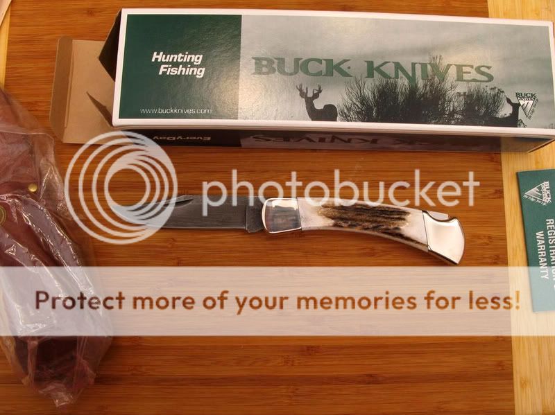

I just received the Buck custom shop 110 with a damascus blade that I bought from a forum member and a thought occured to me.
How does the damascus rate among the various blade materials that Buck offers? Is it just for show or could it hold up to daily use?

:thumbup:Thank you, it's nice to hear that it's not "just another pretty face".
Thanks guys, I appreciate it. I really like the stag on this one, it's matched really well.

Plum that is a sweetheart of a knife. Is this one a display knife?
I drooled over this one for a long time. I have a damascus/stag too but not nearly as sweet as your new one. I know you'll enjoy it.
Nice one Plumber, looks almost identical to the one Club knife I have, love that stag!
