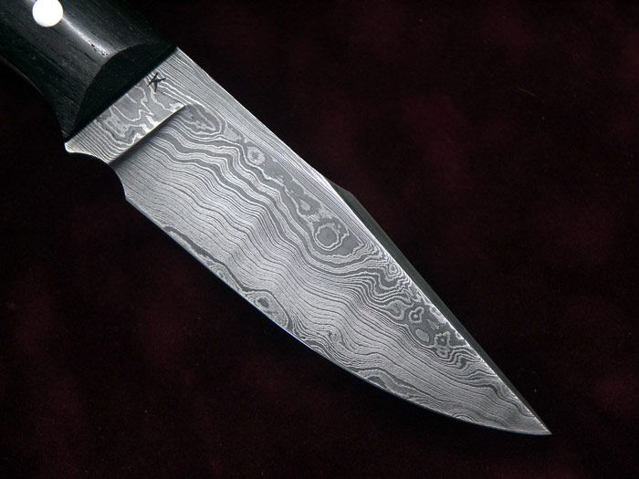

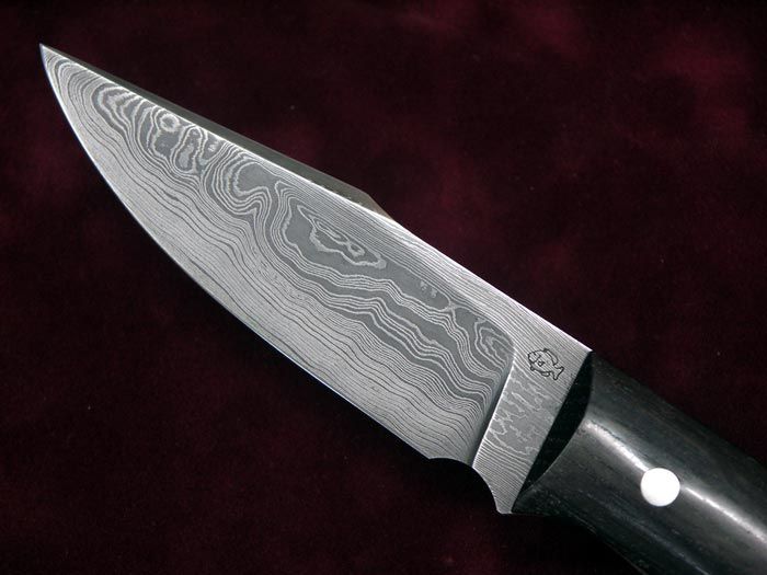

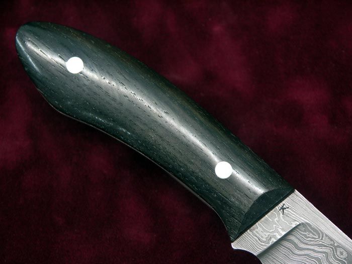

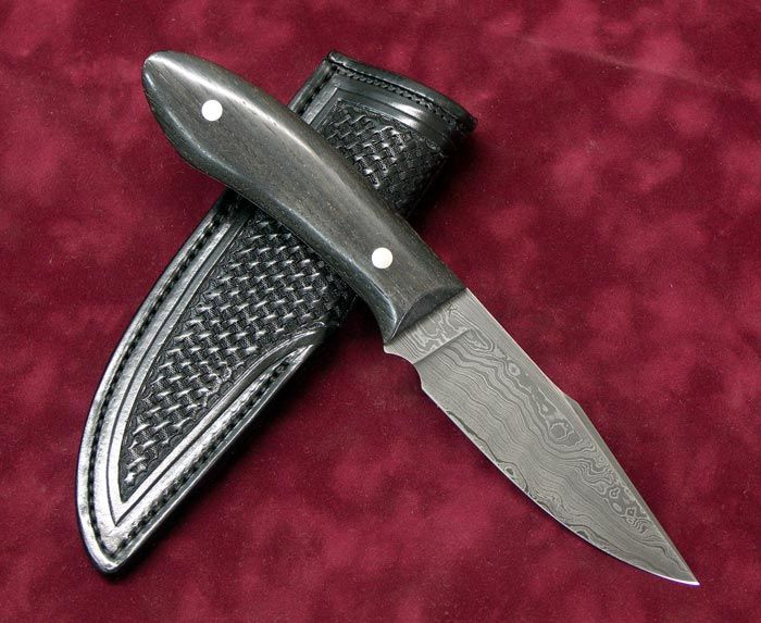

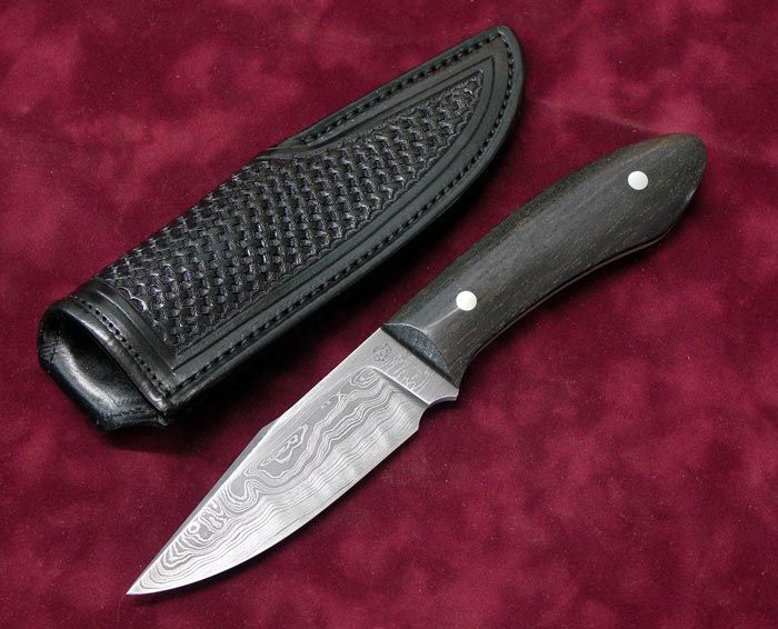

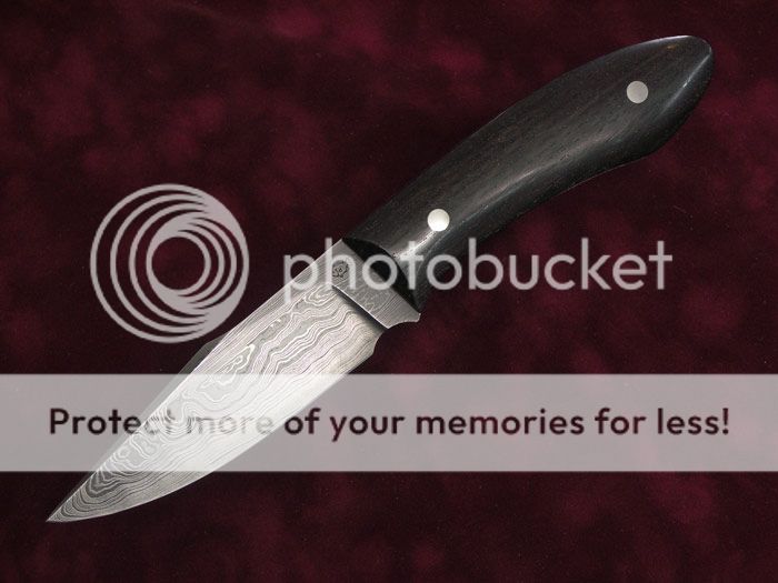

Here's Kyle's latest (#5). We're calling these collaborations. My sunfish mark on the front, K for Kyle on the back.
This one's made from the same damascus billet as my MS test knife. 300 layers 5160/15N20 random. 4.5" blade, 8" over all.
Handle is stabilized Bog Oak, carbon dated to 5460 years ago. Very Cool Stuff and the most expensive wood ever in my shop.
The design was inspired by a Sam Lurquin design that I am making him. Kyle really liked the design and wanted to do something similar. It works for me.
Paul finished it off with a Very Nice sheath!
