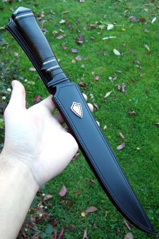

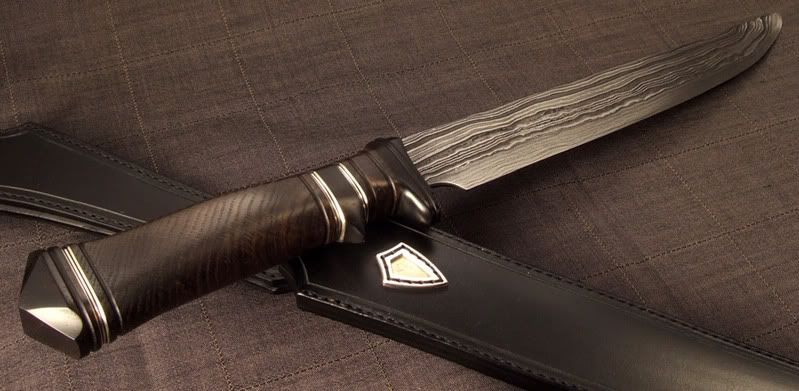

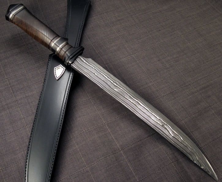

Perhaps a bit different to my usual knives...?

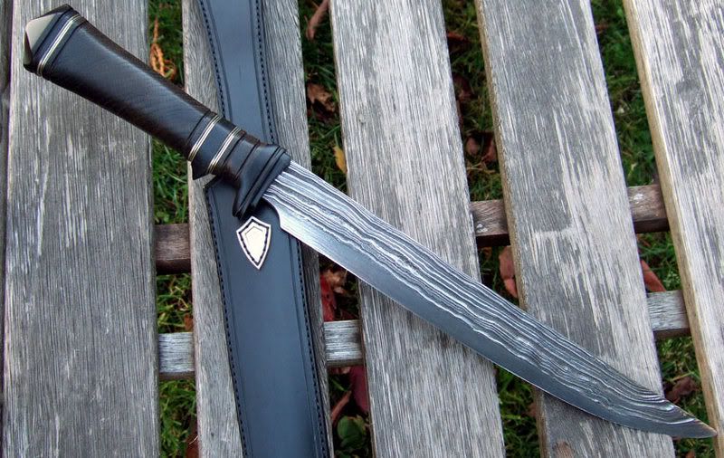

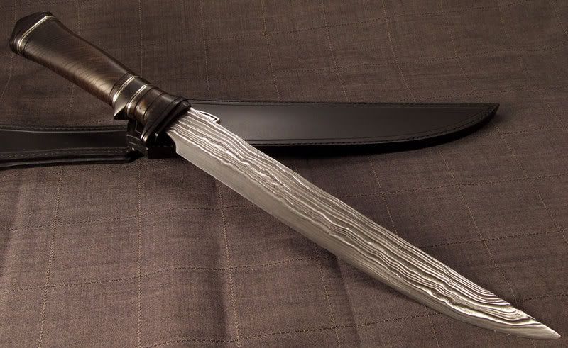

Anyway, it is made with a very deeply etched Citadel damascus blade, aprox 10" long.

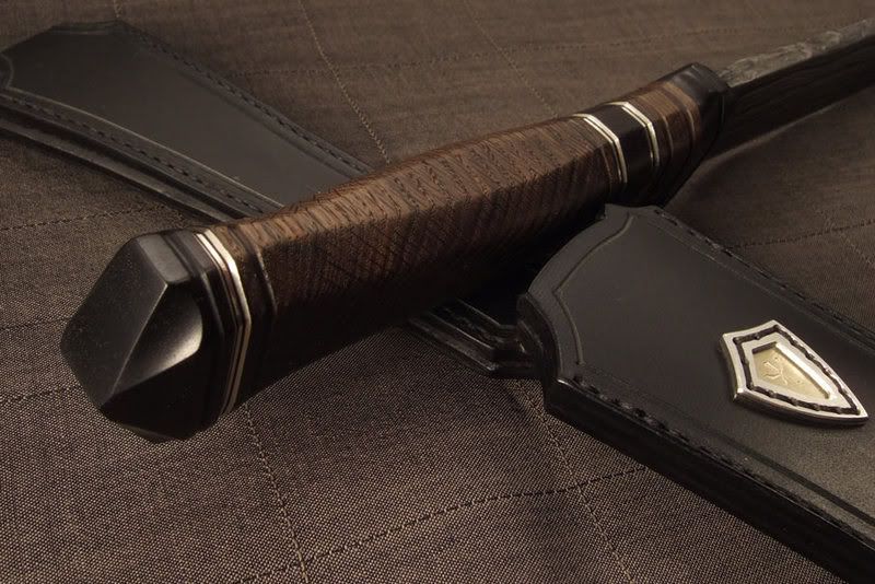

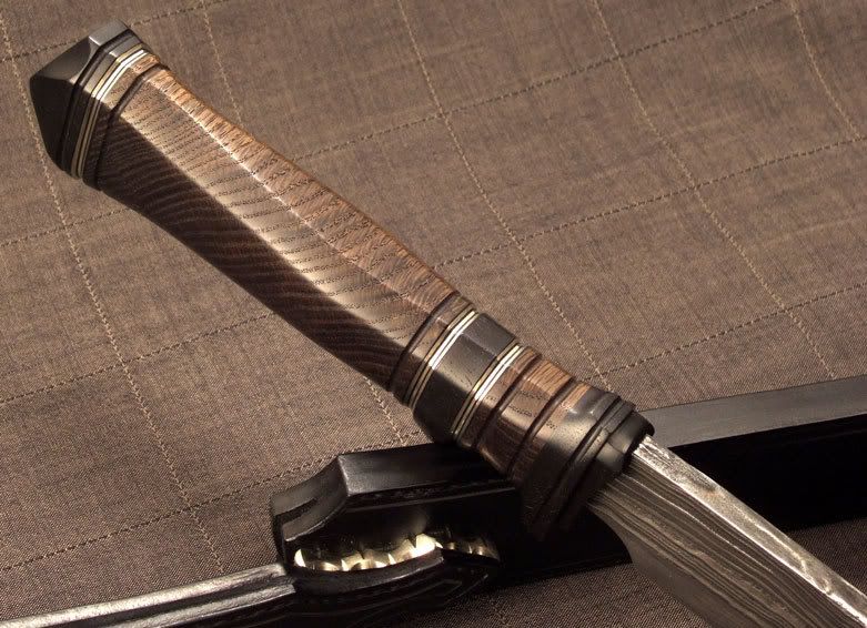

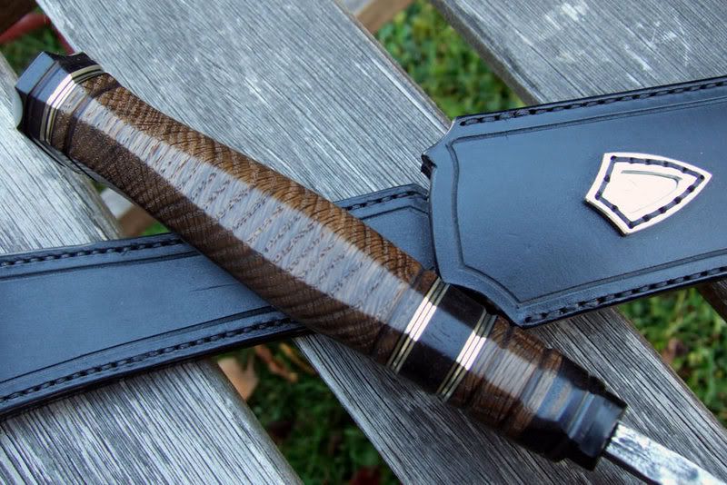

The handle is made with bogoak, ebony, nickelsilver and a small piece of buffalo horn at the very front of the bolster.
I added a steel weight as far back inti the handle as I possibly could to balance out the light materials in the handle.

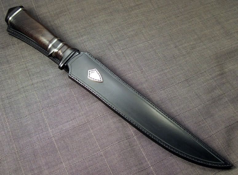

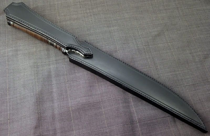

The sheath is not wetshaped for a change, but I did drill about 500(!) holes in it
The bottom of the "sheild" is nickelsilver and the "frame" is pewter.
There is also a fileworked nickelsilver spacer between the sheath and the beltloop.
Don`t really know what type of knife this is...., something between a tanto and a bowie perhaps
Anyway, it is a slim and "quick" feeling knife.
I am quite happy with how it came out, allthough I had some doubts initially.
Let me know what you think, as allways, all comments are appreciated!
Thanks for looking.
Regards
/Magnus
