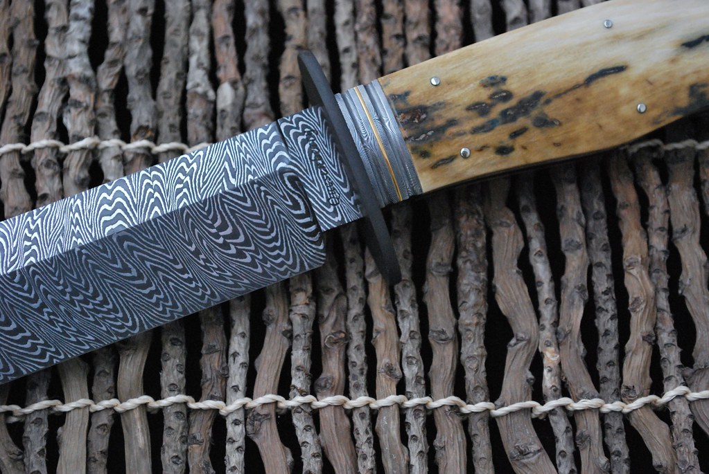

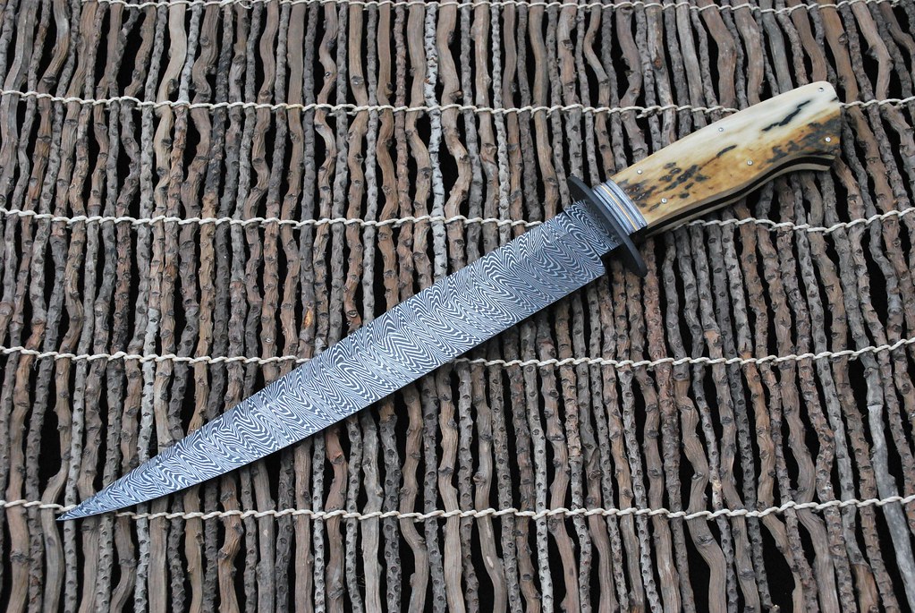

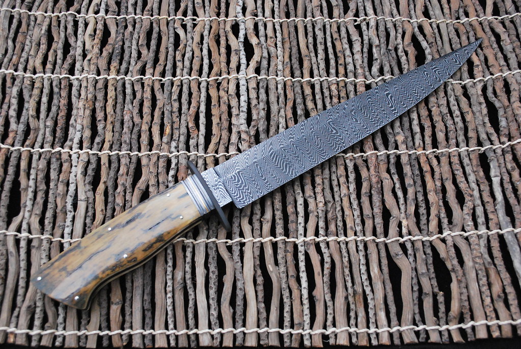

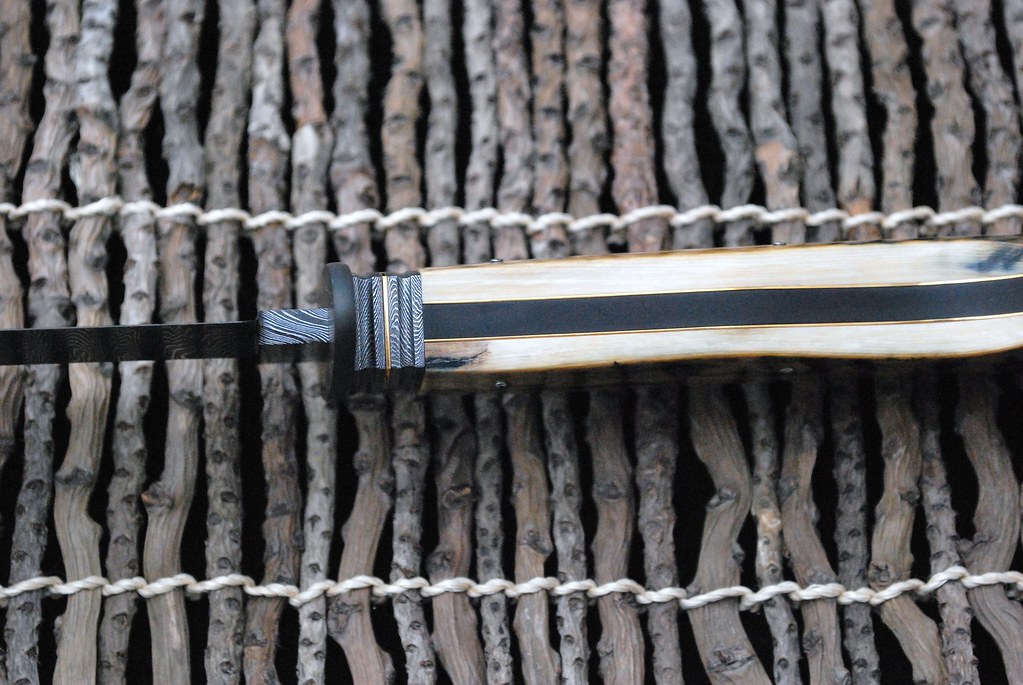

This is a 10" bladed fighter with a double grind and tiled W's of 1084 and 15N20. The OAL is 15". The frame and guard are O-1 that have been parkerized along with the damascus. It has NS liners that have been gold plated and twist damascus spacers. The mammoth, being the first time I've used this material, is held to the frame with NS domed pins. With the guard and frame I was going for a dark and ominous look to contrast the gold and shiny ivory. Hope you like it.
I'd like to thank Chuck Richards for his words of wisdom and encouragement in using the parkerizing for the first time. Rodrigo Sfreddo told me about this stuff a couple years ago and I never bothered taking the time to use it. All my damascus will get it from now on. It's great stuff:thumbup:.

The parkerizing turned out great. A question about the O1 parkerizing:
Did you use the same product? Is it phosphate manganese?
Did you etched it first? I mean the O1. Never tried it in non damascus steel, it looks great!
Congrats on the whole piece.
Manuel, glad you like the knife. Yes, I used the same manganese phosphate as the damascus but no I didn't etch it. I finished it to 500 grit and did multiple cycles in the parkerizing.

Mike, did you parkerize the blade too and if so, what did the the manganese phosphate do to the 15N20? How hot did you have to get the solution?
Joe, It turns the 15N20 black and then sand down to 2500 grit so the 15N20 shines and the 1084 stays dark. The temperature of the solution is around 180 degrees so the tempering of the steel isn't affected.
Geez. that's nice Mike.. I love how you take the point out so far. There's a delicacy about it but oh so dangerous. Super clean too.. man I need some lessons.
Mike, The blade just moved while I was looking at it. Great looking knife! I've got a feeling I'll be seeing this one in Boise....... That's a neat looking back drop, what the heck is it?
Sorry Ray, No coon fingering this one in Boise. It got shipped to the collector this afternoon.
The backdrop is one of the Mrs. table placemats:eek:. It's just sticks tied together.
