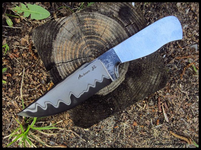

Three layers would technically be a san mai blade as opposed to low layer damascus, and if you tried to "ladder" it, you would get a sort of wavey or undulated look from the outer 1080 steel layer. It probably wouldn't end up all that bold or striking looking... for a stiriking contrast san mai you'd go with a stainless steel jacket, like 420 SS.
Here is an example of what I'm talking about, it's a san mai blade made by Karl B Andersen. You can see the waves, or undulations in the outer layer stainless steel, which he achieves just by drawing out the billet, I think by using rounded drawing dies on a press.
Anyway, if you ladderd a 3 layer billet, the dark core steel portion of the waves would just go all the way to the spine, if that makes sense..
You can make any pattern you want to, I guess I'm just saying that your idea wouldn't quite look like a zebra pattern.. I do hope you post some pics of w/e you come up with though. :)

I'm not really a damascus maker ( yet! :D .. I've made some small billets in the past) so I'm not well versed in how the more unique patterns are made, but my best guess would be that he incorporated a twist somewhere in the patterning..
But regarding that strider, seems like your original thought actually would be the way to go about getting that look... by doing a ladder pattern on a san mai blade. You could make two billets so you can also try using 1080 as the core steel on the other to see which one gives you the look you like best.
