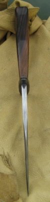

I've been on this forum for awhile, but never posted anything on the Custom Knife portion. I met Keith Montgomery at Josh Smiths hammer-in at the beginning of the month, and have re-thought where I should be showing my knives for pointers and comments.
I made this one recently, and it has turned into my personal camp/baby chopper. 5 1/2" 300 layer 1084/15n20 blade, 1/4" at the guard, mild steel and blued fittings, cocobollo handle.
Comments, good and bad, welcome.
Thanks,
Clint

That's a fine piece Clint - nothing about it I don't like. Gorgeous piece of wood, too. I hope we'll be seeing more of your work.
Roger
Great little Bowie. Handy to carry and will tackle many task.
Nice damascus, fitting and cocobolo is one of my favorite woods.
The mosaic pin adds cosmetically.
And a functional sheath for carry.
Bet it's affordable too.
Looking forward to seeing more.
Very nice looking knife. enjoyed looking at your site too.
could not resist playing with the photo abit as I'm not used to seeing Damascus this light so wondered if it was actually darker like this
which seems to still keep the color of the handle
Thanks for the positive input. The lighting is a bit off, but this blade was actually mirror polished after etching, so the contrast isn't quite as definate as Murray's touched up pic above. I normally just take damascus to a 1200 grit hand-rubbed finish, but I've tried a few polished blades, and like to mix it up some.
This one turned into a personal knife because of an inclusion in the damascus that I figured I didn't want to let out of the barn. It is on the top of the ricasso area on the "right" side, as shown in this pic.
Clint

Nice!:thumbup: Beautiful damascus, beautiful wood. Nice fittings also!
Kind regards,
Jos
I'm really warming up to this subspecies of the bowie and its "intermediate" functional niche. I think your knife is a worthy representative of the genotype. From the ferrule forward I can't see how it requires significantly improvement.
I also applaud the risk you took with the contoured handle. The greater the animation with contours the more one can run amuck, hence, the risk. The safe way is a straight handle with a truncated butt. With some notable exceptions, I may put my hands together for such a knife but most bowies sending me to handsprings these days are those with "Anna Nicole Smith" (aka Jason Knight) handles, seducing and indulging the fondling hand with curvaceous splendor and providing it with something to hang onto, lest the g-forces needed to detach a 3" sapling from its ankles in a single whoosh wrench it from the grip. Yes, those big, audacious bowie blades need voluptuous counterbalancing on the other end, in stark contrast to smaller knives, where simple elegance is often enough if not preferred, at least to my liking.
The rub, of course, is in the curves, and many would be Anna Nicoles end up like Mona Munchie, the pear-shaped, 400 pounder liven on cheeseburgers and fries. While Mona has plenty of anti-curves to grasp, who wants to?
Your curves pass my full-bodied, sexy test posterior to the pin, but forward of it the handle changes character a little awkwardly to my eyes into something stiff and slabby. Improve that transition and this nice bowie becomes pretty special in my book.
Don't fret, though, because Mona still visits Jason's shop occasionally, especially when handle billets are too small at the onset.
ken

Ken, that is quite an interesting comparison on handle shape vs. Anna Nicole and Mona, quite appropriate. Another reason this knife turned into my own instead of up for sale, the handle was originally more "full bodied" up front, but of course bad things happened when I put the pin in the hole, taking a nice size piece of the handle off the opposite side. I didn't feel like starting over, knew it wasn't leaving home, so instead "slab sided" it and blended it in.
Jason Knights handles are the first I recall with the great curves as you mentioned, and was my inspiration for this one.
Clint
