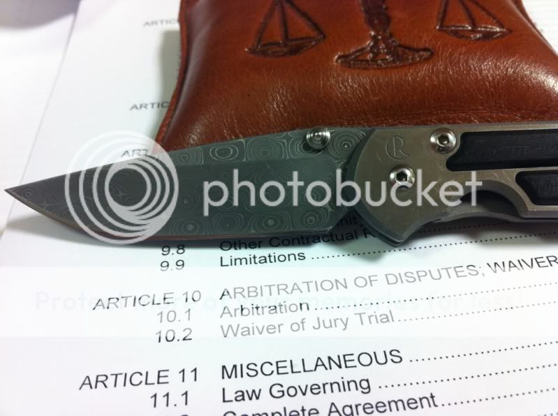

I have a DT raindrop small 21 with ebony. It is my EDC. I cut up some boxes with it just to see how it would do. There were some light scratches left in the blade pattern. Nothing major but it does show some wear. It would probably come out it I re-etch the blade.
The issue I am having with the steel is that it does not want to bite into anything. Maybe I have the edge overly polished for this steel. I normally use ultra fine rods. I tried the fine rods and the issue remained. However, my classic in S30v is sharpened the same way and it bites. So do all of my other knives from Spyder Co (VG10, s30v, CPM m4), and my protech Sprint in s35vn. It shaves very well but getting it to bite into anything fibrous like paper is difficult. The material slides over the edge. When It does get a cut started it slices just fine.
I think the blade performed very well out of the box (iirc) but now it has this quirk. It very well could be something I'm doing when sharpening it on my Sharpmaker. BUT none of my other knives do this. Very frustrating and, for $590, disappointing. I'm confident CRK could put the edge back the way it was but what am I going to do, send it back to them every time I want the edge touched up?
Having said that, it's not like I haven't been able to cut something I wanted to cut. It's just not a top performer for me.
Knife is beautiful. No rust. Holds an edge well. Remains my EDC.
If anyone has any ideas, suggestions or insights I'd love to hear them.

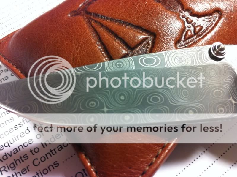

Close up of the light scratches in the etching
I had tried to reprofile the blade to 30 degrees last night to see if that made the edge bite better. It did not. For some reason everything got worse. I spent some time this morning with the fine rods at 40 degrees and it cuts paper much better now. I tend to screw up an edge when I depart from the manufactur's geometry.
However, the medium I often use to judge an edge is a .30 gun patch. I use those with some Break Free to wipe down my edc knives after sharpening. Before I put a knife away, I often run the patch over the edge and how easily it parts gives me some idea of how that edge compares to my other knives on that material. The best steel/edge on that material is my Gayle Bradley Spyderco at 30 degrees with CPM M4. The patch just pops apart if I move the patch over the edge even a fraction of a centimeter. Most knives cut right through before the patch travereses the length of the edge.
On the DT damascus, the patch slides over the length of the edge without cutting at all. It could be that the steel simply doesn't bite into cloth material unless there is some differential wear between the hard AEB-L and the soft 304. Not a big deal, but I'd like my cherished EDC favorite to impress in all respects.
Despite that, I saw a box of paper in the supply room today waiting to be opened. The boxes are secured with plastic bands. I always go out of my way to cut those bands whenever I see the boxes. The DT double stainless damascus cut through it just as well as any of my other knives (Note: the wider GB blade has trouble getting underneath the band, so it never gets a fair shot at cutting those bands. The GB remains the best cutting knife by far I've ever used.)
Having reread my post, permit me to clarify that my disappointment is that the knife is not absolutely perfect. There is a reason it remains my primary EDC. That reason is that it is beautiful, is a great design, is strong, cuts well, and I feel represents me well when seen by other "knife guys." I'd buy it again.
Edited to add: I removed most of the burr in the edge and it bites a little better, but not as well as my other knives. Could be that the AEB-L and the 304 are giving me a hard time in getting a burrless edge.

Ya, I need to retract my statement that the steel doesn't want to bite and that it won't cut those .30 cal patches. I must have had a really bad persistent burr in the edge or something. After about a month of the "issue", it's doing just fine. My bad. Apologies to everyone.
The steel is great.

Also, I'm thinking that the marks on my blade from cutting the boxes are not technically scratches because how could carbdoard be hard enough to sractch stainless steel? Perhaps they are are caused by the cardboard rubbing through the etching. I think that makes more sense.

When you bought the knife the blade was coated with GunKote, a very durable baked on finish. Over time this gets marked up a bit and wears off with even more use, then you'll see the dark oxide wear through after that. CRK can re-oxidize and re-coat for you or you can just let wear take it's course.
