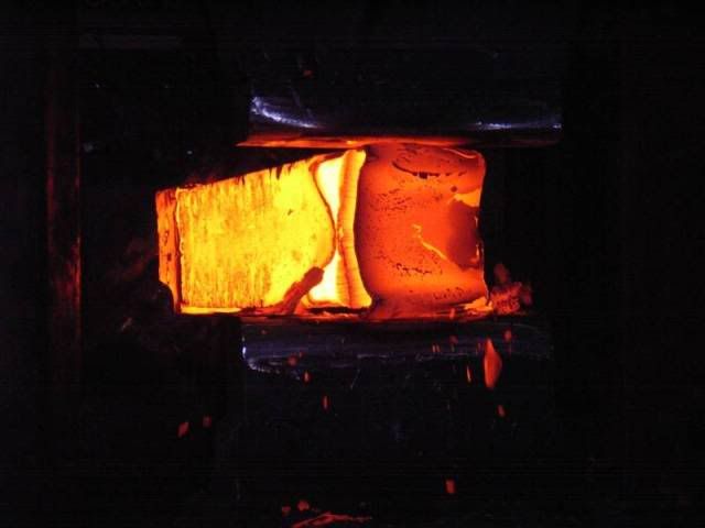

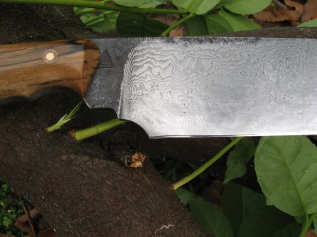

You put different steels together and forge them then you fold the blade and start again
Every time the blade will be forged again a part of the carbon disappears.

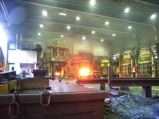

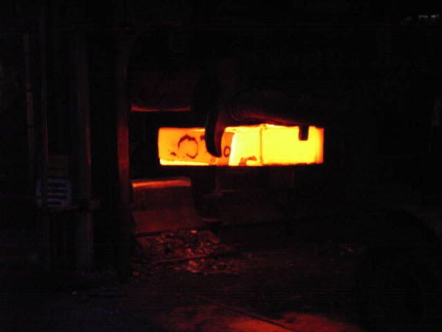

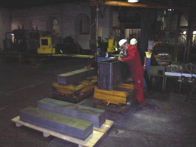

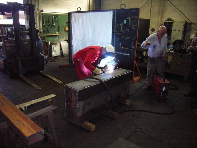

To avoid this problem Achim Wirtz decided to put all the layers together in one steel container that will be sealed

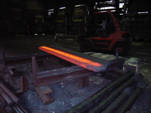

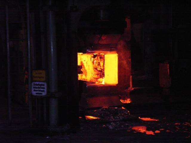

Then this "coffin" will be put in a forge and the industrial forge will hammer it together. .
This product will then be laminated
