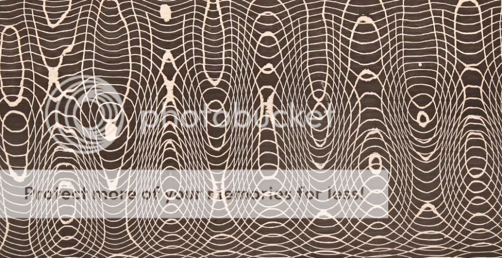

Hey all, I'm not quite sure if this will make any sense, but here we go;
recently I have fallen in love with Damascus steel, and being a noob I thought I could just search for a list of known patterns on Google (before I really understood the vastness of damascus steel makers, or even how your basic pattern is made) which launched me head first into patterns I couldn't even wrap my head around (mosaic damascus with little skulls and other highly intentional, seemingly drawn on images) and I wanted to learn how they did this, I only found a few vids on your basic damascus (the random kind, well, the watery looking pattern.)
after watching the John Neeman's "birth of a tool part 3" I was officially hooked on the stuff.
back to the point :o can you guys help compile a list (pics too) of known damascus (or wootz) patterns?
to start this off, here is my favorite pattern I've seen so far; Devin Thomas' Spirograph
I would also like any knowledge of Damascus making in general, what techniques are used to alter specific aspects of the pattern,
Thanks!

Well what we call Damascus today it totally different that Wootz...totally. Modern Damascus is an etched pattern weld of differnt steels sandwiched together in a bunch of different ways (twisted alternated with folded...you name it). Wootz is a steel that forms a visibly grainy pattern. Most experts (of which I am NOT one) believe that Wootz or something similar is what the Crusaders called Damascus. That steel was a product of India and Persia, not the modern day area of Syria. They called it Damascus because they found it there, having been traded westward from Persia and India via the Silk Road. So that very geometric pattern you illustrate is not Wootz at all but a twisted pattern weld of some sort.

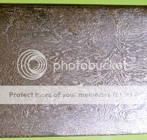

Here is a wootz steel. Obviously you can see that a lot of "modern Damascus" steel makers are going for this effect. Other go for more dramatic, artful effects like the one shown above. Here this steel has formed with this grain pattern in a single material. With modern Damascus, two or more kinds of steel are sandwiched together and then smithed in an almost infinite variety of ways to form patterns...some that look a lot like this. Roselli knives of Finland has a Wootz-like offering they call "UHC". It is very fine grained but the grain is visible to the nake eye.
