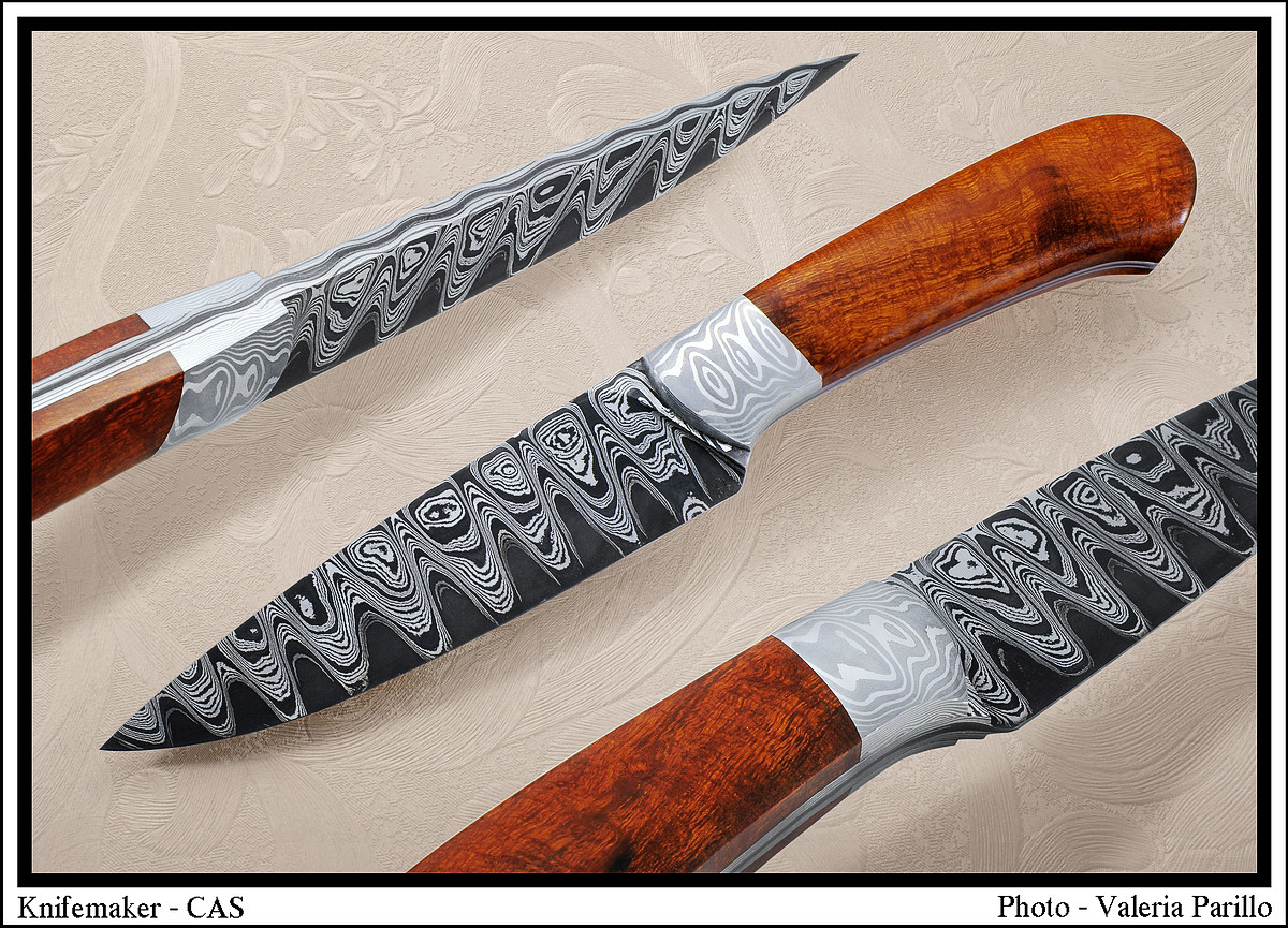

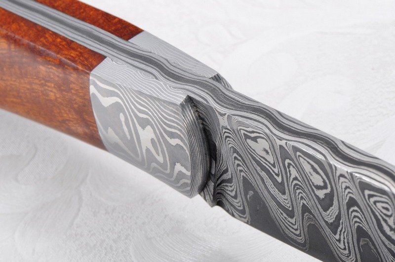

Hi guys!

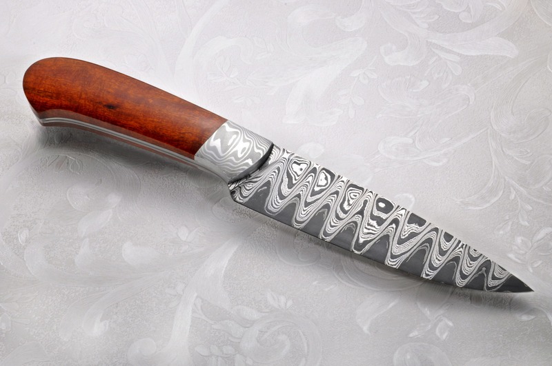

I just finished this knife made in stainless steel damask and San Mai.
The steel used on the sides were 420 and 304 and then place a nucleus of K110 (D2).
These materials have both chrome, make difficult the task, luckily I did!
The extent of the blade is 5.5 "and the total length is 10.2"

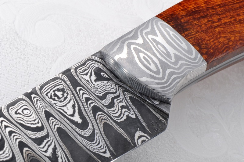

The bolster is also damask 304 and 420.

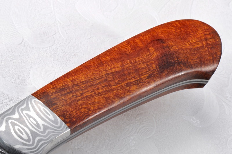

The handle is of Iron Wood.
Best Regards.
Claudio
I never get tired of looking at your designs, how could I, when they have amazing steel like this one. Outstanding as always.
Wow, that is a really nice knife. The blade is amazing and the rest of it goes along with it. Todd
The steel of the blade, particularly the top view, is exemplary. I also like how you went simple and clean on the handle to let the blade-smithing shine.
Nicely done Claudio!
