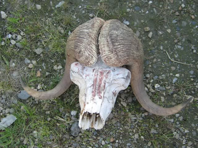

Now to my question….I've got a musk ox skull that that I had sitting around while I was trying to figure out a good use for it. Well, one of my dogs decided that he'd eat the snout portion off of it, and now I'm kind of limited as to what I can do with it. I was thinking about having knife handle material made out of the horns. I've seen it on knife handles and think it looks pretty good, and think a Nessmuk with musk ox horn handles would be awesome!
I don't know if it would be doable, or even good material for the project, but would you be interested in trying?

Only if it was cut up and stabilized first.
Horn can be a real bear to work with....it will literally warp while you are shaping it...(let alone the shrinking that could happen days/weeks/months later).
Mike at WSSI (www.stabilizedwood.com) can probably stabilize it for you if you can find someone locally to cut it into slabs.
I'd shoot for something like 5" long and 1.5" wide since it might possibly shrink during stabilizing.

Hope I didn't come across as too off-ish....
I'm ok using it for handle material...just under the proper conditions.
I've used merino horn before and the stuff drove me nuts - I ended up tossing it in the trash. It wasn't stabilized. I don't want to go through that again. :o
