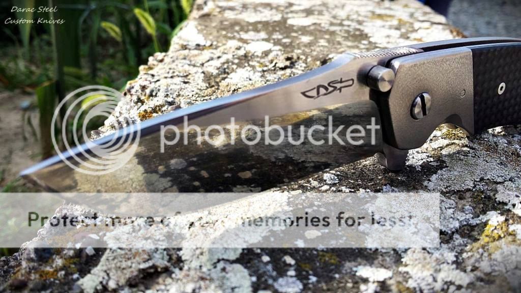

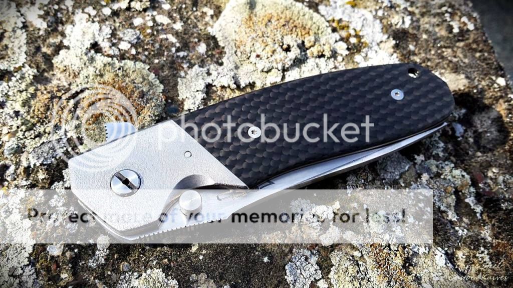

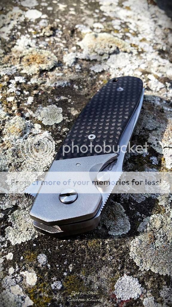

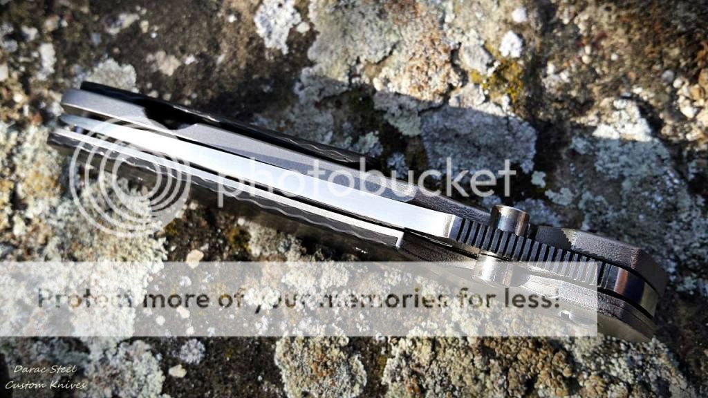

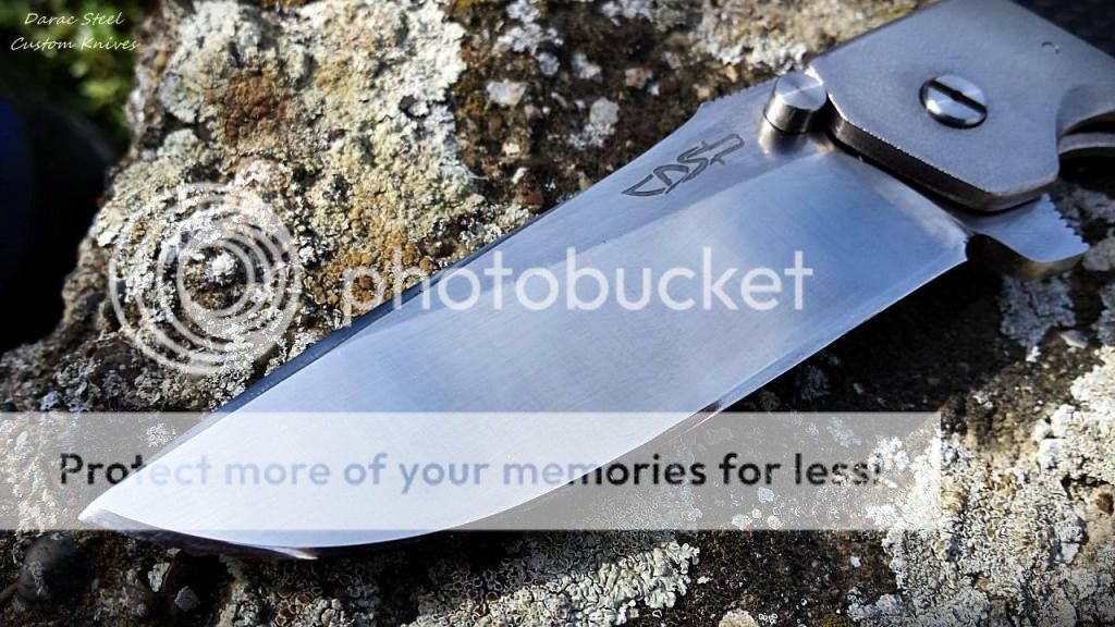

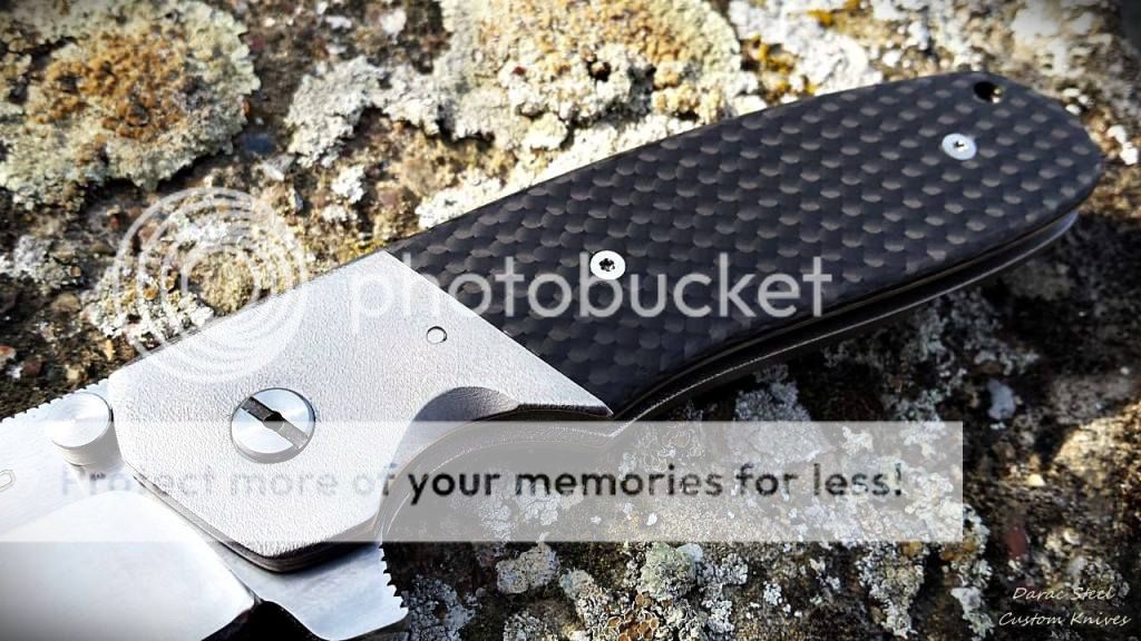

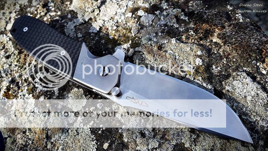

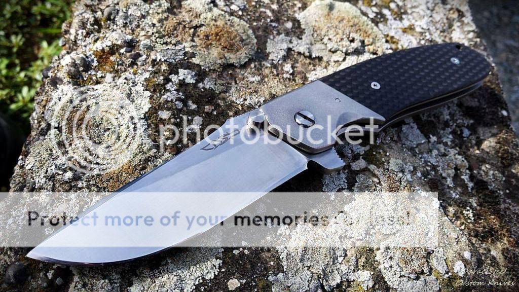

Hello guys !
Long time since I posted something, it does not mean that I'm not doing anything ...
I finally finished my flipper knife, prototype.
Why Vanquish?
The inspiration was the Aston Martin
Enough talk here is info and photos!
Blade Length - 100 mm (4") x 4 mm (0,157")
Overall length - 220mm (8,6")

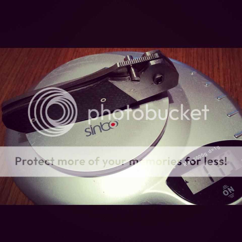

Weight - 175 grams (6,17 oz)
Blade Steel - Bohler N690Co - stainless steel
Blade Finish - hand rubbed saten and mirror finish
Slicer grind
Handle Material - Titanium
Ti bolster and carbon fiber
Carbon fiber pocket clip
Brushed finish on titanium.
SS standoffs, pivot and thumbstud...
Hope that you like it !
Regards from Croatia !

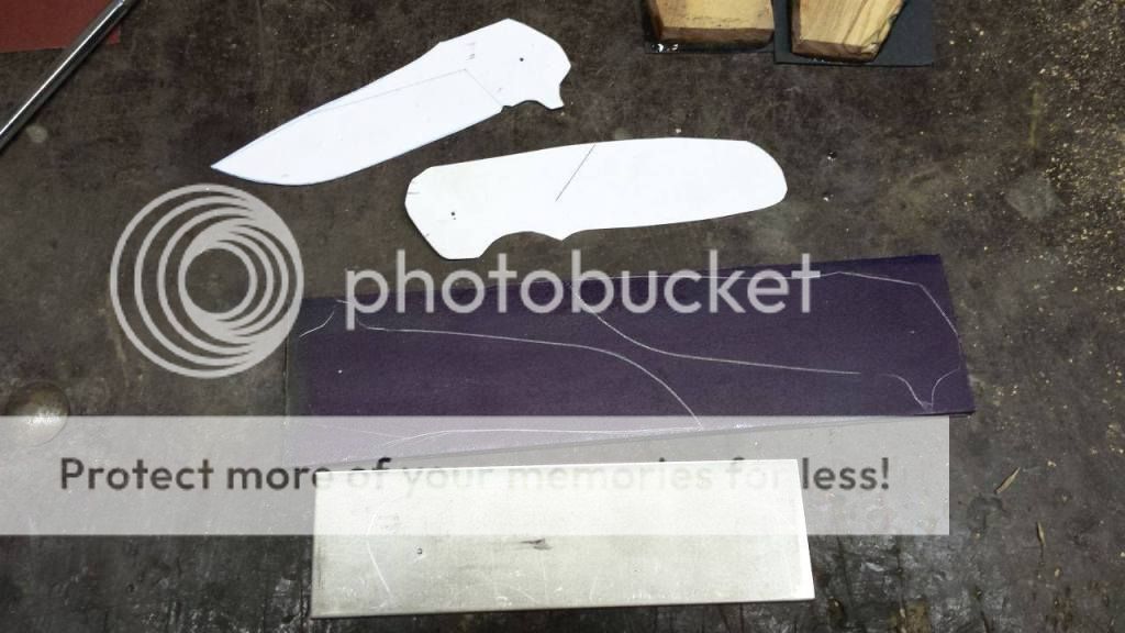

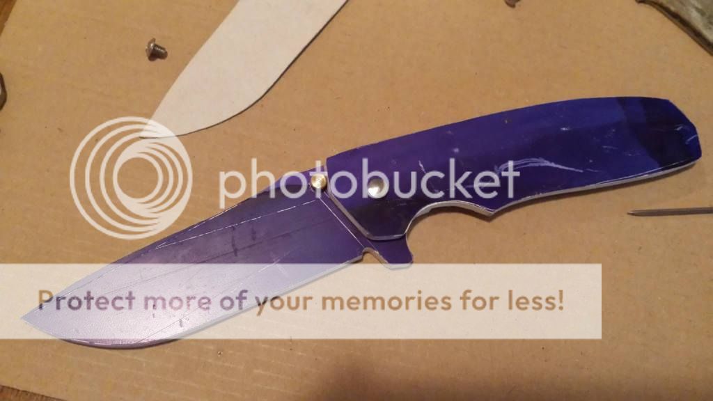

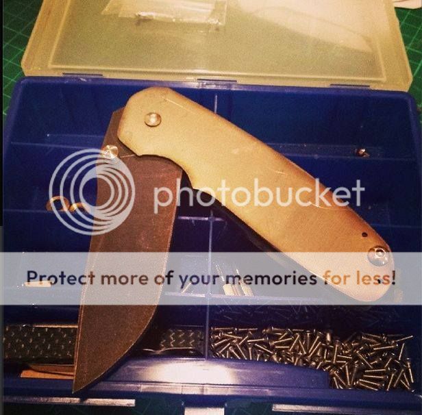

The idea started from "Croatian General" knife.
The current design has been slightly redesigned (Contractor) and that was result with folding variant (Vanquish flipper)

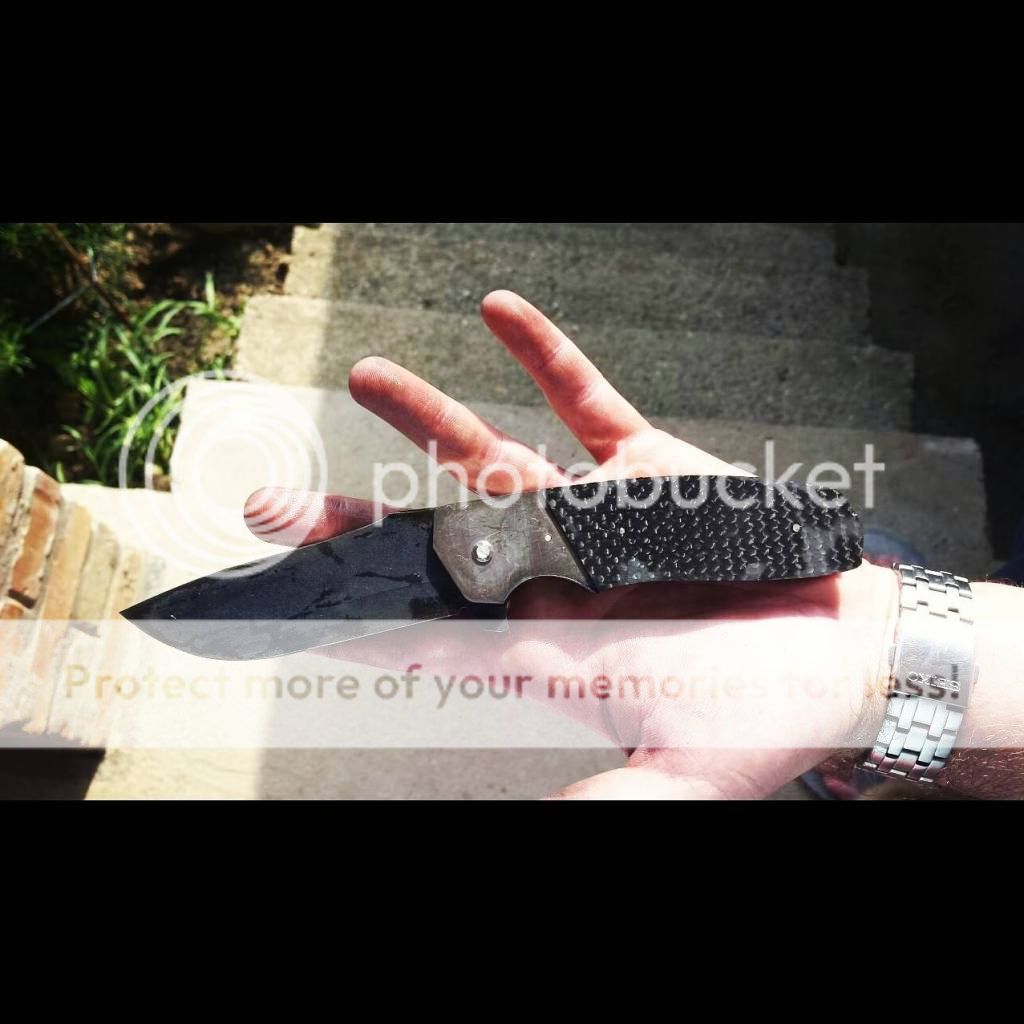

Strict labor inspection

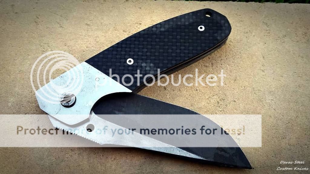

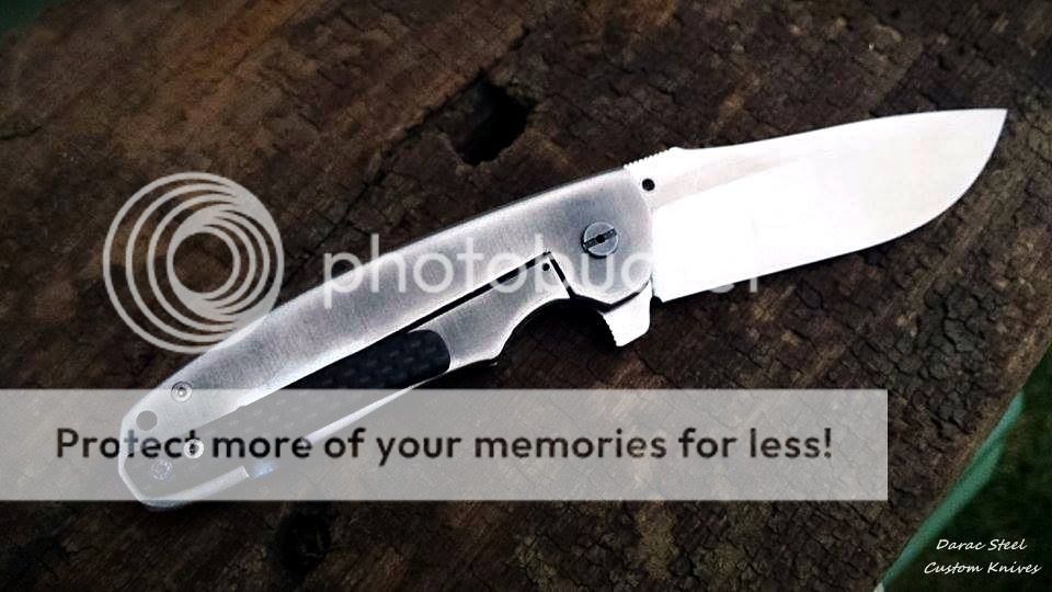

And the final photos !
